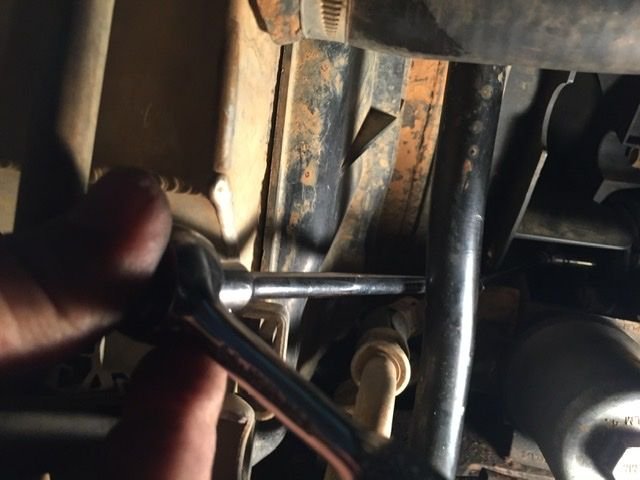

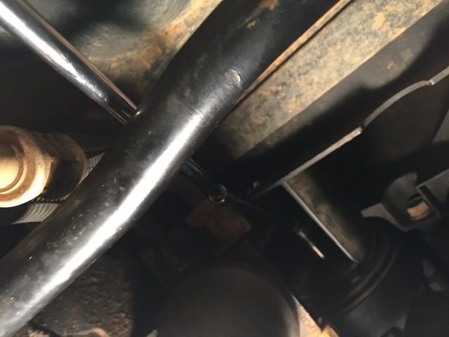

i measured my gap and came up with .053in, looks like that’s the issue. After climbing around on the truck a little, I decided to try this from the top. Just wasn’t gonna happen, no room to swing a ratchet. For sure Jack, that stator is right in the way. After climbing underneath it looked like maybe drop the trans filter bracket To get some working room. My filter has short flex lines on the in and out lines so I figured I could push it out of the way a bit without disconnecting it. Man that thing is bolted up crazy! That wasn’t happening so I got up all my 1/4 drive stuff and an 8mm socket that’s has been shortened, finally got on it with my best fine tooth ratchet and a swivel and wobbly extensions, finally found the secret combo that was just enough angle to turn the bolt, yea!

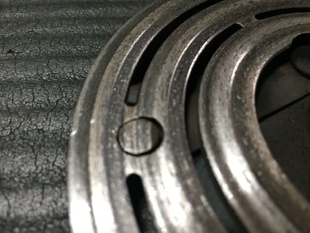

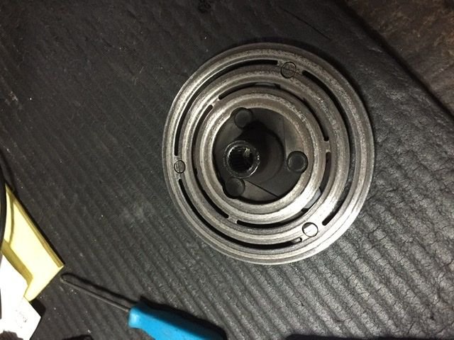

finally wiggled the front part off the splines, and found this. Are there supposed to be grooves on this piece? I’ve never inspected one before. Looks pretty rough to me.
it only had one shim/spacer in it. Measured it at .034in, so...53 gap minus 34 spacer leaves .019 gap if I leave it out, so I did.
I put it all back together with a little blue lock tire on the bolt (it looked like it had some on it already) and went for a spin around the block. Looks like it’s working well so far but I’m thinking it Specked out with no spacers because it’s wore out. Anyway, thanks once again, I wish I could smoke you guys some ribs or buy ya a beer or something. I hope postin up pictures is a little payback but it ain’t near enough!
