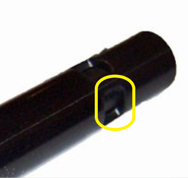

This self induced issue does not happen often, but it does happen from time to time. The last time it happened it was an FTE'r in the north, but I couldn't find the thread. I want to say it was Baatzy, but don't know for sure... He had a normal idle, but every time he got on the throttle the truck would stall or close to it. After many hours of troubleshooting, he found that the holes were not lined up enough and once he corrected that, all was well.
This image was taken directly from Diesel-O-Rings Instructions Sheets and Information page.
In the image above, you can see the multiple pieces to the stand pipe.
In the image below you can see the outer most stand pipe piece, which is the far left in the image above. I have highlighted one of the two holes in the outer most piece.
In the image below you can see the inner most stand pipe piece, which is the top right in the image above. This inner stand pipe piece fits inside the outer stand pipe piece and can become misaligned. Again, this is rare, but it does happen. If misaligned, fuel flow may be restricted.
I don't have any first hand experience with this issue because I removed the guts of the stand pipe when I rebuilt my fuel bowl a few years ago. I have seen it happen on here at least once that I can recall.

What @pirschwagon is getting at ( I think), is that some aftermarket fuel filters come with a new cap as part of the filter. And on the bottom of the cap there is a molded pin (protrusion) that opens the center of the standpipe by pushing it open as the cap is tightened down. On some aftermarket caps that pin isn't of the length to properly open the standpipe.
