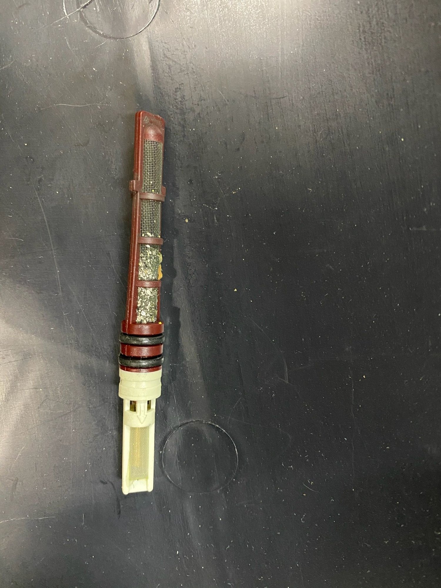

You might want to check the orifice tube/filter. I had no idea my 2005 was this bad.
