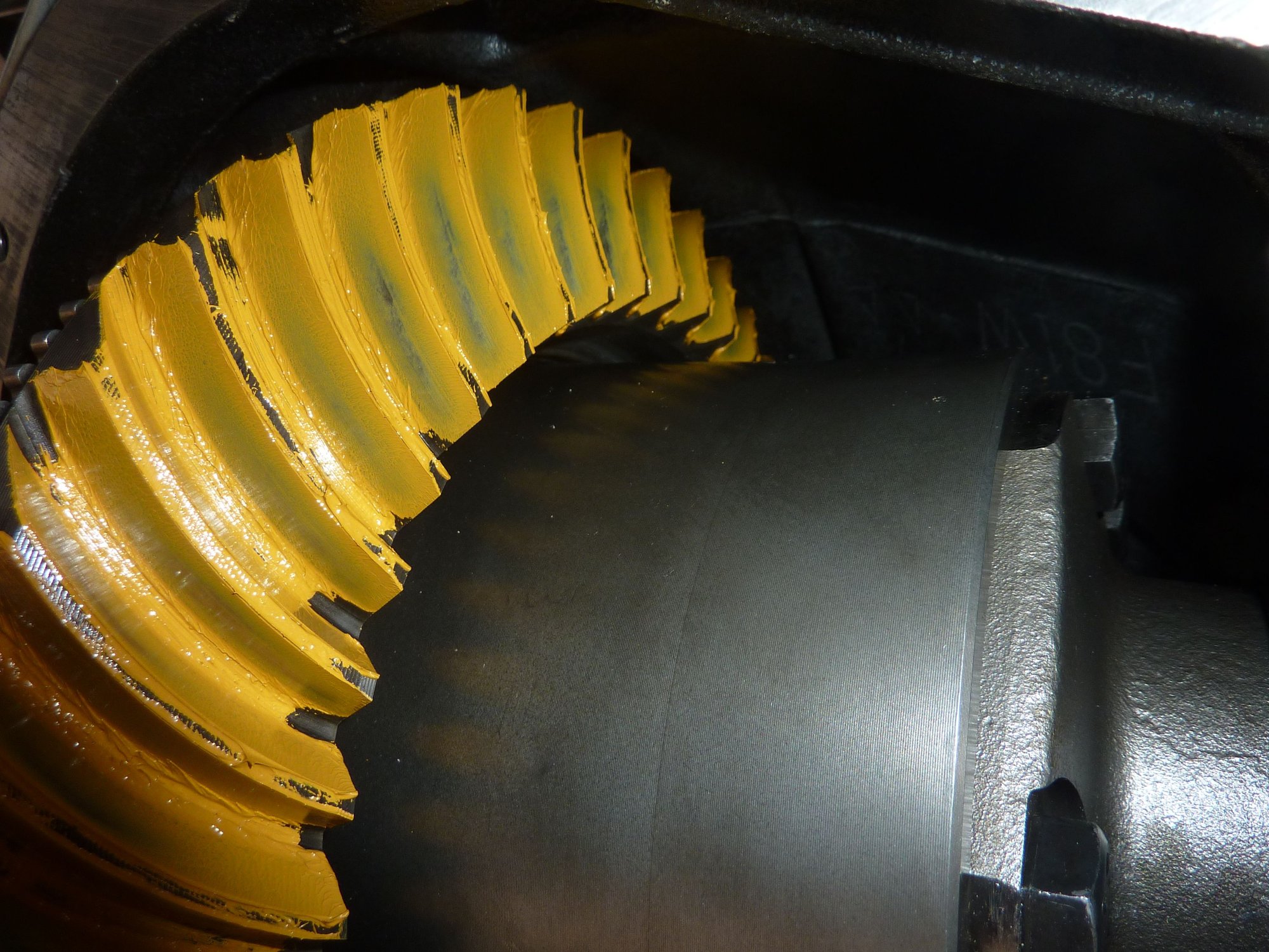

I wasn't enthusiastic as it was just another thing to take care of when I'm trying to flip this rebuild in a couple of days. While I was out running related errands, I got a tube of Ford long life grease XG-1-C at the dealership for $10. Bearings are packed, hubs are assembled and ready to go on. Considering the dark grey color, and the above conversation, it makes sense that Ford diff oil always comes out grey.
Anyway, so much for that two day rebuild. I had two shots at getting the pinion torque right and overshot both times, all while freezing my buns off. Back to the dealer tomorrow for another crush sleeve.....or two. Maybe I should take a break in the middle the torque session to warm up so I'll be more patient.

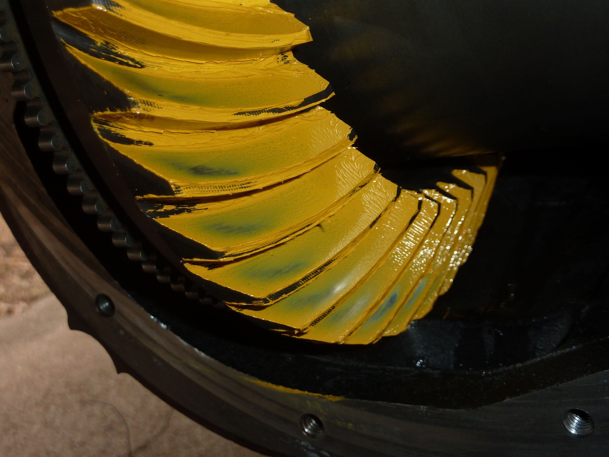

ook me two more tries to get rotational torque on the pinion correct. (right in the middle of the range at 22 in-lb) Glad I was smart enough to get two crush sleeves when I went to the dealer.
Backlash is right in the middle of the range at 0.010".
What do you guys think about the pattern?
