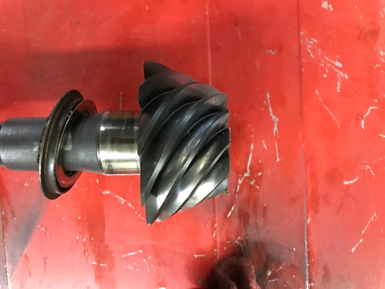

My concern about the gears is with the pinion. The flat tops of the teeth get narrower towards the smaller diameter end. I don't know if that's normal with the Ford 10.5 or not. I'll get a pic up later.

I have a not so good pinion here I can take a photo of you want.

Here is that pinion photo.
And one oily mess for your viewing pleasure.

That's what my pinion looks like. That makes me feel better. Now I can return the Yukon gear set.
Good greasy mess pic, btw. I have one of my own currently.
