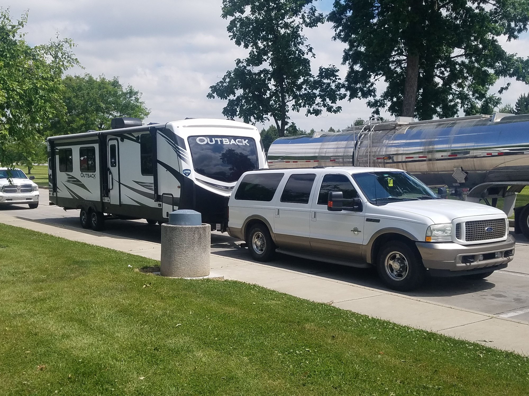

I bought this to do my backflush. It's easy to do, but time consuming. I added a air line in the system to to "hit it" with air occasionally to loosen up and of the crud in the cooler.
https://www.ebay.com/itm/392325480253
then I poured CLR into the cooler, let it sit 20 minutes, flushed, did CLR again, flushed, ran restore + in it, flushed twice, then did 4 fills of distilled, then ELC coolant. Deltas prior were 20° solo and around 28 to 30 pulling my TT, after 8° solo and 15 to 17 pulling my TT in the foothills. Flat ground I am less than 10° pulling. BTW, my TT weighs 9500 pulled by my 2003 Excursion 2wd.
