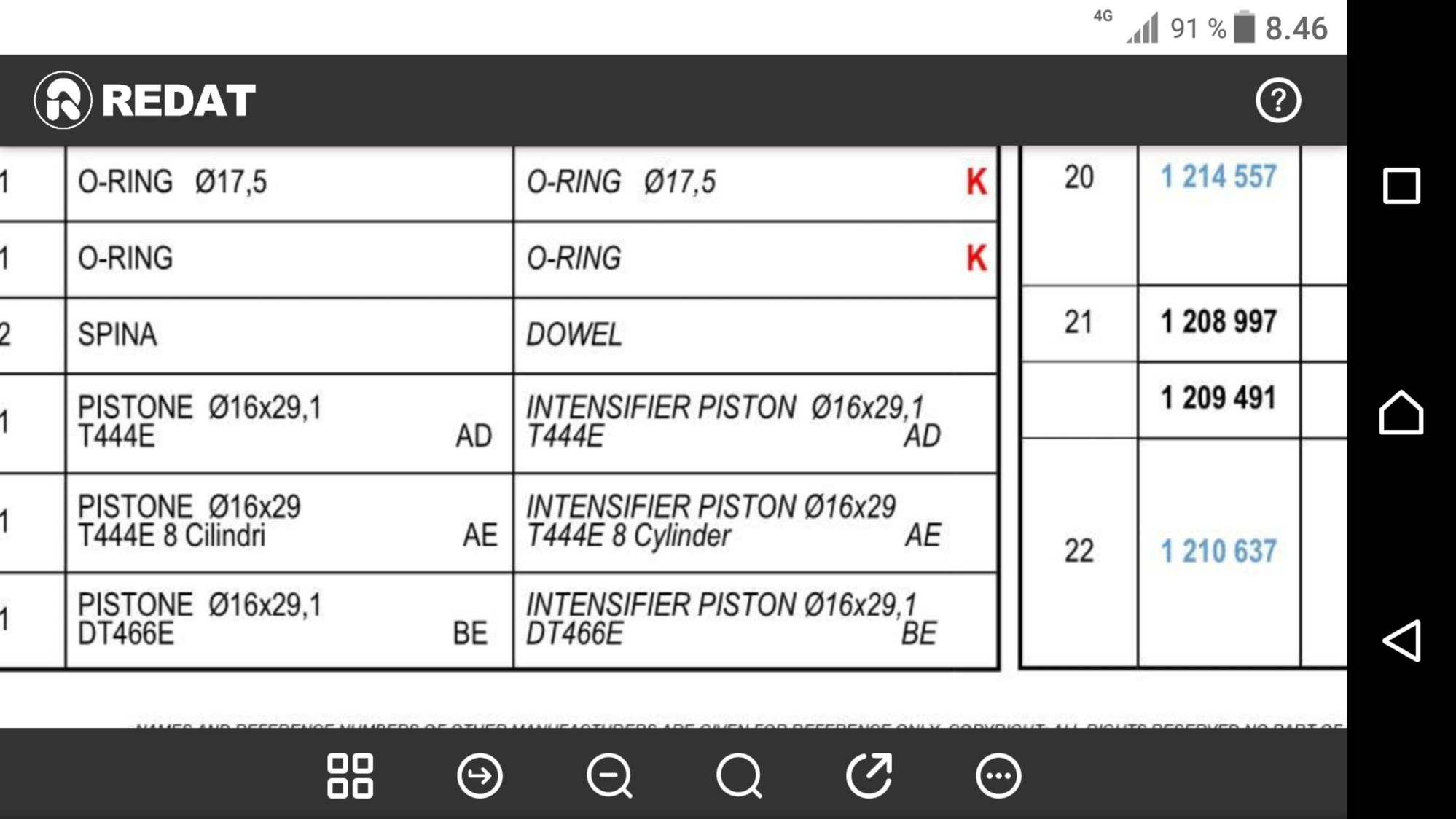

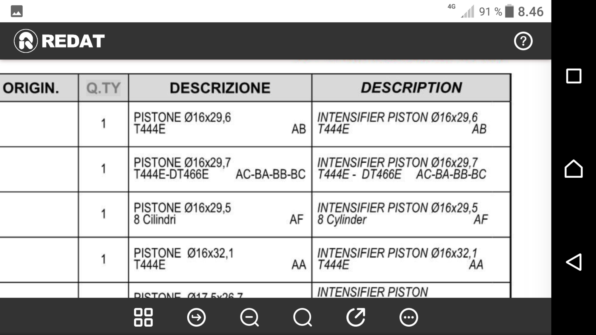

LL injectors in ADs or ABs has 0.1mm shorter intensifier piston.
If my math is correct,AE and AF injectors pushes around 3,33cc more fuel.
