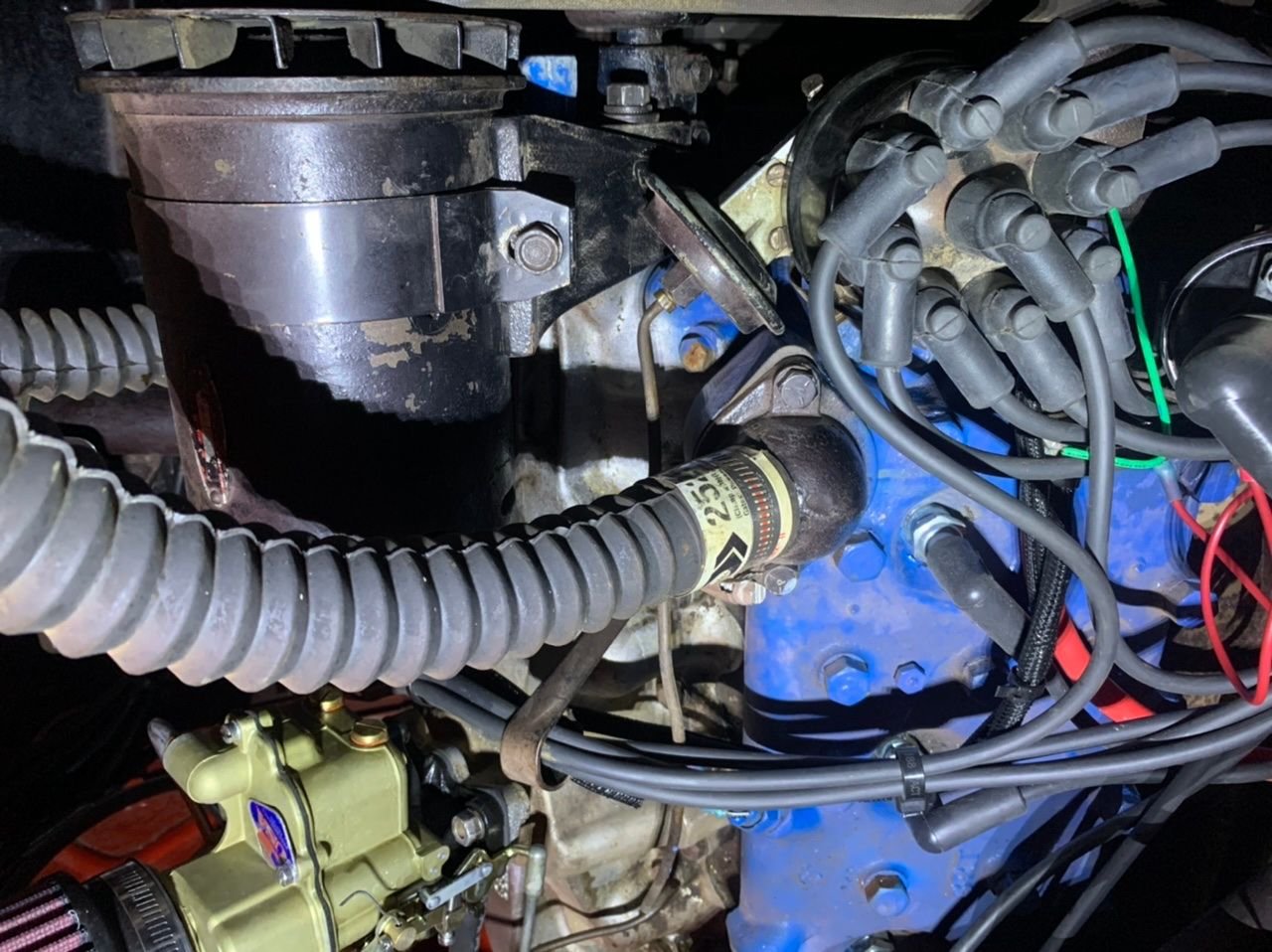

Guys,
first let me just say I’m an electrician by trade not a mechanic I’ve done what I can do to the truck but some of abilities are very limited.
1 hour of driving managed to suck down 50 litres of fuel, motor has a new Holley 94 carb, new fuel pump, new push rod, new spark plugs & wires, petronix point eliminator, new distributor cap, all new wiring, new 40,000VDC coil from petronix (flamethrower)
now, I did check the vac advance and it does it fact move with me sucking on the ridged line, I think I may have a timing issue and this is wheee my knowledge ends. If you look at the picture you can see where my distributor is positioned, using the vac advance diaphragm as a guild.

ok this is where my knowledge is limited, I’ll have to do some research on how to time a flathead, I did read somewhere 14 degrees advanced is where I need to be?
No, that would be too much by far. Disconnect and plug the vacuum line from the carburetor, at the distributor. Set the timing so the pointer on the timing cover aligns with the "Bump" on the crank pulley. That sets timing to the correct 3°. Done!
It sounds like you power valve in the carburetor is ruptured, a common occurrence.

I’m assuming I can’t just loosen the belt and move the damper to align with the Bump, but rather need to use a timing gun and move the distributor cap? Sorry I don’t have much knowledge here.

Use a timing light, rotate the distributor to align the pointer with the bump at idle.
