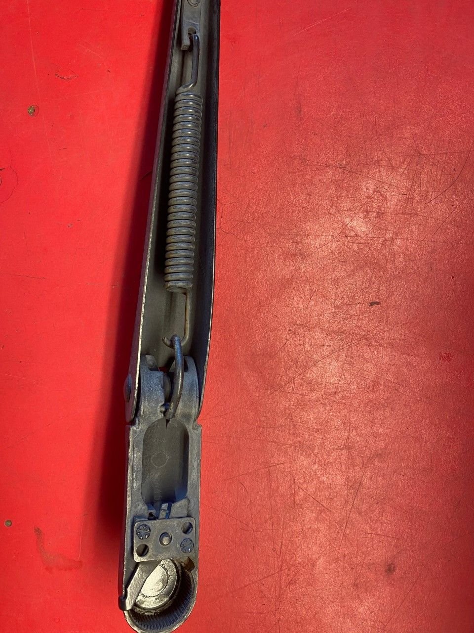

Hey guys, I thought I'd go ahead and post this up along with some information I learned along the way about wiper Blade sizing. The stock wipers iirc correctly are 20" in size, but since the 80's on my F250 I began over sizing my wiper blades and adjusting the spring tensioner on the wiper blade as well. The modification I've done here is to increase the stock wiper blade size from the 20" blade size to a 22" wiper blade size to cover more of the windshield surface area.
And lastly, being that our trucks are 17+ years old I've also removed the wiper arms and adjusted the tensioner spring to apply more down pressure as well. It merely involves removing the wiper arm, flipping it over and with a pair of channel locks, and at the base of the wiper arm squeezing the tensioner spring clip together very gently. This in turn applies slightly more down pressure to the wiper arm and improves the wipers ability to do it's job. I don't recommend doing this modification unless you've installed new wipers to avoid scratching the windshield with any debris that might be embedded in the old wipers. I've done this modification for years and have never noticed any draws backs to this modification. Using Rain Ex on both the windshield as well as conditioning the wiper blades is also very helpful.

Took some pictures of the spring clips and the sweep of the wipers on the windshield itself.
At the base of the Wiper Blade is the Spring Clip that I mentioned that can be Squeezed together to apply slightly more pressure to the Wiper Blade.

Nice pics and description of this modification. This goes on the list. Thanks Carlos!
And David...that was hilarious. Here's to original thoughts, making a great truck even better.
