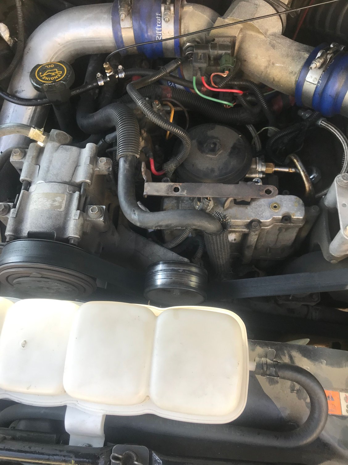

So I followed the CPS wire up and it joins the wires for the HPOP and EBPV tube. About 2” past this conjecture, there was a area that was already taped from the previous owner. On the underside of this tape was one of the bolts for the large aluminum cover that covers the injectors etc. it’s seems like the top of this bolt had rubbed all the way through this tape and the wiring. I retaped all of it (white electrical), and also used some zip ties to pull it up and off of the cover/bolt.
I’m hoping this will do it. I should know in the next few weeks if it cuts out again.
if it does it will be quite a day of disconnecting it all, pulling the entire CPS wire last up and accessing all of them to check for breaks. I attempted to do this today but it will require me removing the AC pulley among other thing to be able to pull the entire wire up and get to it
