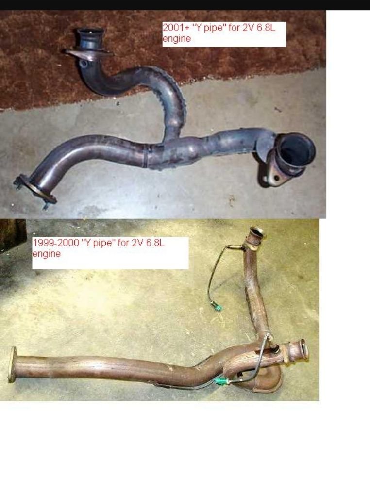

I did find a loose heat shield on that terrible looking y-shaped exhaust. The lower side is loose. Who designed that exhaust?

Do you have the bottom Y pipe if so that can be where the noise is coming from. I had 2 2000 V10s one was a early production and one was very late almost a 2001. I had a simular noise in my late production 2000 and after complaining to Ford they came up with a fix and it was the top Y pipe and with a different intermediate pipe and a upgraded tune. The truck never made that noise after that, the early 2001 trucks also had the same noise so the Y pipe change came latter on in the year. I can't swear to it but the problem started after they changed to PI heads (Preformace improved). My early V10 didn't have them but the late producion did. They called it a resonant sound in the Y pipe.

I have that bottom y-pipe. The top one looks like it would be much better performance wise. This is a 12/99 truck.
