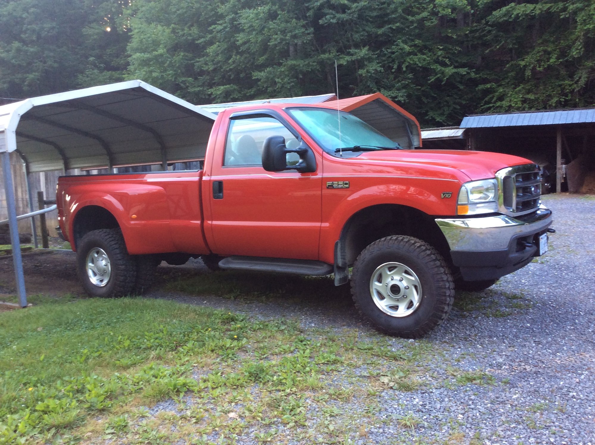

Old Jun 9, 2020 | 06:07 PM
hodge5's Avatar
hodge5
Joined: Aug 2014
Posts: 546
Likes: 30
From: VA- Shenandoah Valley
I had a 2" Rough Country level lift installed, today. This would be the budget one, the short stack of springs. The truck looks fantastic, rides the same, and it did not require an adjustable track bar.

Old Jun 10, 2020 | 03:56 PM
krewat's Avatar
krewat
FTE Leadership Emeritus
Joined: Jul 2002
Posts: 42,561
Likes: 423
From: Long Island USA
I only ever saw one DRW V10 around here on Long Island, and that was probably 17+ years ago...
Nicely done.

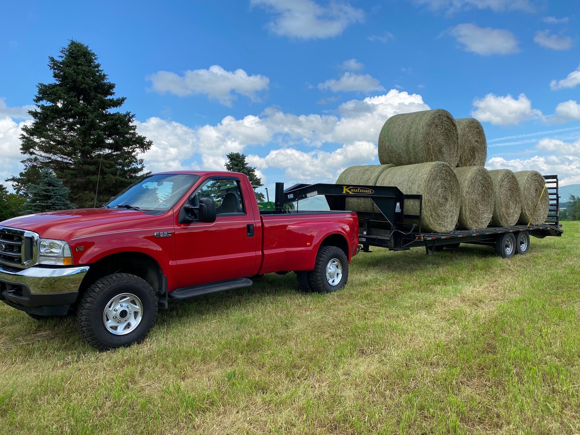

Old Jul 26, 2020 | 12:46 AM
david crumrine's Avatar
david crumrine
Joined: Jul 2020
Posts: 2
Originally Posted by hodge5
Previous 04, 59,000 miles
Current 04, 37,000 miles
Right there is why the ride hights are different in the front and back between the 2 trucks. One is a SRW and the other is a DRW. DRW are made with more of a rake than SRW cause they can handle more weight if I remember correctly from a video I watched on YouTube about the difference between a SRW and a DRW.
