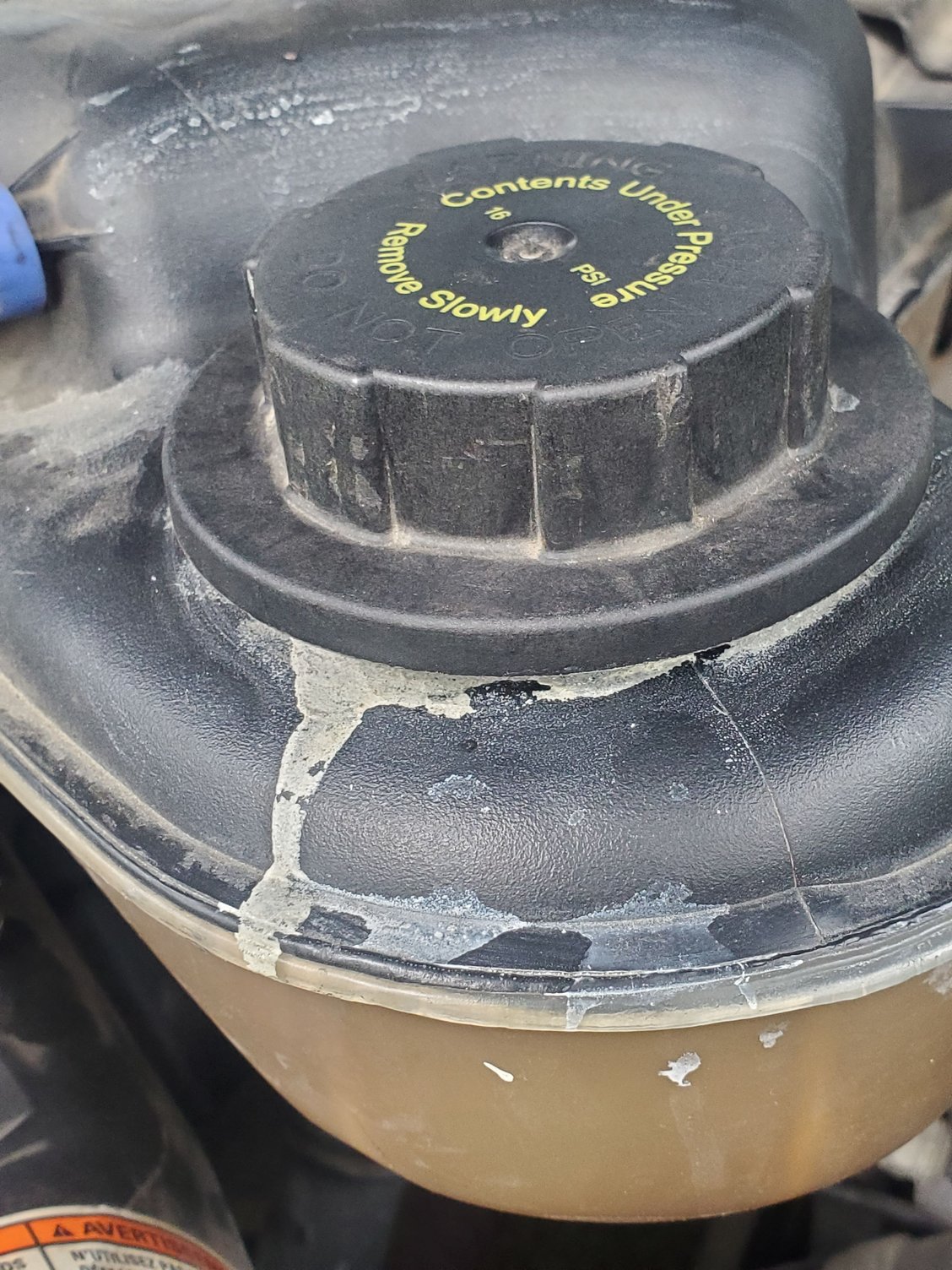

Just noticed white powder residue around the cap. Does this typically mean head gasket issue?
Old Jul 25, 2020 | 10:01 AM
bismic's Avatar
bismic
Joined: Nov 2003
Posts: 27,893
Likes: 3,611
It might. It might be a weak cap also

Thanks Bismic! Also going over this further I see see residue around the coolant filter. SeI See pic. I didnt think there was a leak but this would indicate a leak at the filter, correct?
Old Jul 25, 2020 | 10:35 AM
bismic's Avatar
bismic
Joined: Nov 2003
Posts: 27,893
Likes: 3,611
Could be. In fact there are quite a few places where you could get a drip when the engine was hot and not notice it readily. That is why I always do a pressure test first.
I have a 20 psi cap, so I can test at a little higher pressure, but I don't think I would do that with a stock radiator (mine is one from BPD). IMO, 15-16 psi is the max you want to put on the system with the original radiator.
