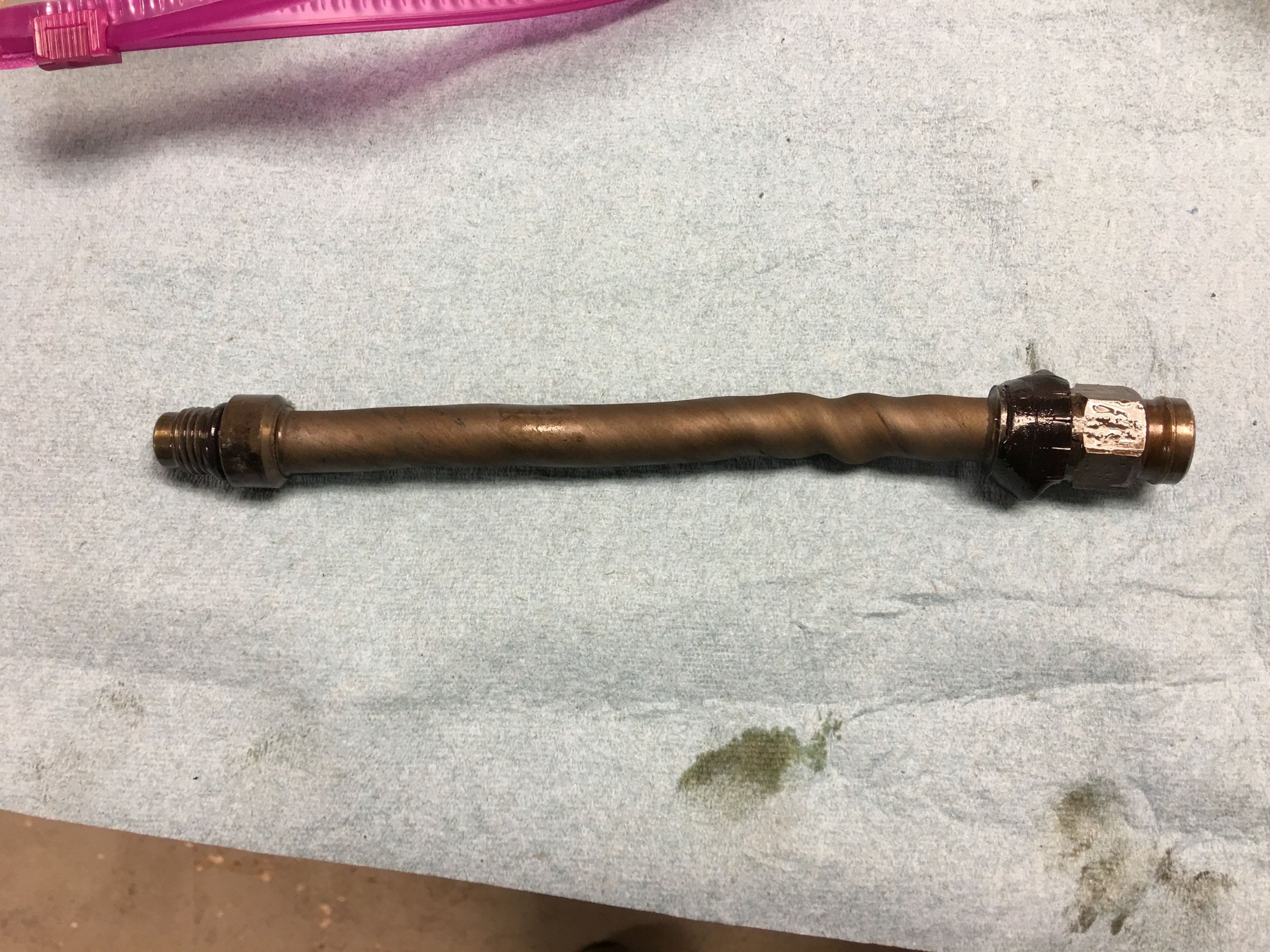

So, just for ****s and grins, I tried a 1/2" extension. Fit perfectly and the standpipe is out. (I need new glasses) The hole is square, not hex like the dummy plug. However the standpipe is in two pieces. This is the first one I've ever taken out, but all the pictures I have seen led me to believe the standpipe would be one piece. Below is a picture. Do I have an upgraded standpipe, a stock standpipe or an aftermarket standpipe?

looks stock 2004 and earlier... now I'm starting to understand what Jack and Mark limit the number of replies they make to people....

I'm just cranky.
The 2003 versions are not like that.
And typically come out like this.
