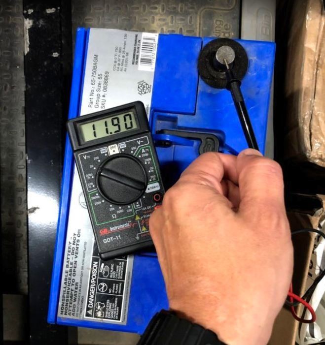

1995 F-150 Flareside with the 4.9L. Been working through a starting issues over the past couple of days. Found that my battery was running down over night.
Yesterday it turned over slowly, but still started. I checked the voltage at the battery with the engine running and it measured 14.3V, so seems to be charging OK. I turned on all the accessories I could and it only dropped to ~ 14.25V.
Battery was dead again this morning, so I pulled it and put on the charger. Charger showed it was fully charged after a couple hours. I took a voltage reading ~ 11:20 am.
Here is the second reading 2 hours later.
Is this battery toast? It's roughly 2.5 years old. I took it to Pep Boys where I purchased it earlier this week and they put it on their tester. They said it was showing ~ 900 CCA (it's rated at 750 CCA if I remember correctly). So they said it was good to go and handed it back to me.
Just wondering what to do at this point. I think it is still covered under at least a partial warranty. Thanks in advance.

Was it hooked up to the truck from when it was charged at 12.60 and then dropped to 11.90?

I almost did that, but then thought I would pull it out in case there was a draw on it from the truck. So it was on the bench during charging and when I took the readings.

Willing to bet Pepboys didn't select AGM on the battery tester. An AGM battery is charged at capacity at 12.85v not 12.6v like a flooded battery. The battery needs to be tested again, its most likely a failed battery.
Appreciate that, should I take it in as is? Last time I took it to them, I think it was closer to a full charge.

Your battery is no good if it settles to under 12 volts just by sitting for a few hours.

Took the battery back to Pep Boys this morning. They put it on there charger and were able to see how quickly the voltage dropped following a full charge and gave me a replacement.
If you have any aftermarket amps, radios, etc. they are common causes of excessive parasitic drain. Use a clamp on current probe if you have one or install your meter set to amps inline between the negative battery terminal and the the negative cable. I believe the current draw should be less than 50 mA. Whatever you do...do not try to start the engine, you will blow the internal fuse on your meter.
I made sure there was nothing on and tried this test. My multimeter showed 0.07 on the 10A scale. I might try and see if I can get it lower, but that doesn't seem too bad.
