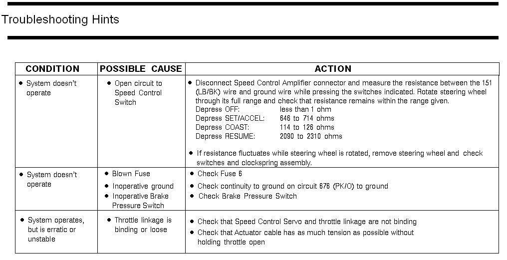

Has the Speed Control recall been done on this truck? If not...STOP right now after you unplug the connector to the Brake Pressure Switch (BPS), It's a fire hazard.
If the recall has been completed then use this guide to verify the inputs are good. Good inputs...and still not working means you have a bad amplifier.

So it was my brake pressure wiring harness. It was rotten. I was going to take a real good look at it and as soon as I touched it it fell a part. I put new ends on and I had cruise again! I hope this helps some one els down the line.
