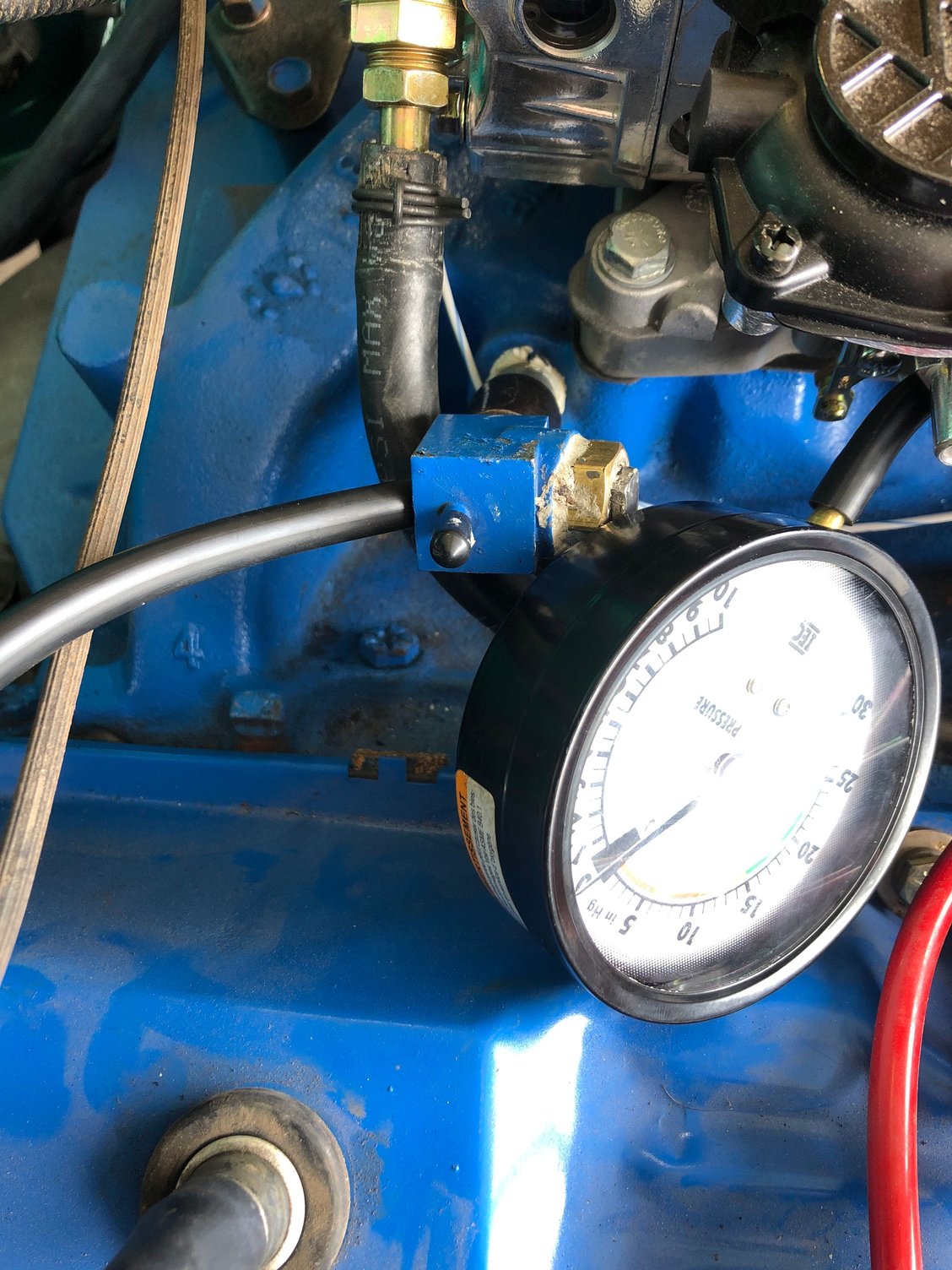

Originally Posted by dwirth
Hit a milestone on Saturday. Fired the ol 428 up after being rebuilt 12 years ago in my 76 F-250. Fired right off so huge relief to know all my wiring was correct. Ran really good and good oil pressure. I’m having trouble keeping it idling tho. I’m suspect of a vacuum leak but can’t find anything externally. Running a brand new Holley 670 avenger carb.
vacuum port on carb is giving 20+ revved up to 3000 rpm. Getting 5-10 on port on the actual intake manifold. I did not plug the vacuum advance hose off dizzy when I was timing it if that matters. It seemed to smooth out by holding a rag over top of carb to kill the air. I’m not super sure my timing is optimal either. I think it’s a little too much. Around 18 degrees
forgive my ignorance because I’m a super newbie when it comes to these kind of things. I think I’m close just not perfect on it
shooting for 800 idle, correct me if I’m wrong. Has auto tranny.
Anyone point me in the right direction on troubleshooting? I haven’t had a whole lot of time because of farming but I piddle with it at night. Thing sounds like a beast. All the gauges are even working. What more could a guy want!😝

Is that 17'' at 800rpms and connected to ported vacuum ?
Thank you for the photos.
I don't see the point of having a Tee to the front of the intake manifold.
The rear has a PCV valve, and the front doesn't.
My logic tells me that one pipe suffices, at the rear.
1Ton made a good point back in post 36, please refer to it.
getting that 17 on gauge at rear of intake manifo

My question was crap !!
I should have said, was the reading of 17'' at 800 rpms with the dizzy connected to ported ?
Yes dizzy hooked to ported at an idle

When you hook the dizzy up to full manifold vacuum, and keep the rpms at 800, and take a vacuum reading, let us know if that reading makes you smile.
I keep saying do this and do that at a constant 800rpms because otherwise the readings would not be very helpful.
During the final dialling in of everything, when you get to it, you can change the 800 rpms to whatever you want, or you can leave it there.
So far the numbers are telling you that you have a good strong engine.
