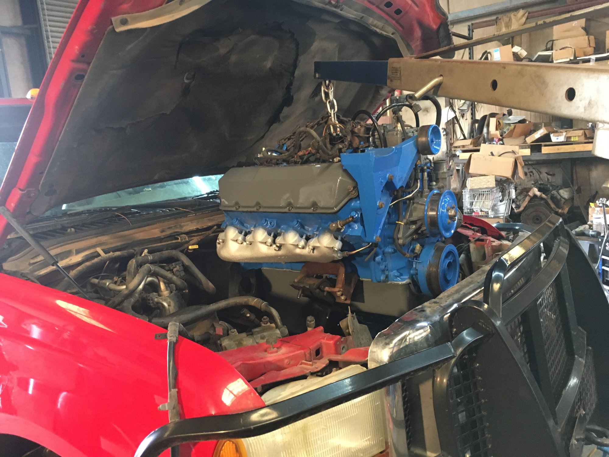

Engines getting pulled today. Going to check cyclinders thurs if not to bad itll get overhauled. probably going to do the Motorcraft oem with arp studs etc unless there's a better one to do. Any recommendations on air filter box.. also any other recommendations on parts I should swap out or add? such as gauges etc.. Thanks
