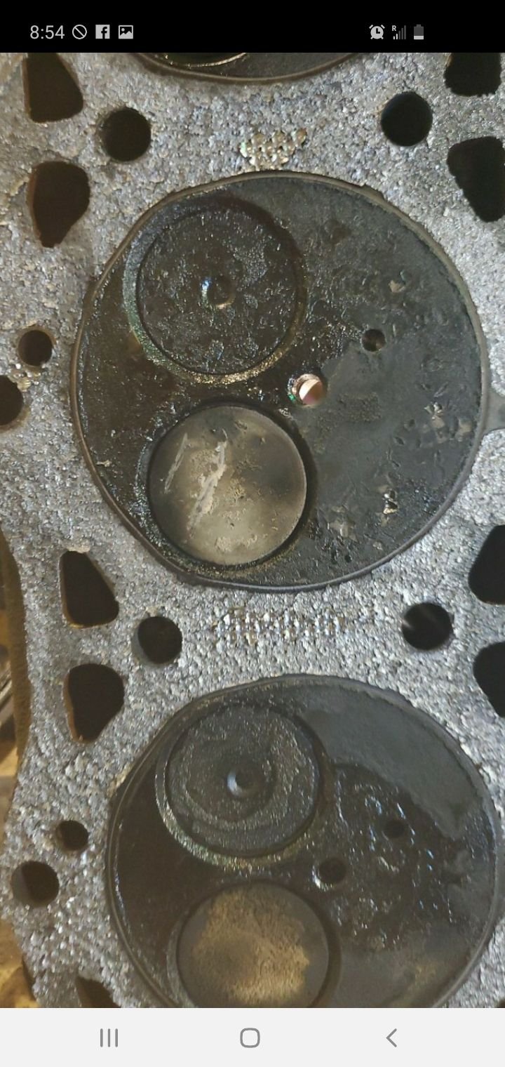

just a quick update. Got the top end tore apart. Obviously damage on #5 piston. The 7th piston is fine looking but head area is pretty rough.
Would you guys get the head machined or just get a reman? If I get it machined, will they have to machine the block as well or can I have them pull sleeves etc and put the standard oem back in?
also whats best way to check bore?
This was the 5th piston/cyclinder. Id say it had a issue.
Head view from the 5 7 area. The overheat on the head wasn't broke so the head didn't get overheated. No idea what caused the piston to break up.

That looks like a broke off glow plug still in the head?
yeah it is . And the head valves are pretty sunk in. I'll probably go grab a used or remanned one and get it stress tested etc (if used)
