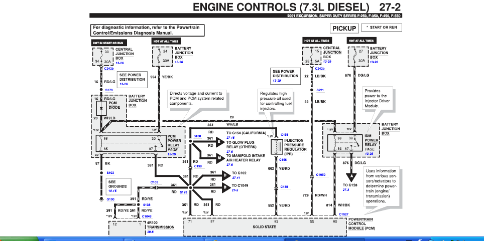

Items I’ve checked so far:
-Batteries are good
-Starter is good
-Engine turns over rapidly, but no start
-No signal to GPR to turn on
-No fuel pressure
-No WTS light
-Pulled and tested every fuse under dash, all good
-Pulled and tested every fuse under hood, all good
-Fuse 22 (junction box batt feed) under hood has power coming in to it
-Fuse 19 (fuel pump motor, PCM) under hood has power coming in to it
-Fuse 24 (PCM power) under hood has power coming in to it
-PCM diode checks out good
-Bench tested relay 30 (PCM power) tested good for coil activation and continuity
-Swapped PCM relay (just in case) with blower motor relay and still same symptoms
-Disconnected fuel bowl heater plug, same symptoms
-With key off I have power at pin 30 for the relay (normal)
-With key on I have power at pin 86 for the relay (coil activation)
-When my wife turns the key on, the PCM relay activates
-Checked DPtuner chip for looseness, reinstalled PCM, same symptoms (also Tuner switch doesn’t light like normal when key is on)
-Pulled chip from PCM, reinstalled PCM, same symptoms
-Researched PCM pinouts, checked for voltage at PCM pin 55 (always hot) it’s good
-Checked voltage at PCM pins 97 and 71 with key on, it’s good
-Checked pin 24 of 42-pin connector for power with key on, its good
My conclusion, unless anyone has any other ideas, is the PCM crapped the bed. Who knows why. Maybe the DP tuner wiggled a little and shorted something or maybe it was just it’s time to die.
