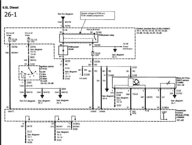

Got to solve the no wait to start and no Glow plug activation. attached is diagram showing power to PCM and GP relay. Look at the right side of the PCM power relay. Should be providing power out to PCM and GP relay and many other items via 361 RD. See if you can locate and verify if getting power on this leg.

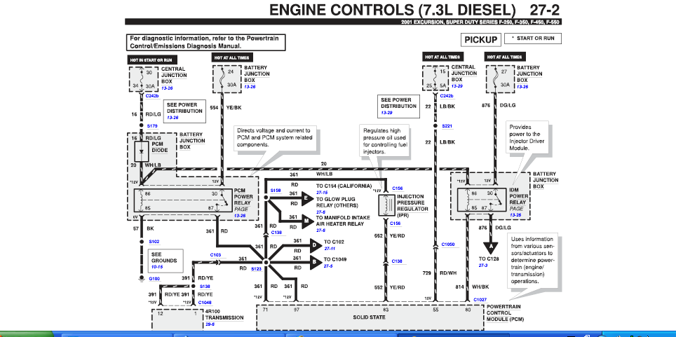

also found these which show that the fuel pump relay gets a ground from the PCM so if it is not powered the fuel pump won't get a signal to energize

Just check the GPR. I have power from the battery, and with the key on I have power on both small wires, but no power to the larger wire opposite the one that is constant hot. I’m assuming bad GPR. I wouldn’t think this would cause my fuel pump to not run but maybe. Gonna see if I can source a GPR locally.
I get power at pin 97 with the key on so I’m assuming the relay is working correctly.
what about pin 71. Maybe splice s123 is suspect

No power to the fuel pump when check at the pump with multimeter and key one. Checked in and out at power distro box and all is good. Back to the schematics. I assume it runs through the PCM but not sure.

See post 32. fuel pump is definitely controlled by PCM
