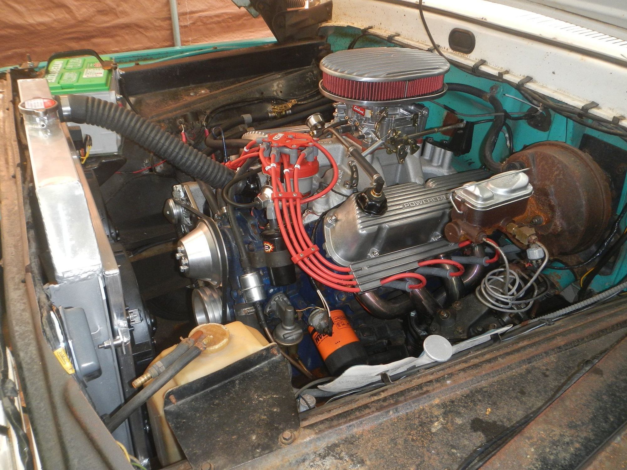

Decided to switch back to the stock exhaust on the 65 with the 302 which currently has Hooker Longtube headers with an Edlebrock 4dbbl with Holley 4160 and I have never been able to get into the secondary vacuum and the max rpm I am able to gain is approx 3500. I found that on the passenger side the clearance is very limited and does not take much of a bounce for the pipe to hit the crossmember, on the driver side I did not have an issue with clearance but seem to recall the 351W heads it sets a bit higher(?).
Aware the addition of headers is suppose to increase HP and perhaps and improve airflow but IMHO, it is a truck with limitations; T18 trans and 3.57 rear axle ratio and limited RPM. Anyhow, had an urge to chime-in? Expect to get some flack from 'nay-sayers:
