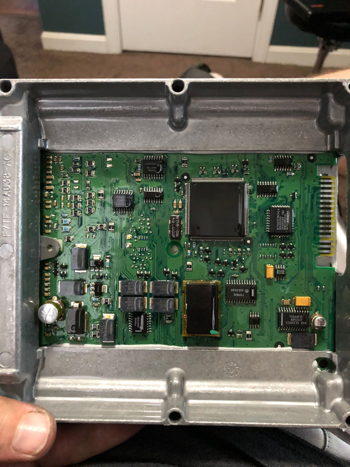

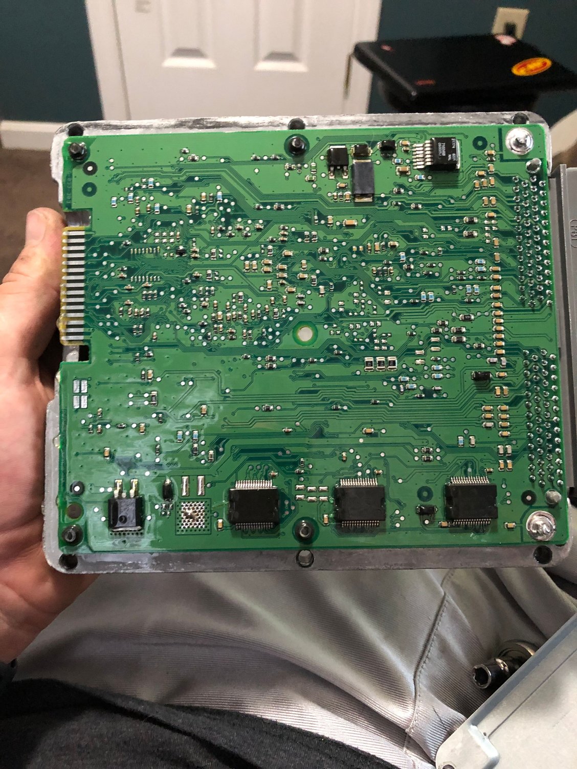

This morning I took the PCM out. I will post some pics but I didnt really see anything out of the ordinary when is comes to boards. No burn spots, no chip installed, looks clean. There did appear to be some moisture in the pins, and a small area that looks like a burn, but i cleaned it out with electronic cleaner. Installed the PCM back in, checked the harnesses down where the PCM plugs in at the firewall. Put batteries back in and attempted to start, still crank no start. I want to add that the batteries were both in my garage getting charged overnight, the codes still pop up before I tried to crank. Could that be another sign that the PCM is bad?

Gotta get that PCM. I don't think it's the CPS. Those 4 codes together are unusual enough to try that next.
