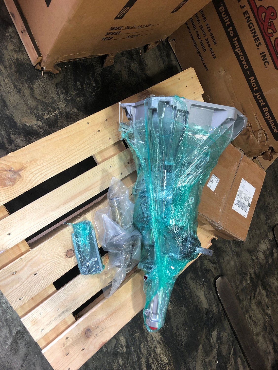

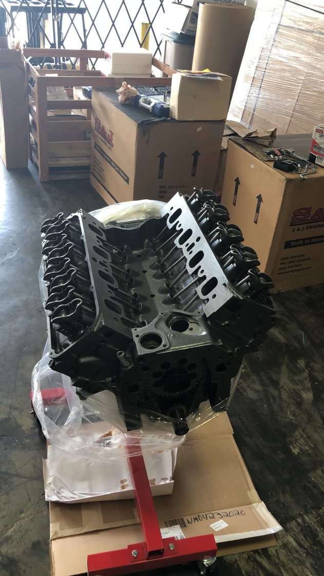

351C long block
T5 transmission

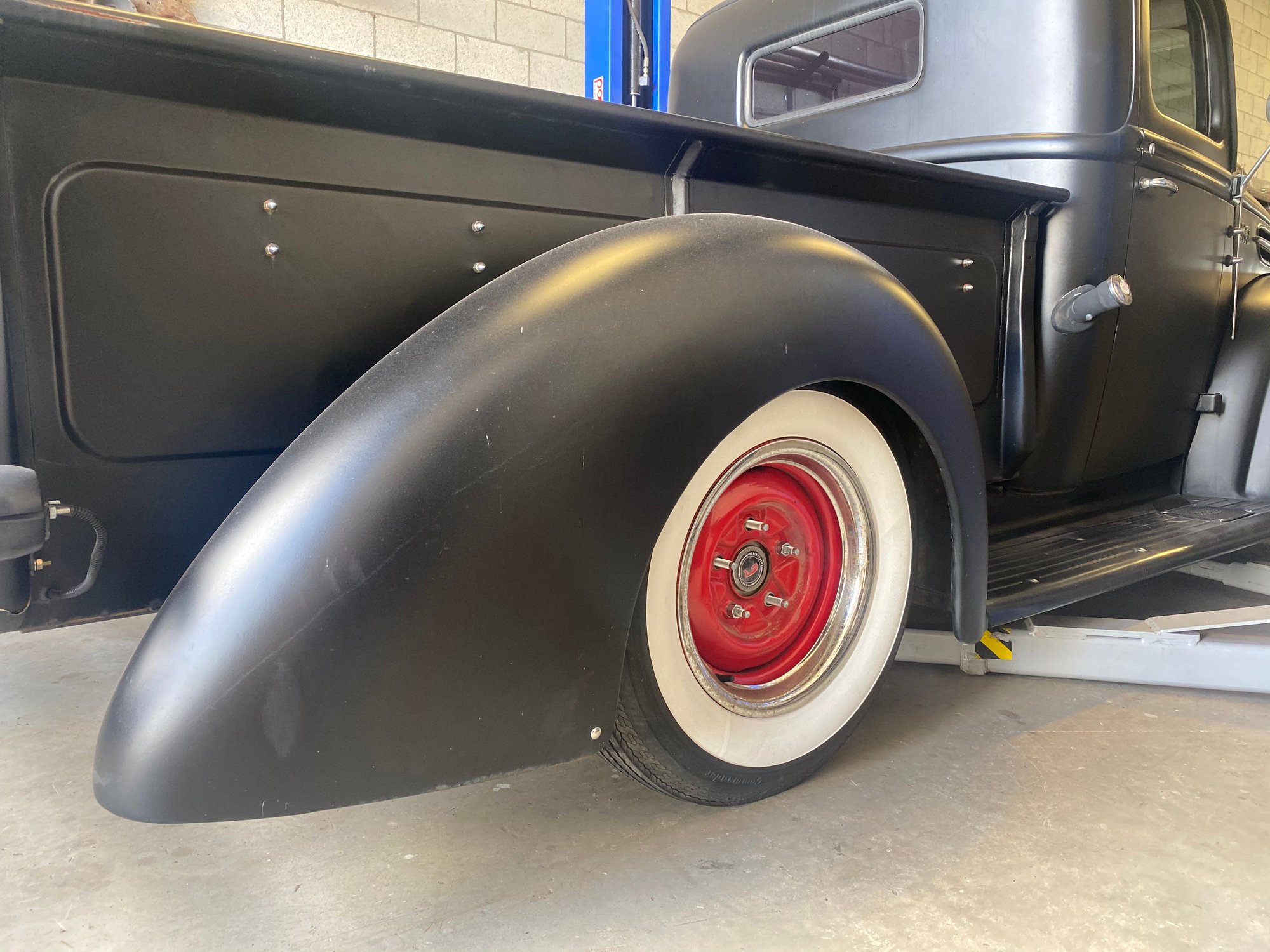

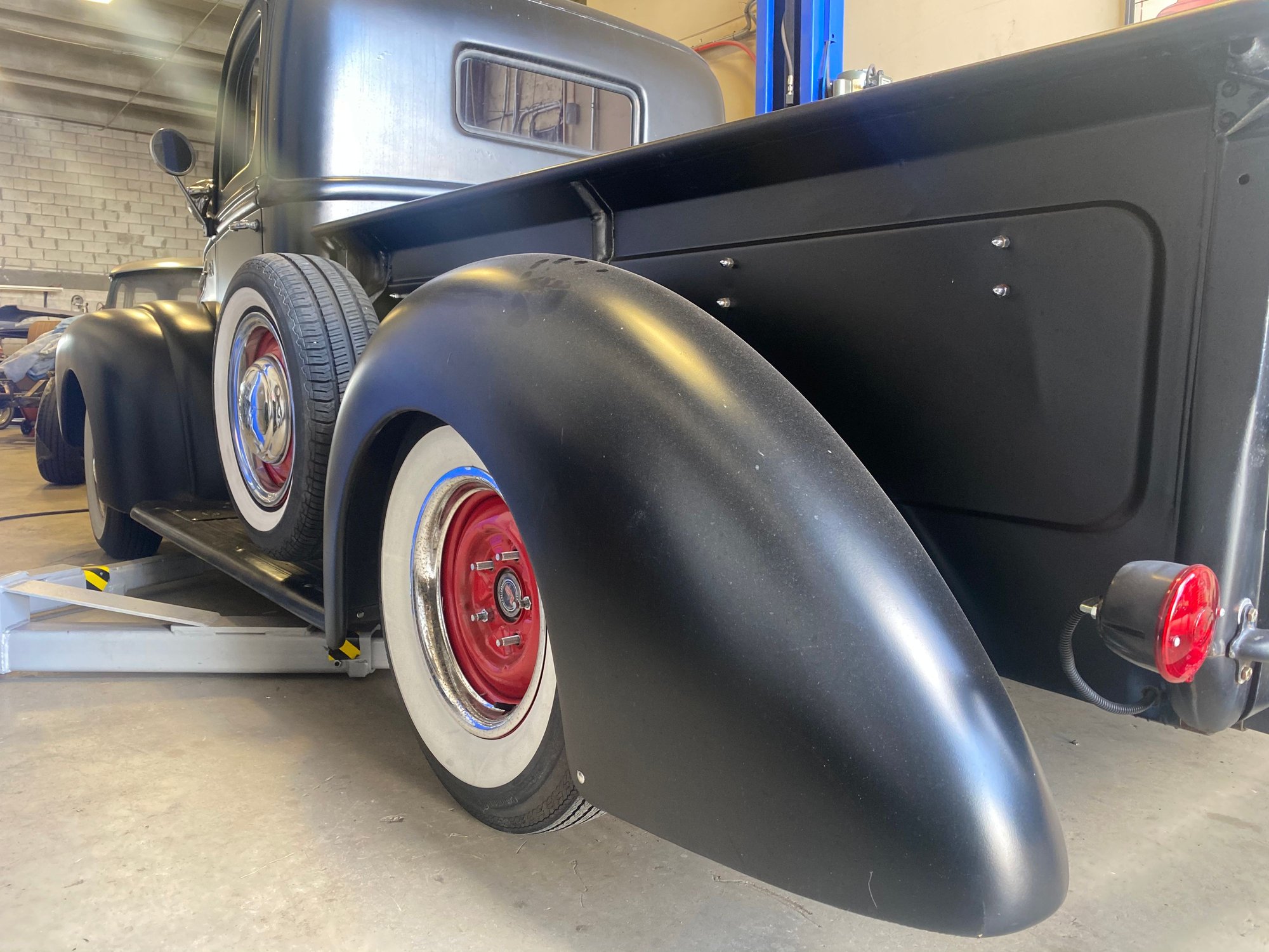

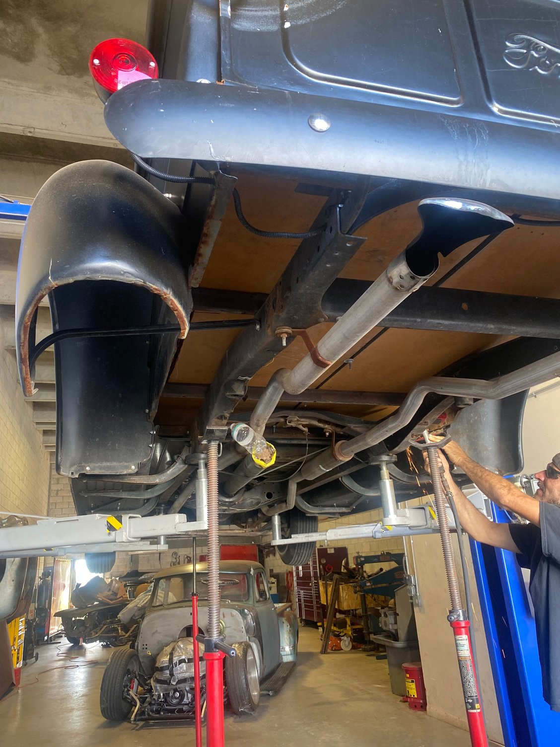

First pictures

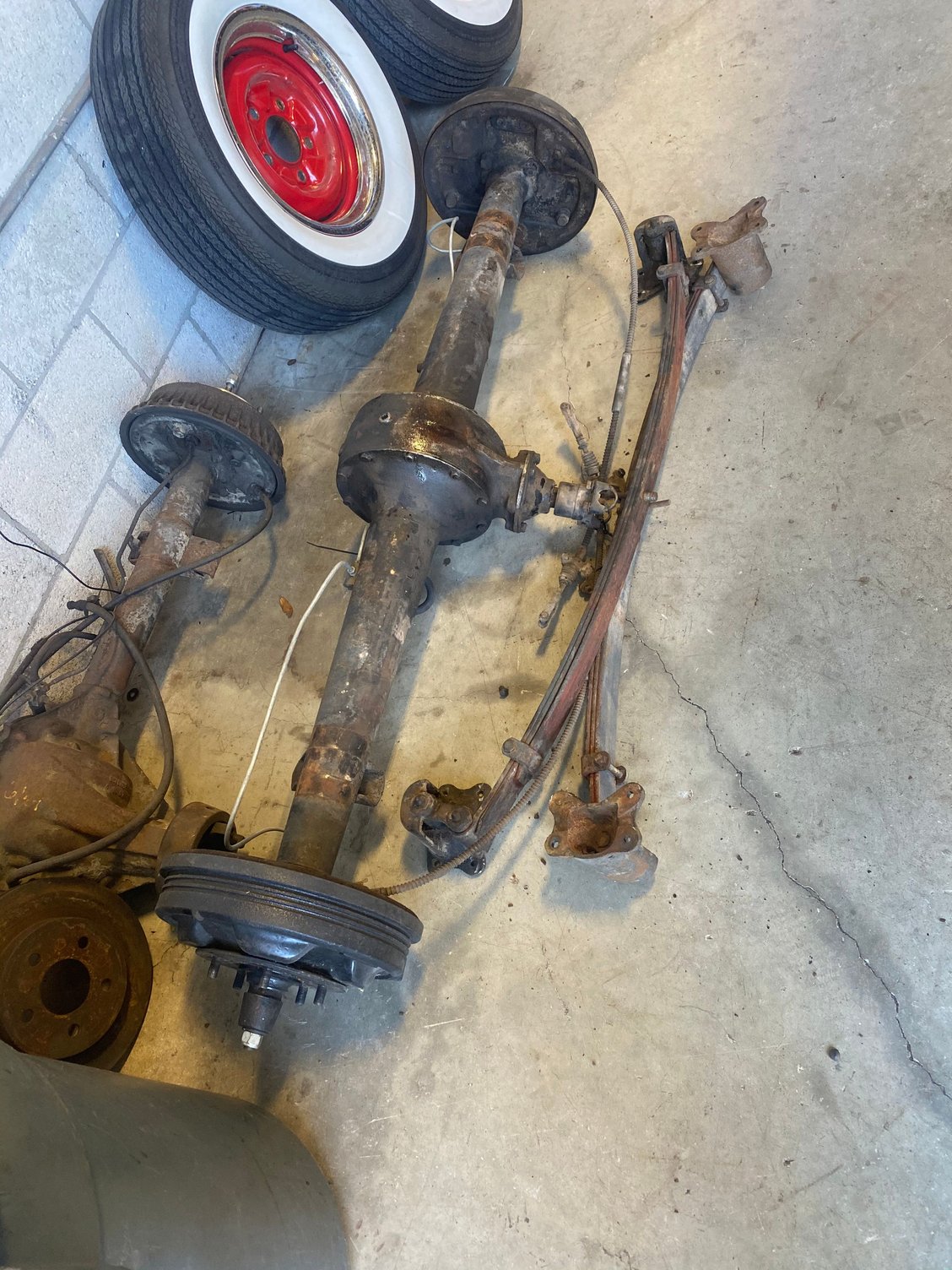

Original rear end and suspension out
New stance
Measuring and cleaning for new rear end
Still need to make “C” notch and grt it a bit lower. Raise the bed floor about 3 inches to clear new currie 9” rear end.

old rearend
Great looking project. I am keeping my 47 stock. Would you still have the rearend? And would you sell it?
Old Jul 6, 2024 | 05:51 PM
badger_hound's Avatar
badger_hound
Joined: Sep 2010
Posts: 995
Likes: 67
From: Mid-Michigan
Best of luck - this thread is almost 4 years old. That said, that looks like a banjo rear end. I'd think those would be easier to source from a traditional hot rod crowd, where they are plentiful vs. a truck forum, as those 41-46 trucks are just not as common as say the 48-56 models. Somebody could tell you whether older banjo rear ends and axles are similar enough to your truck's original.
