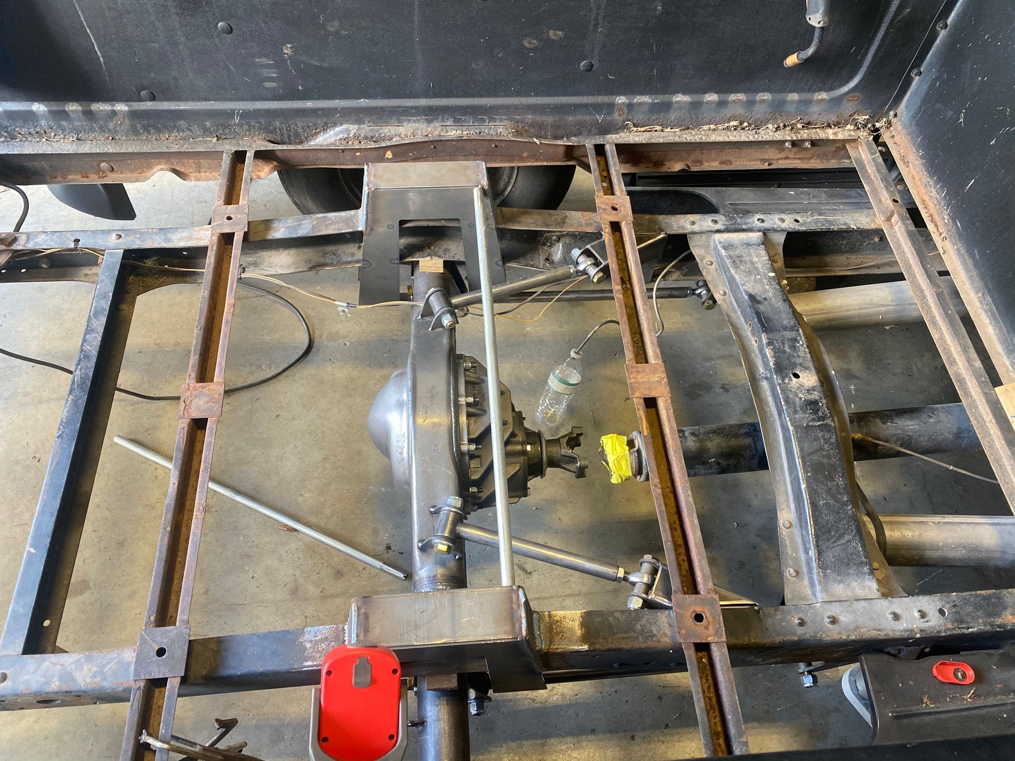

Rearend, four link and notch brakets

Nice work! It looks like the pickup bed floor will be at stock height, about 17 inches, but I am wondering about the acorn nuts on the bed sides.

Thanks!! Bed floor is going to end up a bit higher +/- 2 inches, we will probably have to make a new frame around the bed to lay wood. At that point we will know if the nuts will interfere. We are playing by ear at this point... i am sure a lot of things will change.
i’ll keep posting updates.
