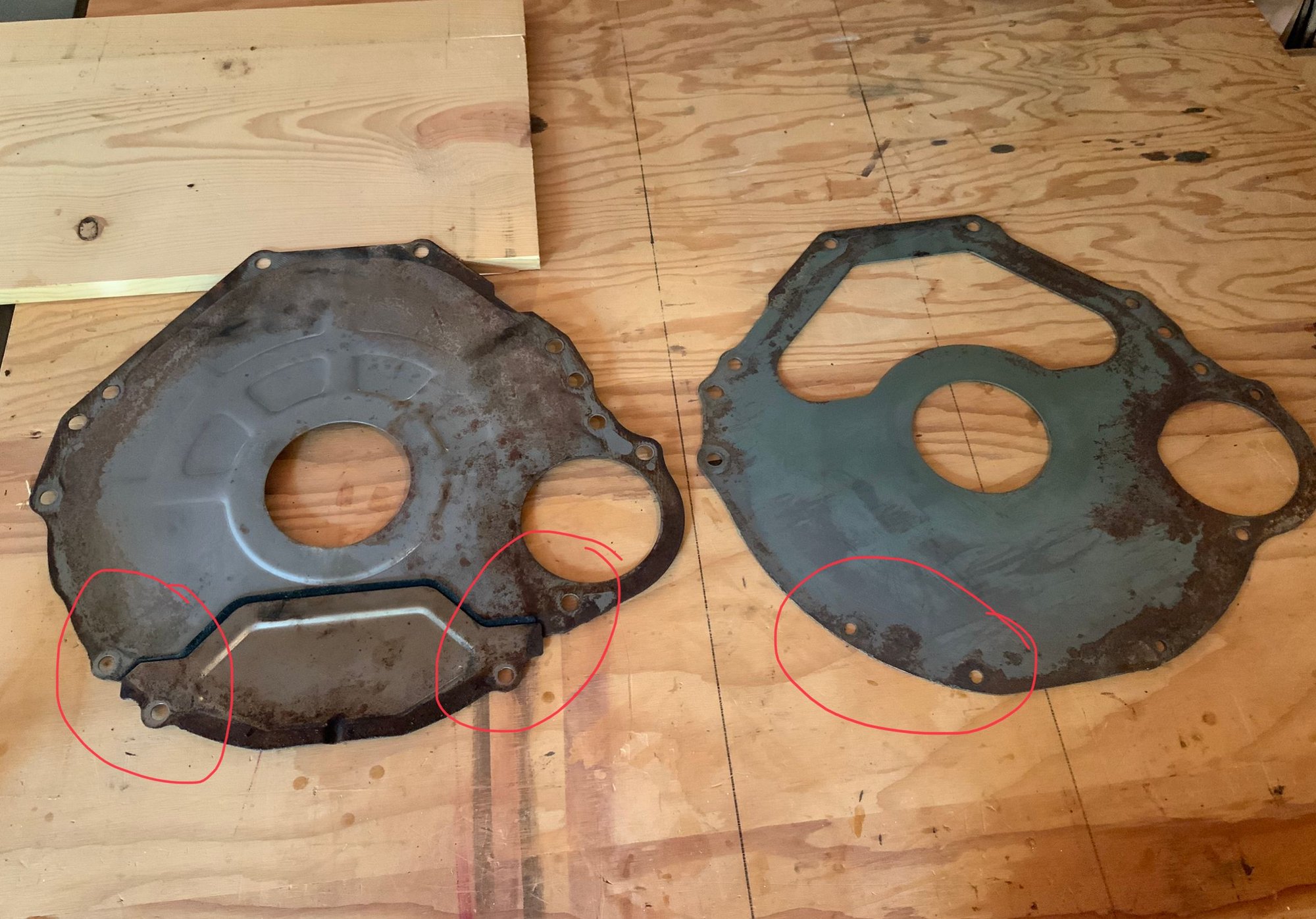

I just finished up my E4OD to M5OD.
In my case I had to use the dust cover from the manual transmission. The automatic one is two pieces and the smaller piece wouldn’t bolt to the transmission. I image to could modify the automatic cover and make it work if you had to.
Not sure about the ZF tho.

So just to confirm for everybody. My truck is a 96 f250 over 8600 pounds so its not obd2. To do the zf5 swap on my 351w with the e4od i had to get the wire harness off a 93 zf5 truck same as the cross member and i bought new clutch master and slave cylinder and flywheel. Its all in and the truck runs fine it idles a tad but higher without changing the ecm. Did need to get a different driveshaft and the plate behind the flywheel worked. Just incase anybody was wondering. And i have to get a different starter.
