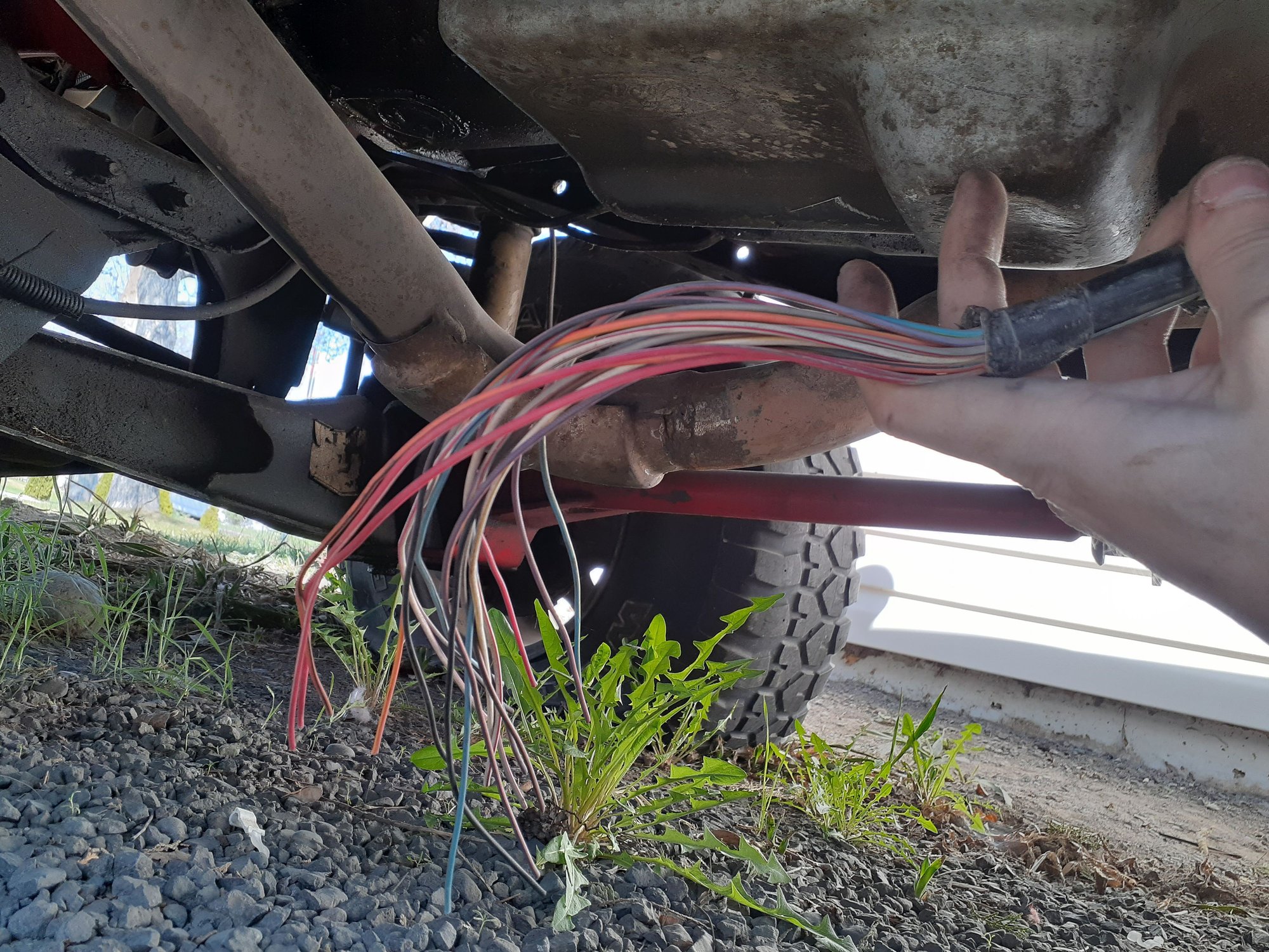

5.0l with a e4od out of a 91 f150 ..

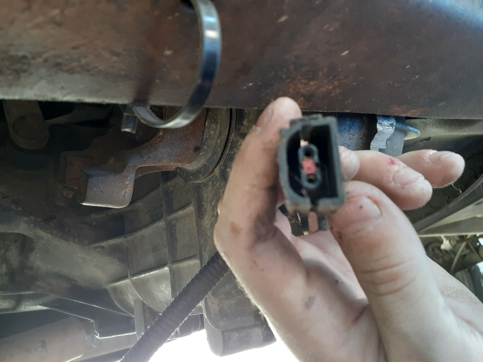

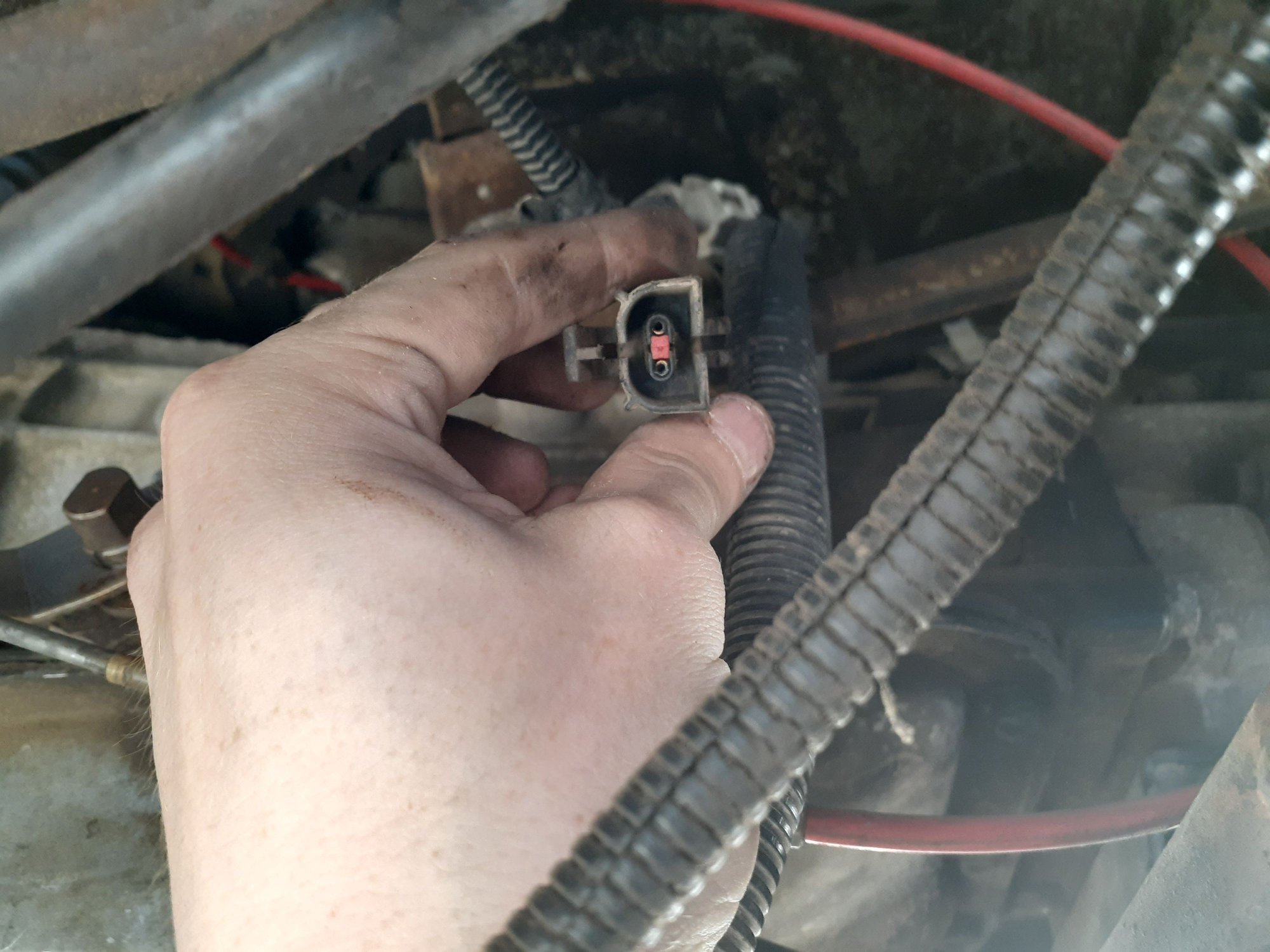

I just bought this project from my brother in law. It's like a 91 ford ranger lifted 6" with a 5.0l v8 out of an 89 mustang fox body, with a E4OD transmission he says is out of an 90 or 91 f150 that had a 351 w... there is a wire harness hanging down from over top of the transmission with 2 or 3 little plastic plugs and then a group of wires that are cut.. TOTALING 19 WIRES... he said the tranny needs a control module for all those wires to connect to n that's it.. but after doing research I'm pretty sure he is wrong and those 19 wires are supposed to not be cut where they are and
supposed to continue along the frame rail ALL THE WAY UP INTO THE ENGINE COMPARTMENT??.. and I think I need the ECM OR THE PCM to connect them to .. cuz I believe it is the PCM that controls the transmission?? The shift points and the tranny pressure?? Idk I'm trying to figure this out.. if anyone can help.. please do

I'm pretty sure he is wrong and those 19 wires are supposed to not be cut where they are and supposed to continue along the frame rail ALL THE WAY UP INTO THE ENGINE COMPARTMENT??.. and I think I need the ECM OR THE PCM to connect them to .. cuz I believe it is the PCM that controls the transmission.
Correct. An E4OD is completely computer controlled by the pcm. It gets inputs from multiple sensors including the engine and speed sensor. IMO, you’d be better off with and AOD or C4
