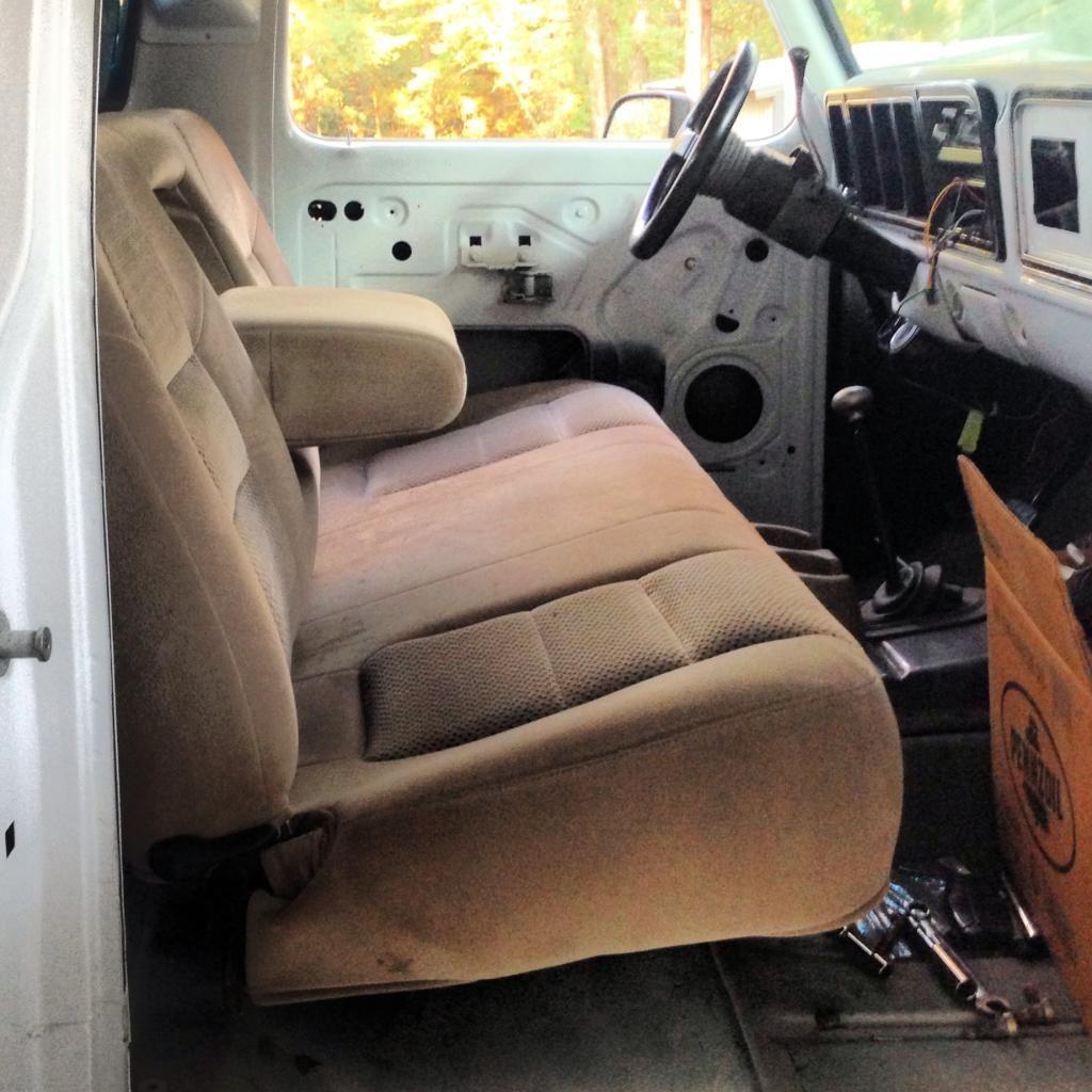

As requested by the OP. Sorry I can not find the redrill of the SD seat frame pics. Also forgot to mention that I am adding a 1" riser (square tubing) to get a little more height out of it. Riser down 1st, then OEM brackets on top of it. I can get some detailed pics tomorrow.
Some pics from that thread link in the PM.
Old May 18, 2020 | 09:43 PM
symonds86's Avatar
symonds86
Posts: 962
Likes: 89
From: upstate ny
Thank you around here a decent 80s or 90s seat is getting hard to find this gives me another option with cup holder none the less!!
Old May 18, 2020 | 09:51 PM
77&79F250's Avatar
77&79F250
Moderator & parts slinger
Posts: 50,256
Likes: 5,818

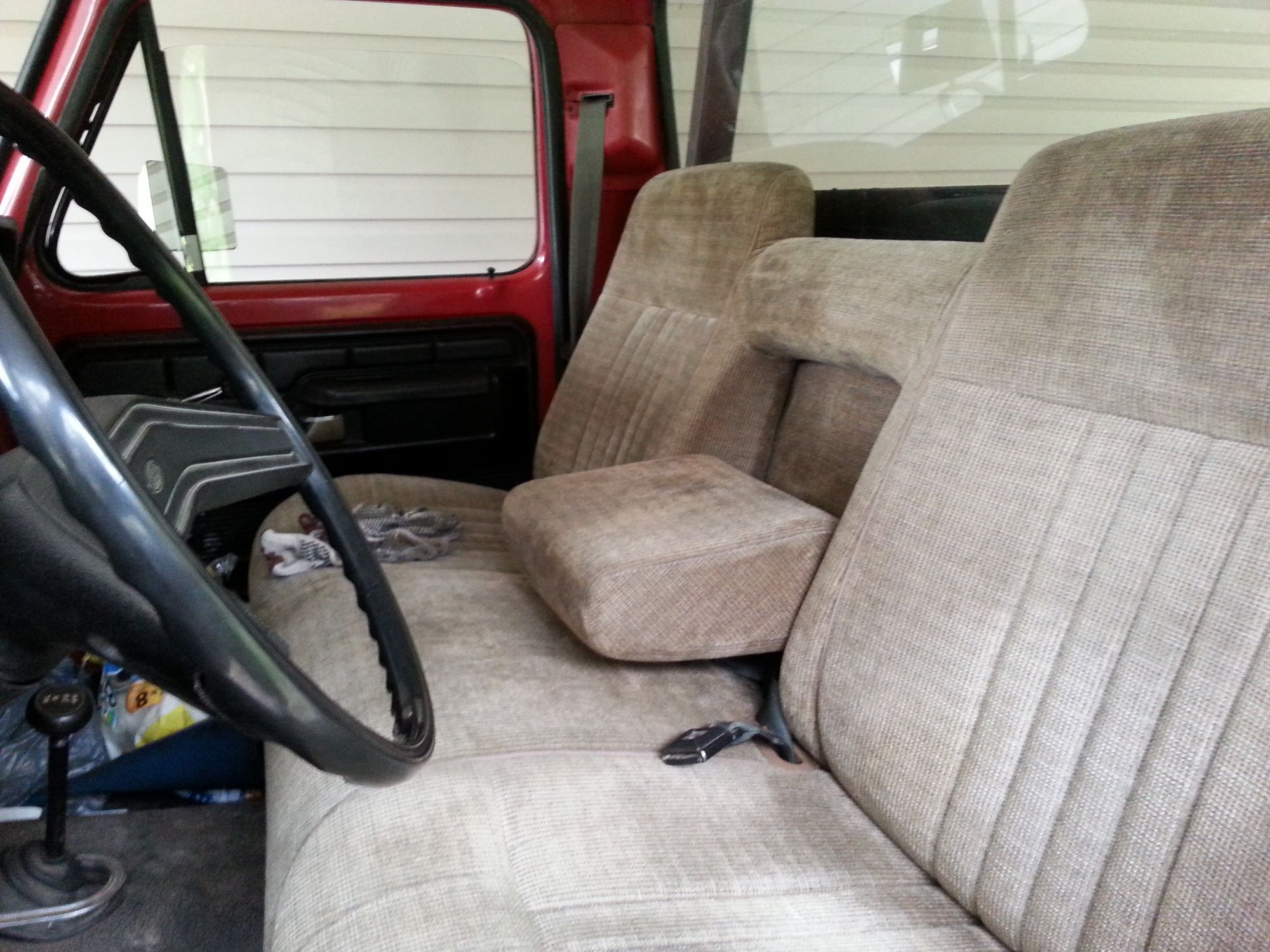

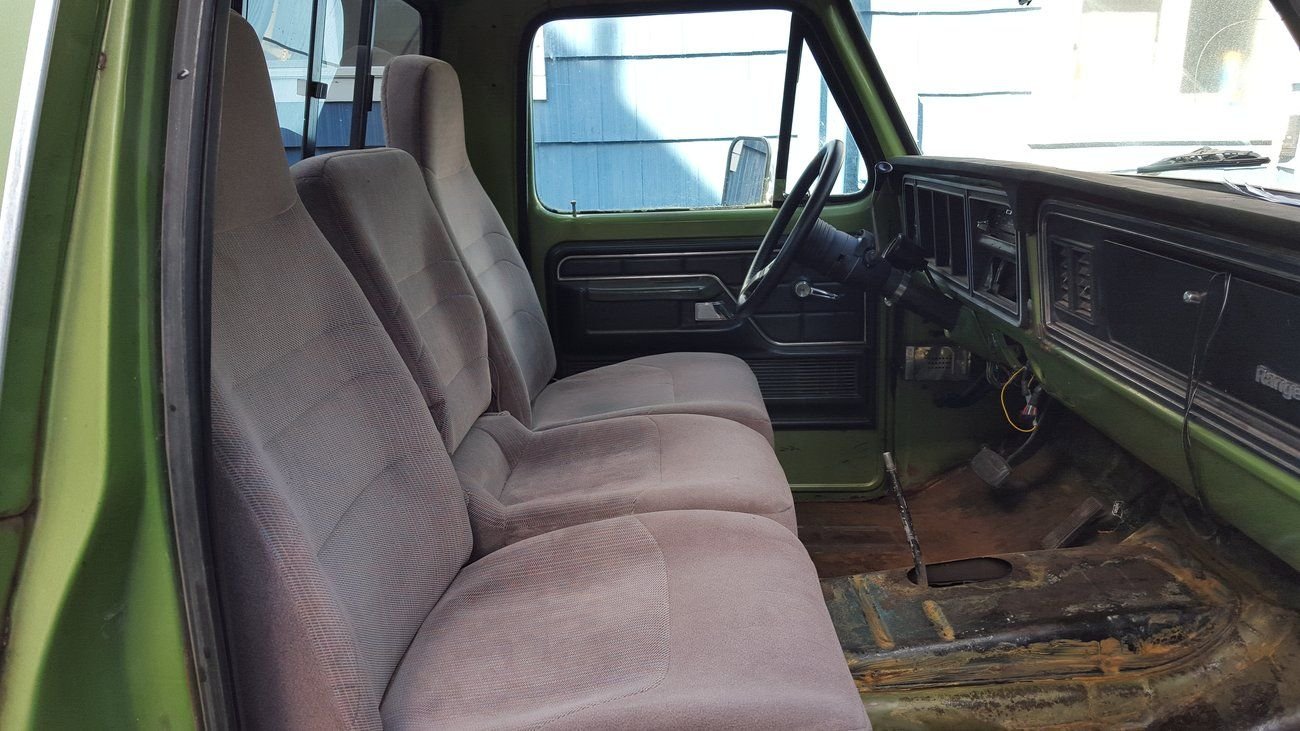

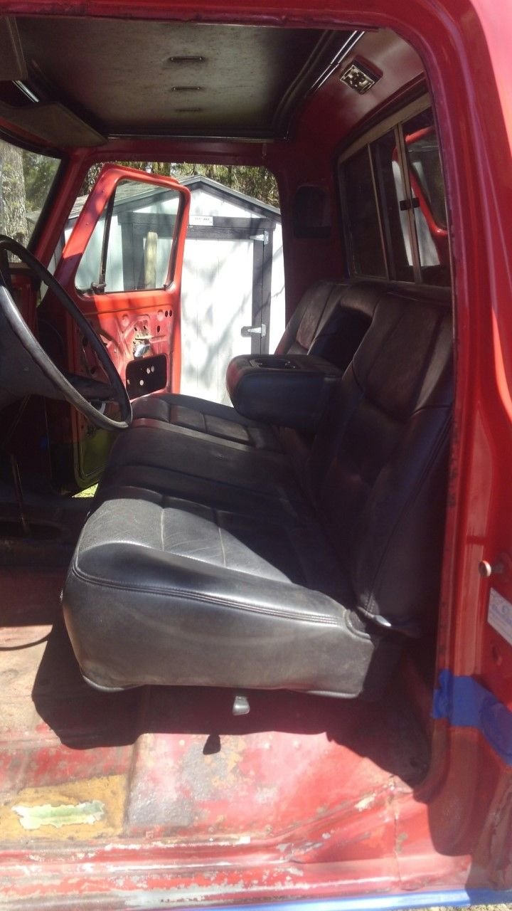

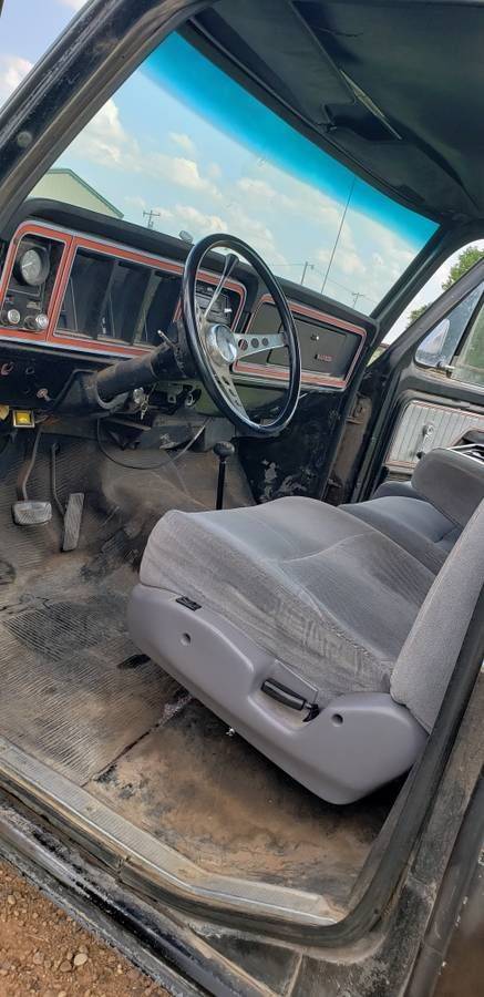

I got my seat from Craigslist for 25 bucks. SCORE! You can even put in newer ones, but looks to be more work and you are going to have to source power for most seats. The 02/03/04 are almost bolt and go.
05 in a SC. You can see the risers square tubing.
2011 in a SC
80's
95 Eddie Bauer
96
99 SD in a CC

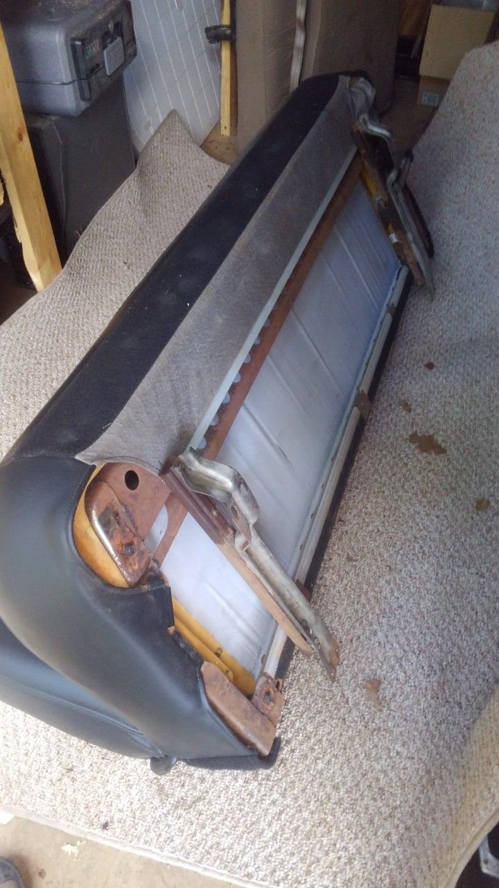

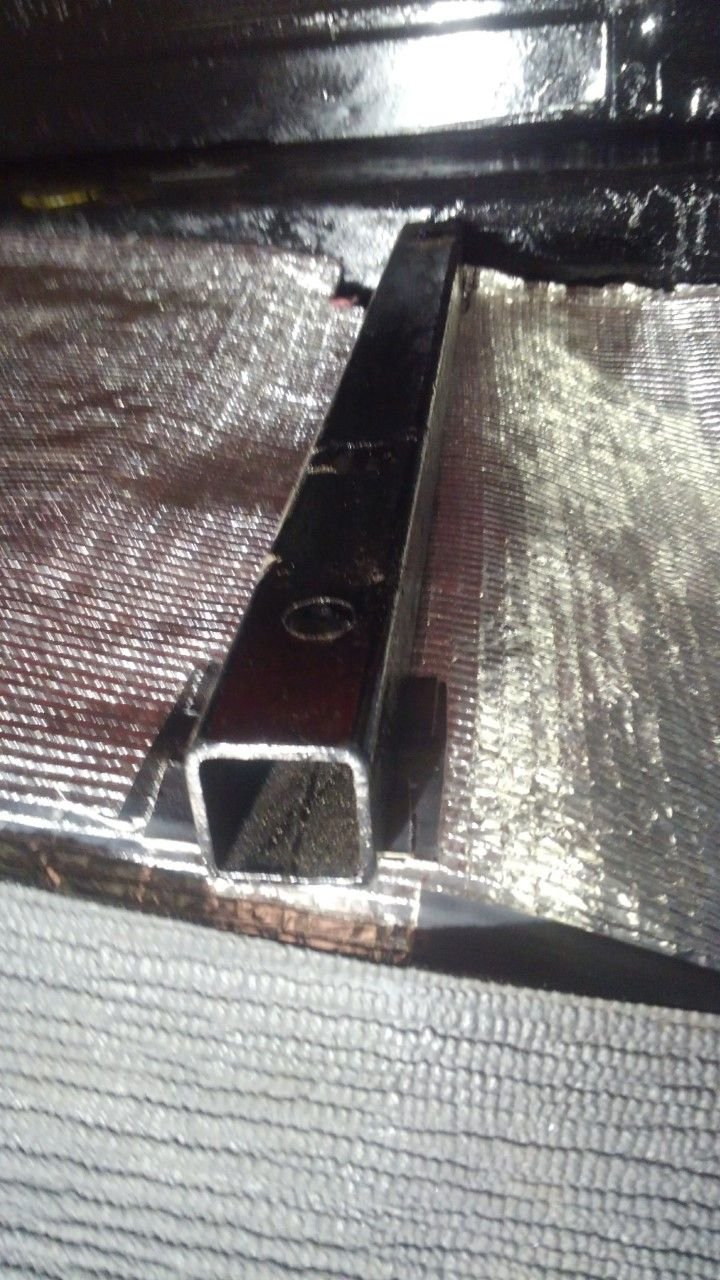

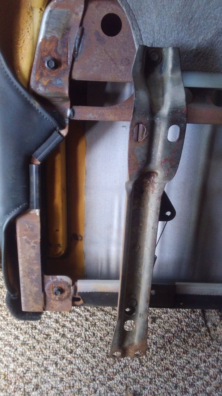

Old May 19, 2020 | 09:01 PM
77&79F250's Avatar
77&79F250
Posts: 50,256
Likes: 5,818

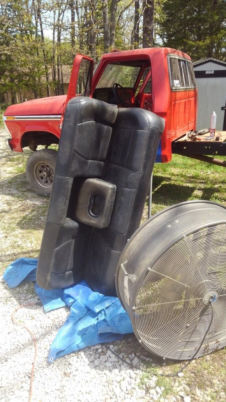

Here you go pics of the nothing fancy riser brackets and the 79 sliders on a 03 SD rear seat. I used the original fwd track hole had to redrill the rear one.
