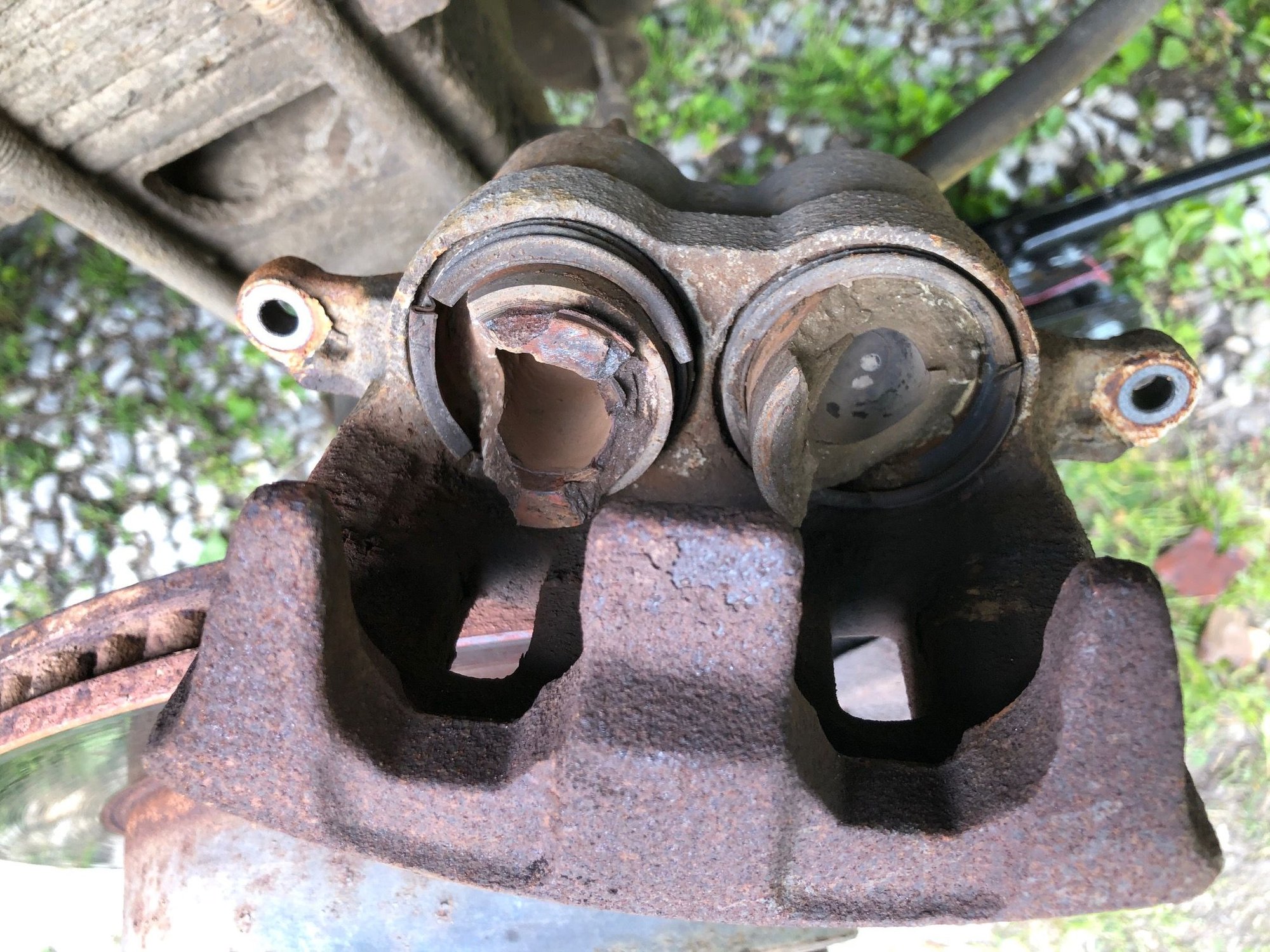

I would like to see the pads that came off it.
Denny

I had this same problem on my '07 F350. Two out of the four original calipers failed with cracked pistons and needed to be replaced. Everyone I've talked to regarding this echoes the same sentiment: the slide pins like to stick and the pistons really like to shatter. One friend had an '06 with really low miles. Was driving on the highway about an hour from home, unloaded. Started smelling an overwhelming smell of brakes and realized the piston shattered. No trailer, no heavy loads, and no hard braking. A few people I know factor in buying new calipers when doing brakes after anticipating and preparing for cracked pistons either from wear or careful removal. Can't tell you how many of my friends get around to doing the brakes on a Friday or Saturday night after every parts store has closed for the night, only to discover the pistons shattered in the caliper. They do seem to be pretty finicky and the sticking slide pins really seem to exacerbate the issue by way of excessive heat.

I had a cracked front rotor on my 08 F250 and a rear rotor on my current truck a 2013 F350 DRW come apart in two pieces when doing the breaks. Right around 60K on it.

I've had trouble the past few years with sticking pistons in two cars....a mustang and a taurus X. The slide pins were fine but the pistons while not completely stuck, were barely moving. With the mustang I went through 4 reman calipers at the Ford dealer in one day before giving up on them getting me 2 good calipers. I ended up getting reman calipers from Napa.
FWIW, I've also had trouble with sticking pistons on my wife's Volkswagen multiple times.
I flush brake lines in all my cars/trucks every 4 years so I have no idea what's causing it. I check my wheels every once in a while for excessive heat or heat differences from left wheel to right wheel is how I usually catch it. I definitely believe there's something wrong with caliper pistons the past several years.
I've never seen destroyed pistons like the photos in this thread. That's beyond unacceptable...more like inexcusable. Looks like the OP's caliper got really, really hot.

Bottom line here is that these trucks are not light. Our loads and trailers are not light. The braking system takes an enormous amount of abuse.
Whether you like it or not, those brakes got very hot. You have to build up some very serious heat to melt the backing plate.
No matter if it was caused by a seized piston, a stuck slide pin, worn pads or malfunctioning trailer brakes, it happened.
Yes, the brakes could be a better design. I was under my '07 every 20-30k miles messing with the brakes. Inspection, slide pin lubrication, pad replacement, backing plate painting or complete brake overhaul, all way too much fun.

I agree, these are not light-duty-trucks as they're labeled. We do push them to their limits (and sometimes beyond). I'm just wondering why these pistons are breaking the way they are. It's not like we've never over-heated brakes prior to 2008. I've never seen anything like this on any other vehicle (which is the reason fro the thread; to get insight, not lectured).
I'll be adding some additional maintenance to the brakes moving forward. Not a hard task to pull and lube slide-pins. It'll go with tire rotation cycles from here on out.

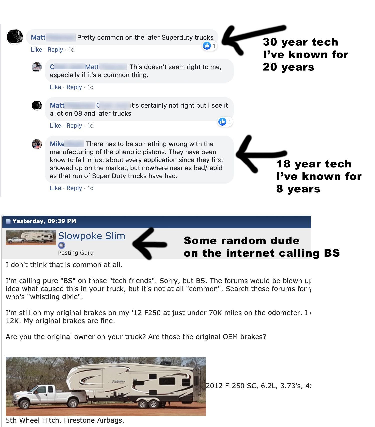

I'm going to take my favorite fall back position here. Just because someone posts something that is not a commonly reported on the Internet does not mean a number of folks do not have a similar experience it. It possibly means they are not reporting it. And simply because something is reported multiple times on the Internet does not automatically mean it is a common event.
All I am saying here is none of us really know the actual base rate of the events that seem to draw heated debate. Frequency of reports on the Internet or lack thereof does not automatically correlate with the frequency of the actual event. As an additional thought, I am not sure insults help to clarify the situation.

New guy comes on here and posts a problem. A couple tech friends say this is a common problem.

A regular member here posts his opinion that this is not a common problem and call BS on the tech buddies.
Originally Posted by Slowpoke Slim
I don't think that is common at all.
I'm calling pure "BS" on those "tech friends". Sorry, but BS. The forums would be blown up with threads about this if it was true. I have no idea what caused this in your truck, but it's not at all "common". Search these forums for yourself to see who's speaking realistically, and who's "whistling dixie".

New guy defends his buddies.
Originally Posted by CTJocko
A valid explanation.

Now, is it happening at all? Yes. Yup. Affirmative. It's happening. There are threads. There are pictures even. Is it "pretty common"? Nope. It isn't. Now, I'm about to take a left turn on you, so hang on tight again...
You know what is common about those occurrences of brake issues like yours? Brake caliper slide pins going ungreased and sticking, causing the calipers to stick, and then get hot. That has been a "pretty common" theme to these incidents of brake problems LIKE YOURS. Now it seems to me a guy like YOU, with 2 (not 1, but 2) extra super tech buddies would KNOW TO GREASE THE DAMN SLIDE PINS.

IMHO, there is something not right when a caliper piston comes apart like that. In 280,000 miles on my '99 7.3, I never had an issue like this, and that truck got abused.
I appreciate others posting their issues and where those issues may have stemmed from. I guess I'll add lubing the slide pins to my annual maintenance schedule.
Like I said earlier... Brakes could have gotten hot but if they did, there were no signs (smell or feel).
Over the years I've owned a 97, 99, 02 and 08. The 08 is an F450. While I have had slide pin issues, (who hasn't that's owned one of these truck) I've never had a piston break. So, for me, that would be highly unlikely. It's one thing to call BS on someones claims that aren't on here. It's entirely different to accuse that guy of sucking someones dick. This thread has been an enlightening experience. Hope everyone has learned from it.
