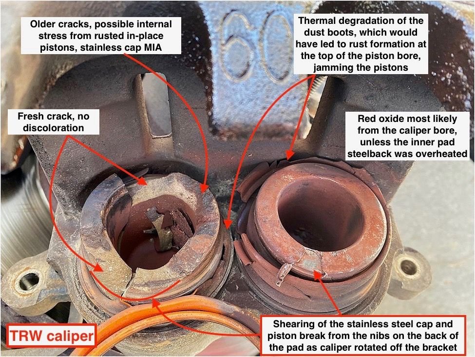

I have a 2000 F250 4x4 and a 2006 F350 4x4, the 2000 I have had for many years and have replaced all the calipers at least 2 times from sticking pistons not sticking slide pins. Pistons have never shattered on that truck. I just did the rears on the 2006 which I have had for only 2 years the pistons on the right side shattered from just removing the caliper from the rotor. First thing that came to my mind was what kind of crap are these things made out of if they shatter like this?

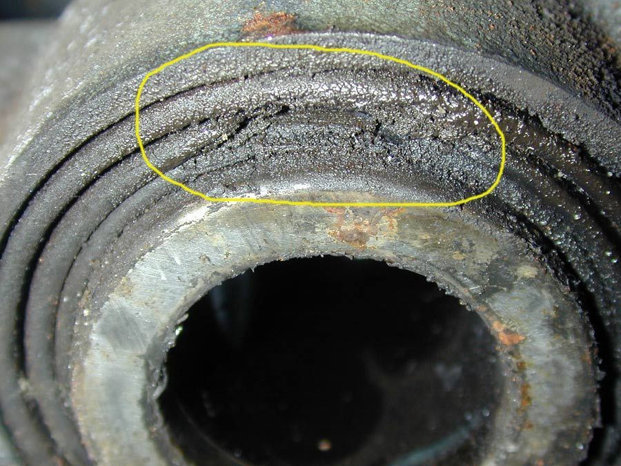

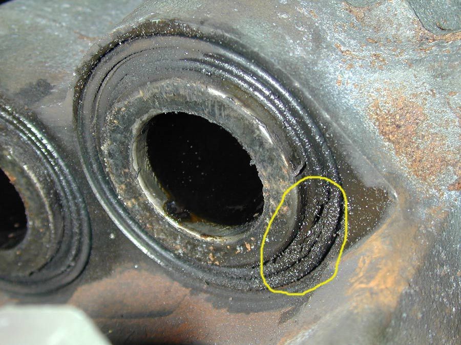

I'm not sure what some people drag me into these, or why I let myself ......
Long extension of the pistons, I'm guessing frozen. All of these had compromised botts from heat, can't say if the boots degraded then the calipers froze, or the boots degraded because of frozen pistons.
Moderate to long piston extension.
Long piston extension.

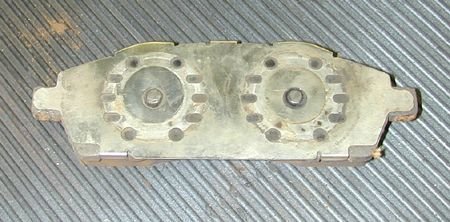

This was from an Excursion. Because they were being shipped to Germany, Ford required us to run the AMS thermal test which the Auto Moto Sport German magazine would run on vehicles in the Alps to see if the brake pads burned, and for how long.
New calipers, ran the two-day test, inspected, then parked the Excursion in the parking lot for a few months. It's not uncommon to have flames off the pads, and it's typical to have the boots burn. the early Excursions with the Akebono calipers had a stainless steel thermal barrier attached to the back of the pads. This was when we pulled it down to run other tests.
Stainless plate and the typical noise insulator retention nubs - the reason you have to push back on the pistons before moving the calipers off.
The caliper boots would look OK unless you viewed them carefully. In time, brake fluid would show. Brake fluid being extremely hygroscopic, it doesn't take long for the water absorbtion from high humidity days to go under the boot lip and freeze the pistons in place. Normal stops with a vehicle develop about 250psi hydraulic pressure, and on the backs of these pistons becomes 900 to 1,100 lbs of force, easy to overcome frozen pistons, but they don't retract with rusted piston bores. It starts to cascade.
Pictures of the Excursion test caliper and pin boots after sitting in the parking lot. The heat thrown from the rotors usually does a number on the sliding pin boots.
