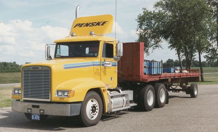

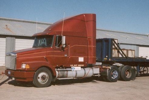

Thanks. Its funny you said that. When I take my grandchildren out for my version of defensive driver training, when we are on a long deserted road I say to them, now stop the vehicle without using the brake pedal. Then we turn around and I show them how long it took to do that. It gives a new appreciation of brakes. With my first car, a '66 Mustang with drums all around, I experienced brake fade with 5 passengers in the four-passenger vehicle. Blew right through that stop sign late at night. I put the best shoes in that car after that. A good lesson at the age of 17.
Testing tractor-trailers, I used to leave my test drivers at home and do it myself, or at least push them out of the way for part of the test.
