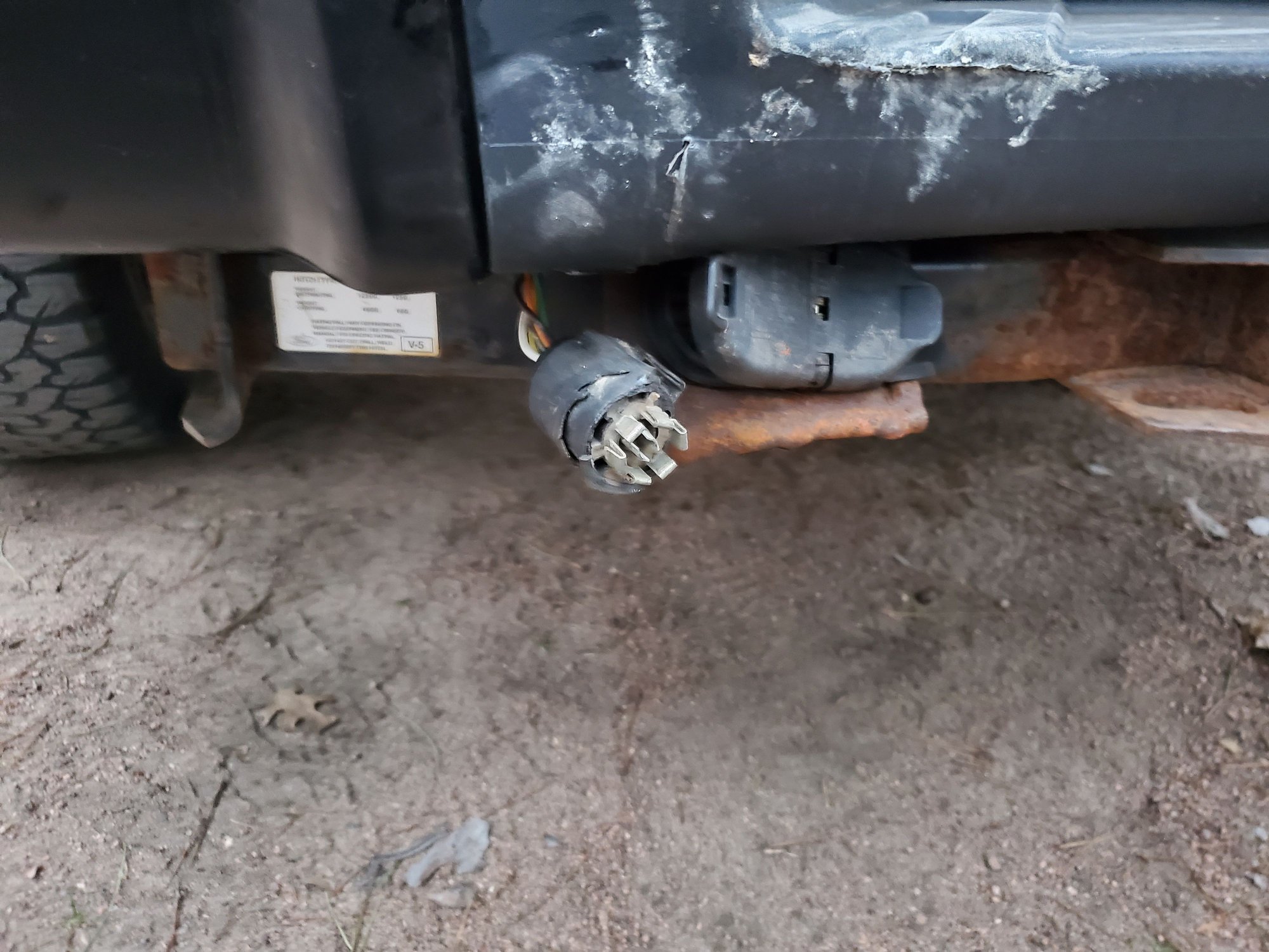

Hey guys, a tree jumped out of nowhere and I backed right into my trailer plugs and crushed them. I'm wondering where I can get the exact replacement parts for my 2012 F350. Is there a harness that disconnects somewhere or am I going to have to do some splicing? The plug is completely smashed.

you could try e trailer.com or ford parts.
I get oem parts from autonation while bear lake (formerly tousle ford.
Should be able to get the harness from the plug to just around the spare tire where it connects into the wiring harness.

Ok. I've found a replacement plug with the 7 pin and 4 pin on it easy enough on the internet. But I can't find a harness anywhere. Any ideas on a part number?

you can check rock auto and see if you can find a part number as well as autonation whilte bear lake. both usually have every good diagrams to assist.

This might be what you are looking for on the truck side wiring. Pigtaill WPT-975 3U2Z-14S411-JXB.
https://parts.autonationfordwhitebea...ssembly-wpt975
https://parts.ford.com/shop/en/us/el...-1#partMatched
Connector bracket
https://parts.autonationfordwhitebea...RpZXNlbA%3D%3D
About $75.00 with free shipping
https://www.ebay.com/sch/i.html?_fro...acat=0&_sop=15
Bracket on eBay for about $33 with free shipping
https://www.ebay.com/sch/i.html?_fro...&_odkw=wpt-975

Dumbest place ever for a trailer plug.
For years I was moving them up to the license plate area then GM finally figured it out w the GMT900s and put it up there from the factory. I think Ram started around '08/9, too
You can get a decent receptacle at most corporate stores - there's an "armored" version I prefer which is SLIGHTLY more heavy duty...then if you can pull the trigger on a drill all you need is a hole saw and 4 smaller mounting holes.
