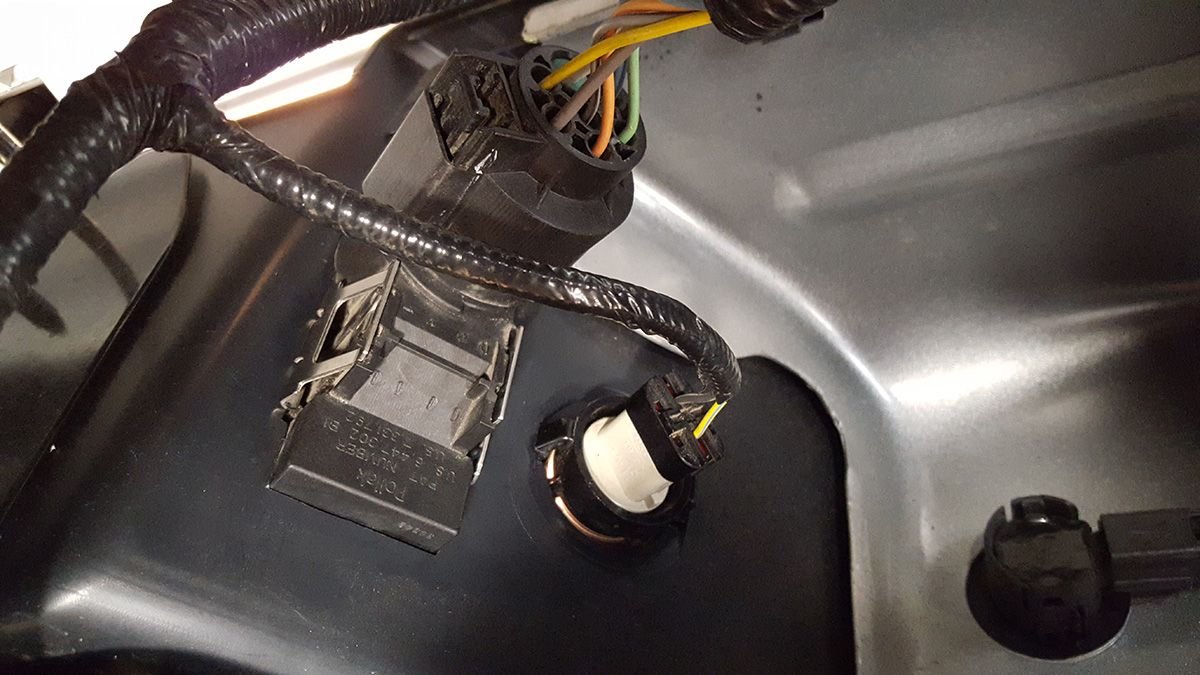

I never liked the way the factory trailer plugs were attached to the side of the receiver hitch. Looks like an afterthought on a cheap bracket.
The other day I was driving down the road and noticed how a Chevy Silverado had the plugs in the bumper next to the license plate. I thought.... I can do that to mine.

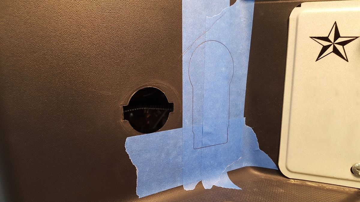

So I checked under the bumper and there was room. I removed the bracket and plug. Used it for a template.
Cut out the plastic with a Dremel and assorted bits.
Then installed the plug and attached it's wiring.
I like it much better now.
