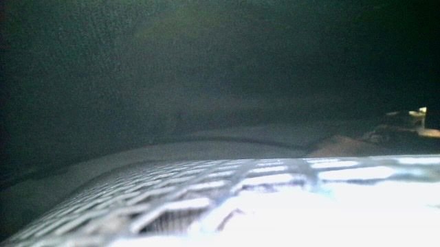

Just in case anyone was wondering (I always did) about the clearance between the air filter and hood using my tilted install method, I had the borescope out the other day and snapped some photos with the hood closed. It’s pretty difficult to get a good shot but this is the best one. What I see is plenty of room above the filter even in the tightest spot.
This method allows for lots of room under the filter which should be getting fresh air from the snorkel. It also pulls the filter away from the fender and should reduce introduction of water from the hood/fender gap. It locks the filter in place and positions the intake hose high to clear the inter cooler tube and such.
This of course is just my opinion but explains why I prefer this method instead of the laying it flat and having the filter all the way to the edge of the fender.
