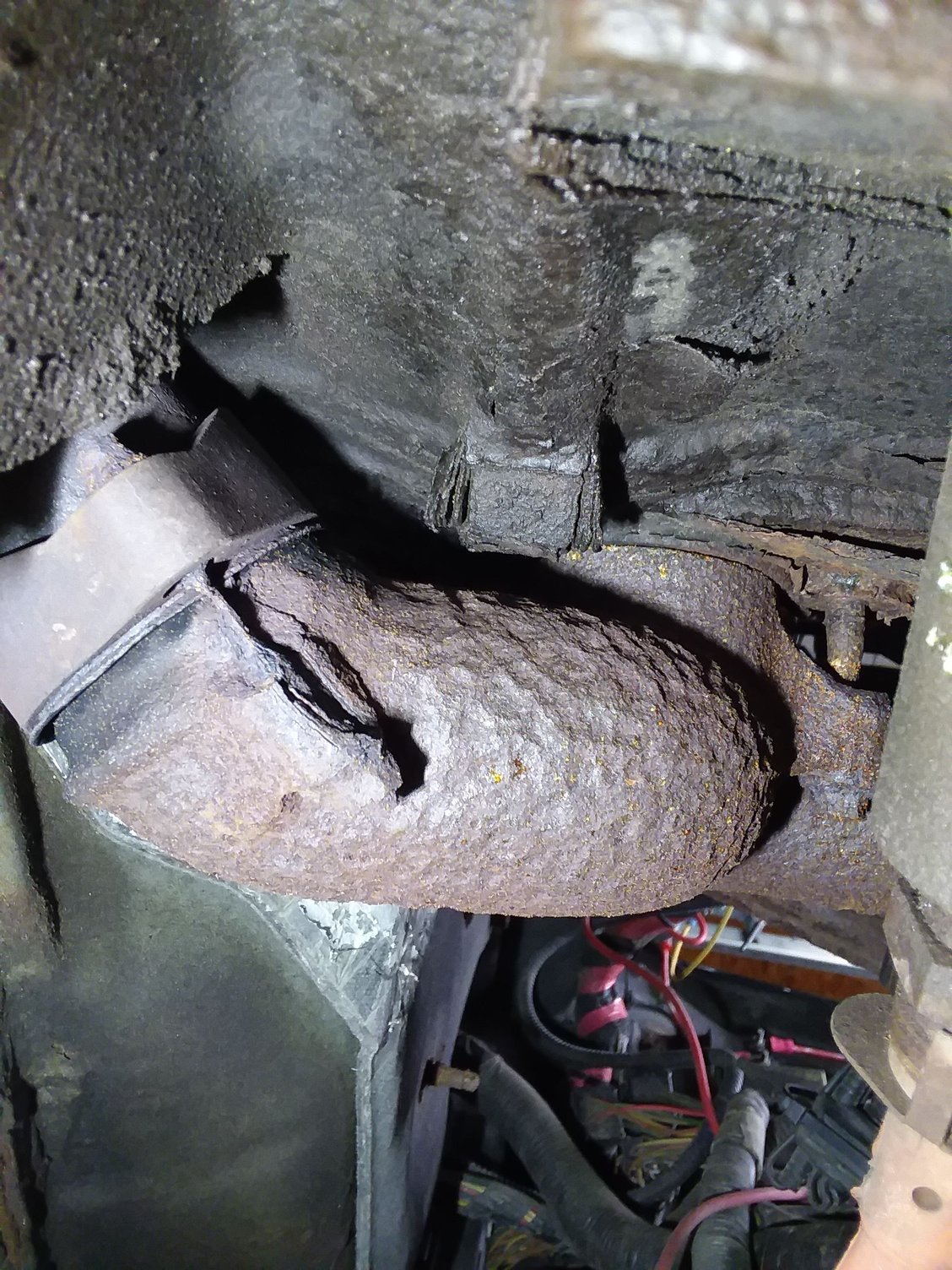

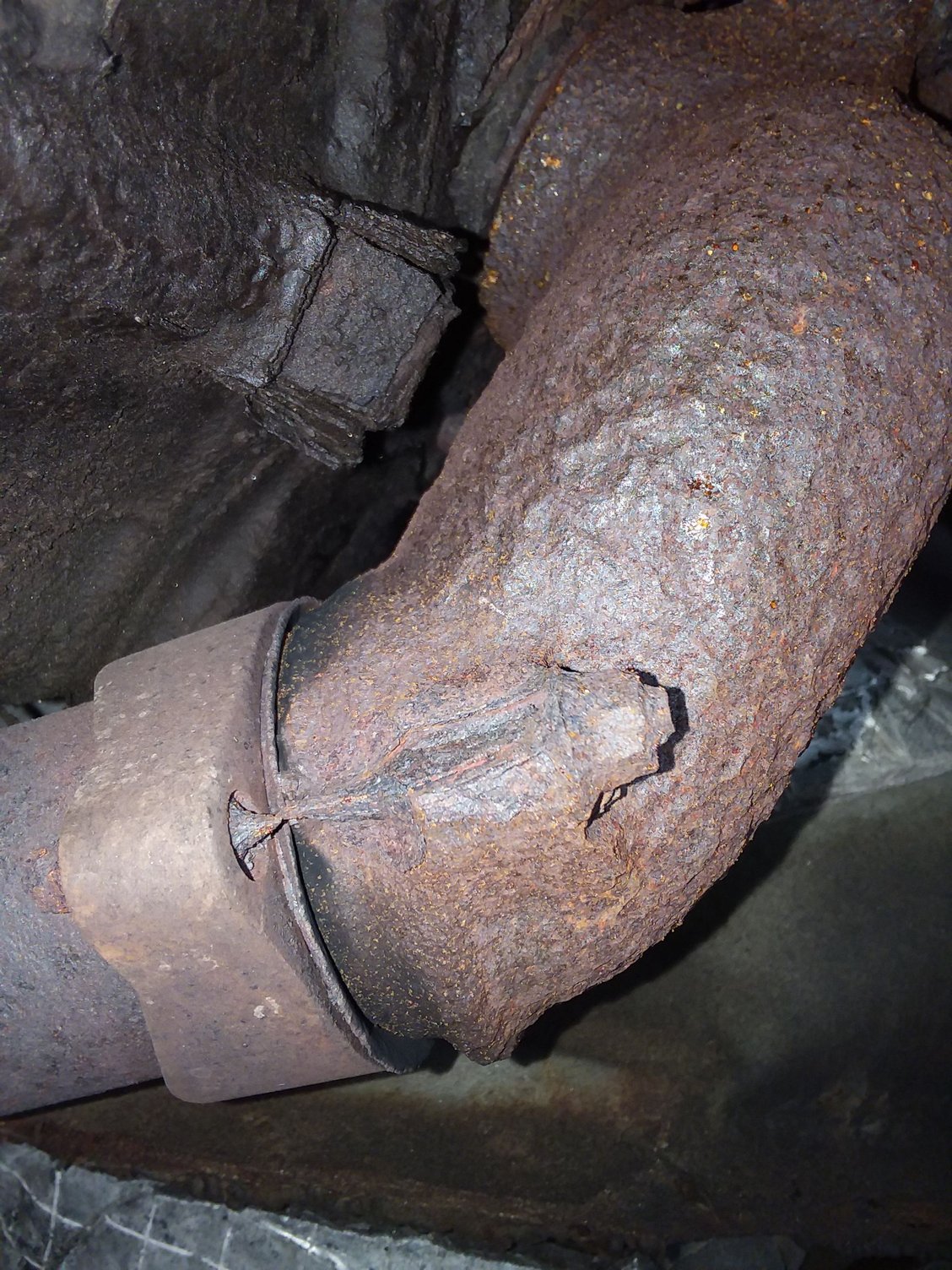

Was doing some poking around looking at my stabilizer links as some of the rubber is deteriorating and I saw that the bottom boss on the driver side manifold that holds the up pipes are gone. I knew the bolts were rusted away and the up pipes are leaking and I have new ones waiting to go in but this just floored me today. What concerns me the most is the bolts that hold the manifolds to the head are not in the best shape ether. I believe those are aluminum heads and those bolts have been in there since new so it's got to be a bear to get them out and probably beyond what I'm willing to tackle now. I forgot to take a pics of the head bolts themselves and will later to show what kind of trouble I'm getting into. If I have a shop do these what kind of $ am I getting into? The passenger side is fine.
ting into? Also are the manifolds cast iron or steel?

My 96 C&C truck lived it's early years in Michigan, so it had a lot of rust issues. I found the bolts to the heads were rusted into the exhaust manifold. I wound up cutting the bolts off with a sawsall, removing the many, and using those Erwin bolt extractors to get the stub bolts out. It worked on all but one bolt that had snapped off flush with the head. That one had to be drilled out. By the looks of your pics, those bolts will be rusted into the manifold.

Did as bit more research and called a local diesel shop. labor just for manifolds $850. Ouch. anyway if I just blow off the heads of the bolts then knocked the manifold off and used my stud extractor that grabs the outside of the bolt shank, do you think what's left will come out? One guy said the 7.3s always come out. Also has anyone used or have heard the pros and cons of using stainless steel bolts reassembling it?

When I did mine, the bolts were really rusted tight in the manifold. I had a time driving the cut off bolts out of the manifold after it was removed. You may get lucky with just removing the heads of the bolts. Those stud extractors worked well for me. When replacing the manifold, I just used the stock bolts from Ford, but covered really well with anti-seize compound.
