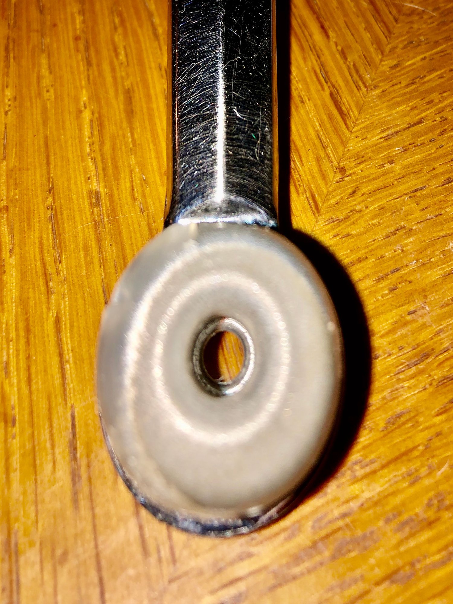

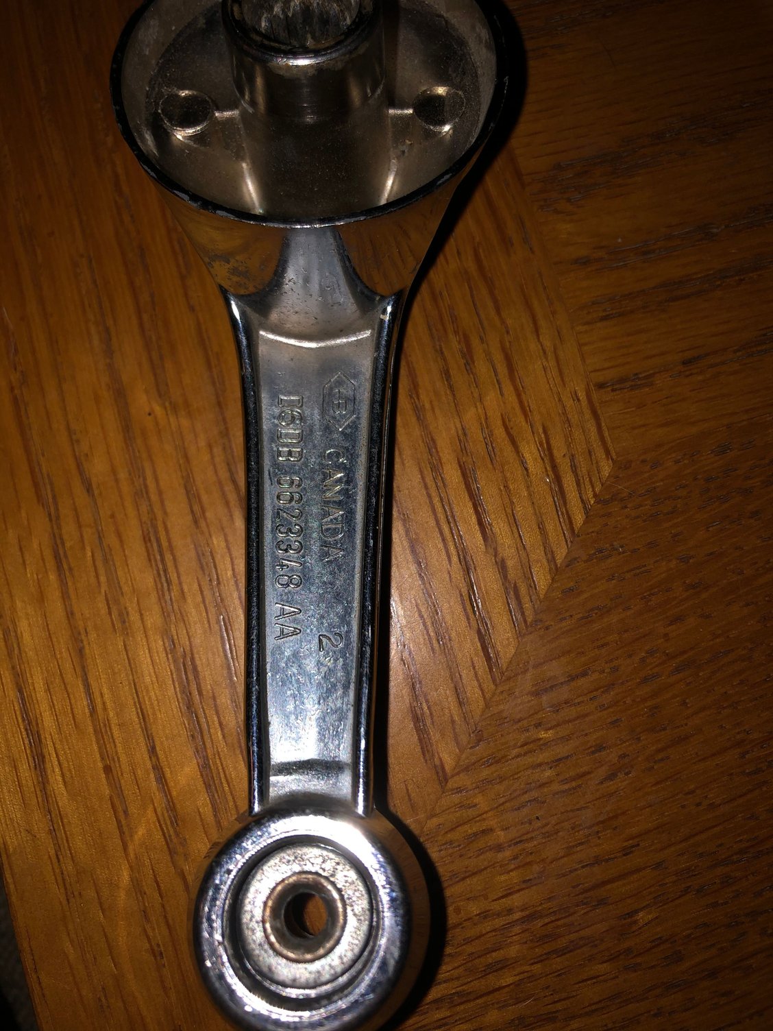

This seems like the simplest of things to do and maybe I’m missing something here but I feel totally stupid asking this. How do I replace the crank ****? Mine are pretty much gone, I bought replacements from LMC and can get old ones off. They do NOT have a screw holding them in. It seems to be a pressed in river of some sort. The replacements have the push in rivet, adhesive cap, a little odd shaped ring and a screw. I also have an 84 E350 van that has same setup. The cranks are in great shape so hate to replace those as well.
here’s what I’m talking about.

The whole window crank is cheap just replace it.

Agreed. Just replace the entire handle. I applaud your efforts on wanting to keep the originals but in this case, it's such an abundant and insignificant part, it's just simpler to replace them entirely.

Yes it is a rivet, easier and faster to just replace the complete handle. The are reproduced by a number of companies. Dennis Carpenter, Jeff Bronco Graveyard, Nationial Parts Depot....
But since you already have the pieces to replace them, and the old ones are off. Goodle/Utube "how to buck a rivet" and go for it. Worse case you have to buy a complete repop assembly.

I replaced both my 77 F-150 window crank handles from a 1989 F-500 we were junking at work, they fit perfectly and they're metal. You might consider checking your local junk yards, if you want to retain Ford parts.

I second eqcmcat junk yards are the best spot to get window cranks. Everytime i go to pick and pull i always seem to leave with a couple. I always seem to have one a year break or so. All these people use to newer cars think you have to turn it like a rusty bolt and pop the roller off.
