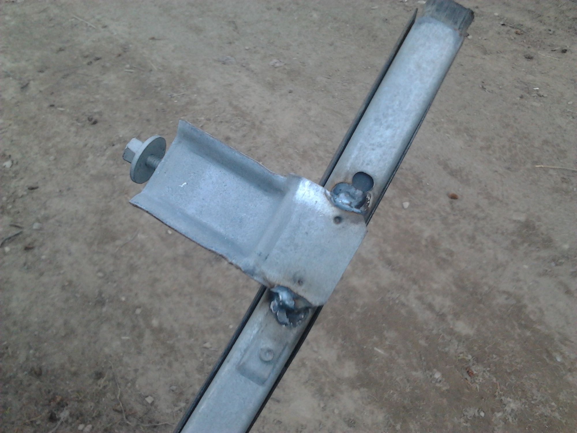

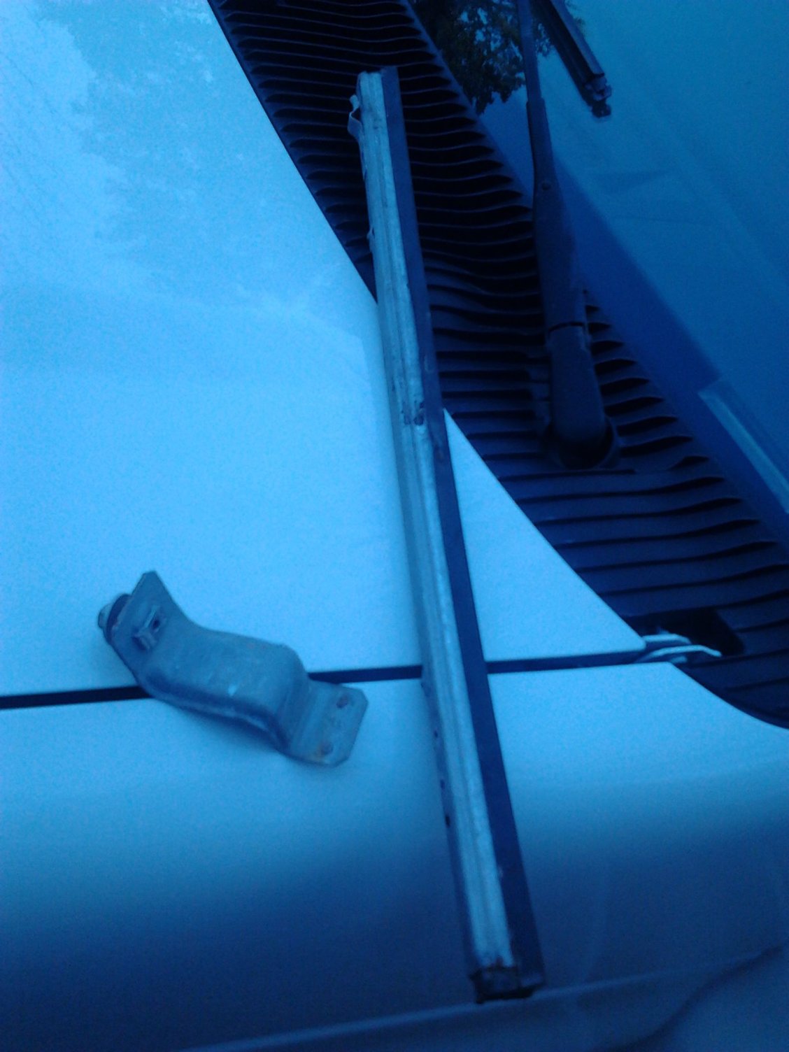

ok all, so i figured this out and hopefully this will help someone else down the road.
I took the door panel off and found a steel bar with rubber on it laying on its side right where the window mechanism comes down.
Upon closer inspection, i figured out it was the door latch side window track. it had broken off the spot welds from the mounting bracket. Took it out, cleaned it up, reinstalled it and the window works perfectly!!

Depends on the year----if its pre-1992 then no they're not all the same. Beginning 1992 window regulators became cable operated, previously the older style worm and sector gear types----that's why I asked.
Your find was good investigating on your own and that lower track loose from the spot welds is a bit rare but not uncommon. I've replace more than a few of those in all sorts of vans and big trucks, almost always drivers side too.

I had a question about the broken spot welds, JW. Could that happen with someone prying on the glass to break into the van? Hard to tell from the photos if it was just fatigue or force that cracked the welds. jim
Most likely not Jim----vandals almost always pry against the exposed glass which is above the channel MotorCar shows us. When prying against the glass it typically breaks, a small indentation in the exterior surrounding glass run channel that's part of an appearance molding too. Or they'll just break the glass to do a ****** and grab theft, hoping to not set off any vehicle alarms.
Those lower run channels tend to last darn near forever, MotorCar's experience a bit rare. That part isn't under any real mechanical stress per se which is why failures aren't too common I've seen this same thing across all sizes or types of vehicles brand notwithstanding, most likely just bad spot welds.
FWIW when repairing this part in the field I'll position the two parts to their original locations and secure them with self drilling Tek pan head screws. Remove the rubber channel and run the screws from inside the metal part so the heads become buried behind the rubber and not cause any damage or pressure on the glass as its lowered to its bottom limit.
