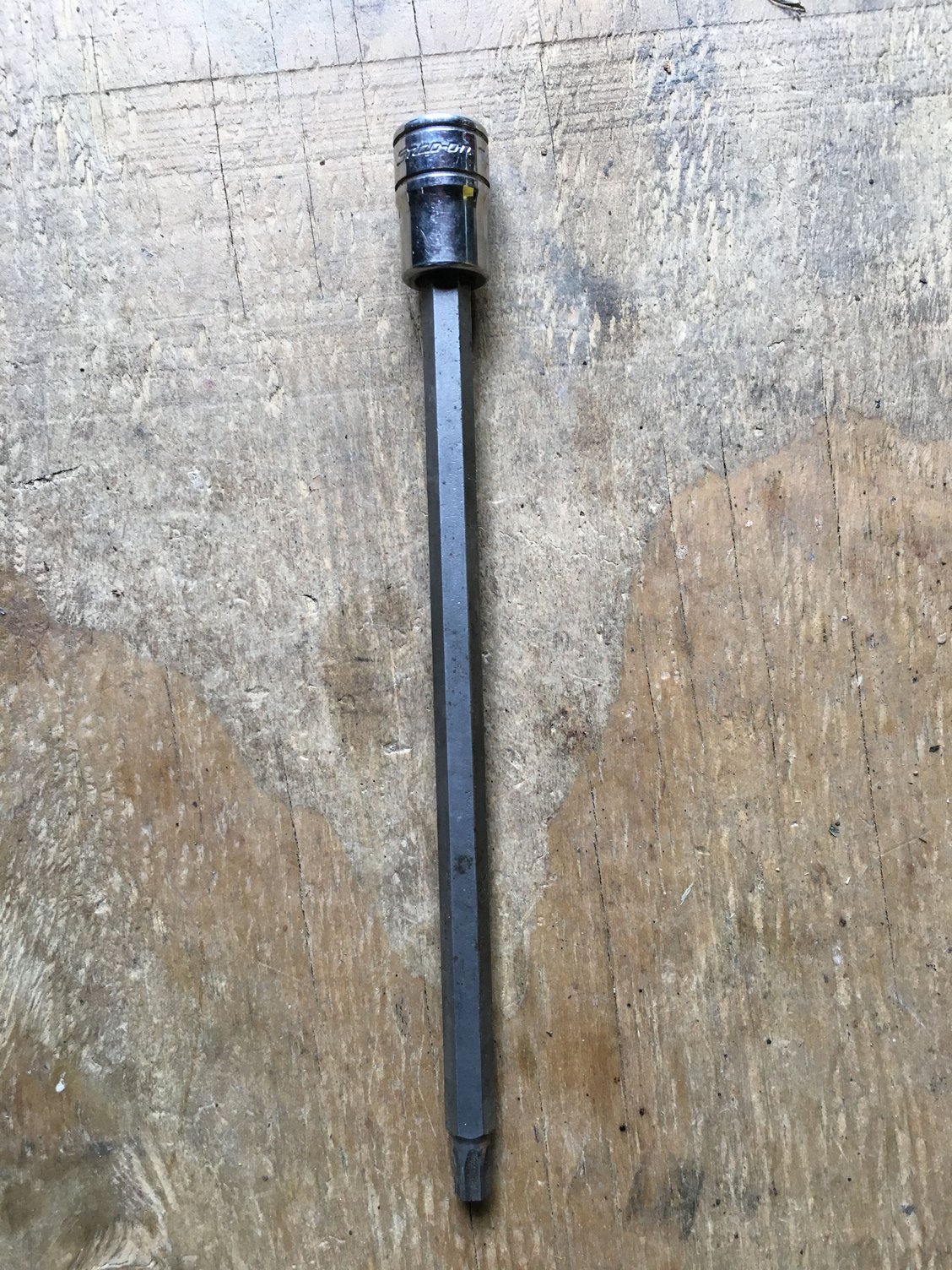

They can be a bear to break loose if they haven’t been out in a while. This is what I use:
It is a T40 Torx but you knew that, right?

My extra long Torx bit says T40 on it.
