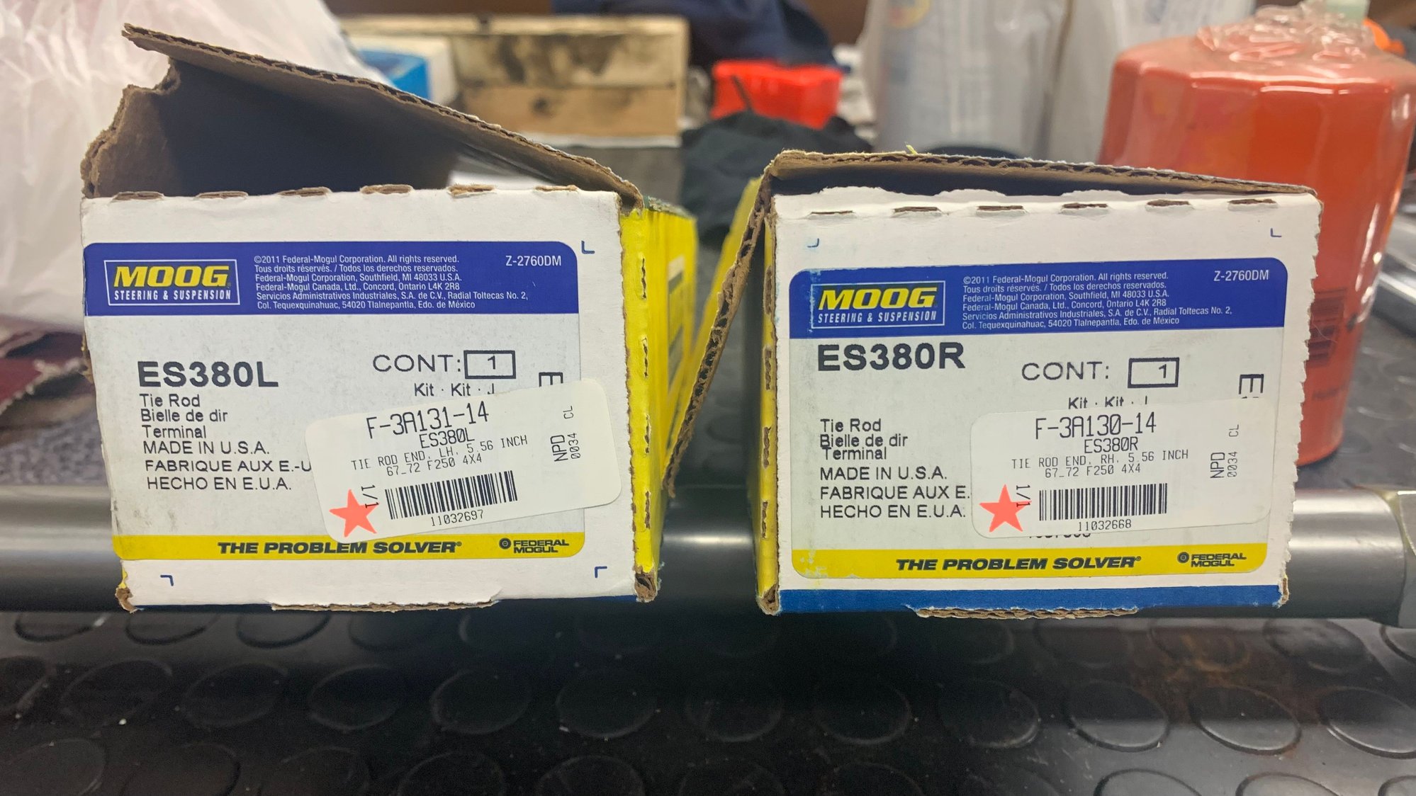

Old Oct 25, 2021 | 12:10 PM
fe390pc's Avatar
fe390pc
Joined: Mar 2009
Posts: 4,853
Likes: 607
From: Minnesota
Hey sir here is a pic of what is ready for you.
This is what I have.
Old Oct 25, 2021 | 12:38 PM
bajafishnut's Avatar
bajafishnut
Joined: Nov 2005
Posts: 2,694
Likes: 45
From: La Ribera, Baja, Mexico
All that is perfect and I will haul it piece by piece down to Baja. Thanks and hope it fits in the boxes..
