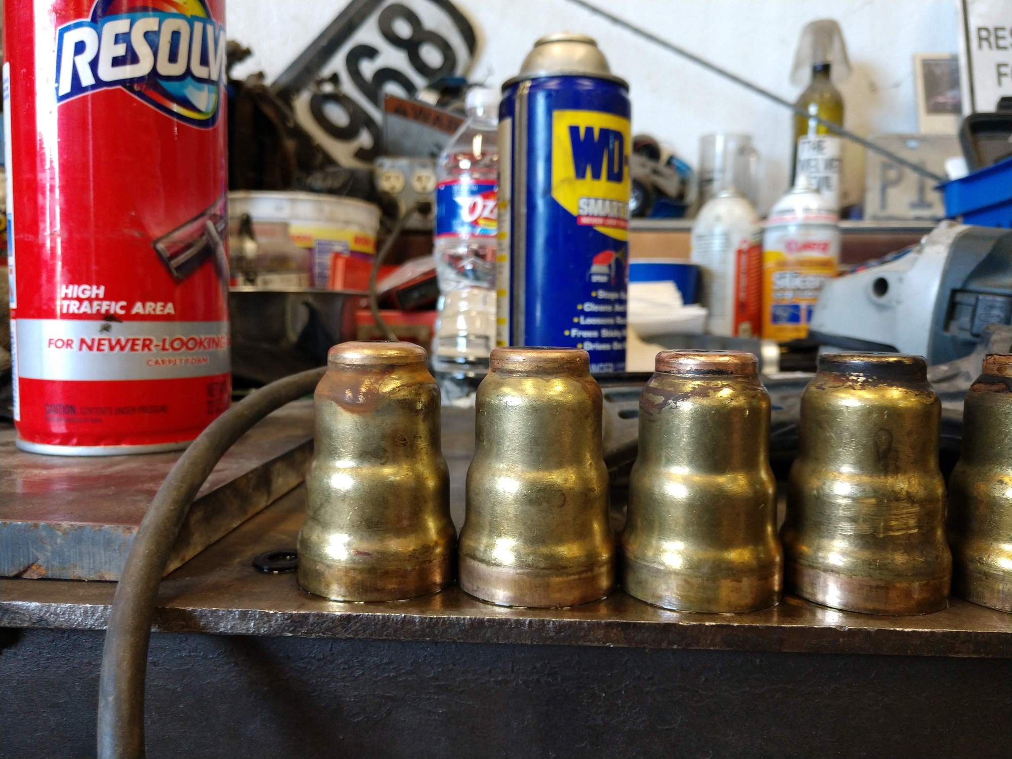

I replaced the cups today. I have some photos to share. Would be nice to get some more opinions as to what went wrong here so I can continue to learn from this guy's mistakes as much as possible.
All 8. Notice how #7 all the way to the left is bulging at the bottom of the cup. The 4th from the right is also bulging. When you look inside the cup, you can see where the copper washer was only sealing at the very outer edges of the washer because of the concave shape of the cup where the injector nozzle passes through.
Better angle on the rounded bottom of the cup. No good at all...
I am questioning whether there was ANY sealant applied to the very bottom of these cups. I found no evidence of any, and only a little at the tops of the cups.
Wow. I think the previous "mechanic" installed the old cups by sticking a dowel down each one and pounding it in.
