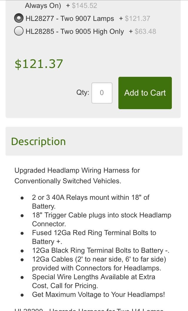

What is this relay harness?
https://www.ford-trucks.com/forums/1...y-upgrade.html

Originally Posted by AubieTN
Hey Skyski, I’m interested in those halogen Hella 80/100 watt bulbs and have the RiffRaff ‘05-‘07 OEM lights in my ‘02 F250. I can’t find them on Rally’s web site, haven’t called them though.
Do you have any part numbers for the kit and bulbs?
Thanks very much,
Larry
You can call www.rallylights.com for relay harness. They will hook you up - GREAT customer service!!!
https://www.rallylights.com/hl282-sm...d-systems.html
