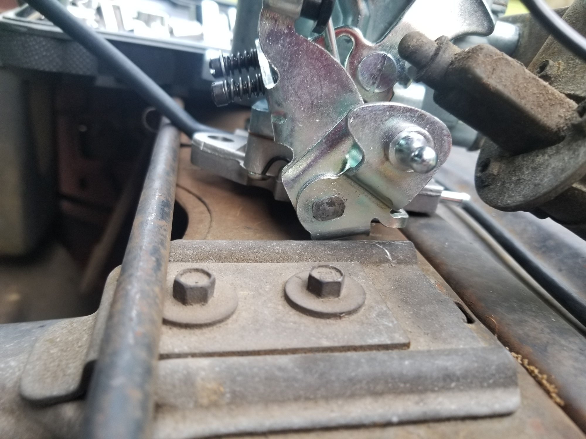

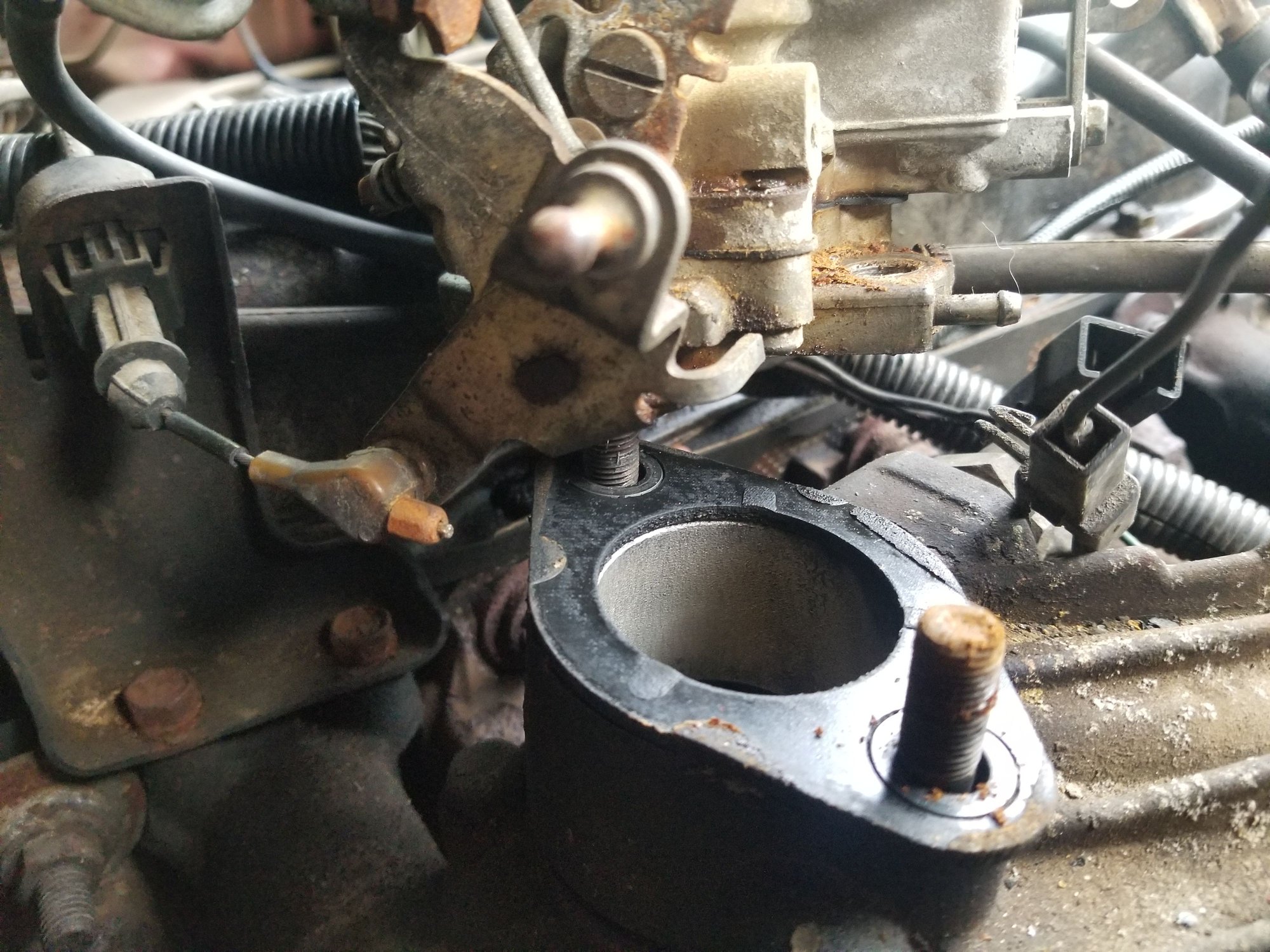

I dont know if that's the line you were referring to but the first picture is the only line I see right now running from the carb to the transmission. The second picture looks like it might pair up with that egr on the bottom of the carb I mentioned that looked like it had been cut out

welp ive hit a bit of a bump in the road. The old carb has a leg for the stock to linkage to hook to. The new one does not. Is it possible to transplant it?

The original carb is probably in lousy shape correct? They usually are when they sit around with old fuel in them. I was going to say you can continue on with your swap, use the old carb for now and then figure out what to do later.
But it would be nice to have a new carb on it also. I see two choices;
1. Carefully take a hacksaw and cut the bottom AOD linkage leg off and take it to someone and get them to weld it onto the new carb linkage or
2. Cross your fingers that possibly the bottom throttle body of the old carb would bolt on to the new carb. That would be something, but it might work. I say that would be something, parts off a carb made by the chinese bolting onto a carb made in America years ago. It may work, they say the small engines you buy at Harbor Freight are knock-offs of Honda engines, and Honda parts will bolt right on them.
There may be a 3rd choice. See the end of the shaft on the new carb where the linkage piece is held on? That is the end of the throttle shaft and it has been battered or "peened" over to hold it all in place. Your old carb is the same way. You could grind this off, and then wiggle the piece off, and do the same to the old carb and swap the pieces. But then you have to get it back on there. I would not peen it with a hammer back on there, I would think it would be too easy to damage the throttle shaft. Possibly you could get someone to spot weld it back into place. I don't know if JB weld would hold it or not.
