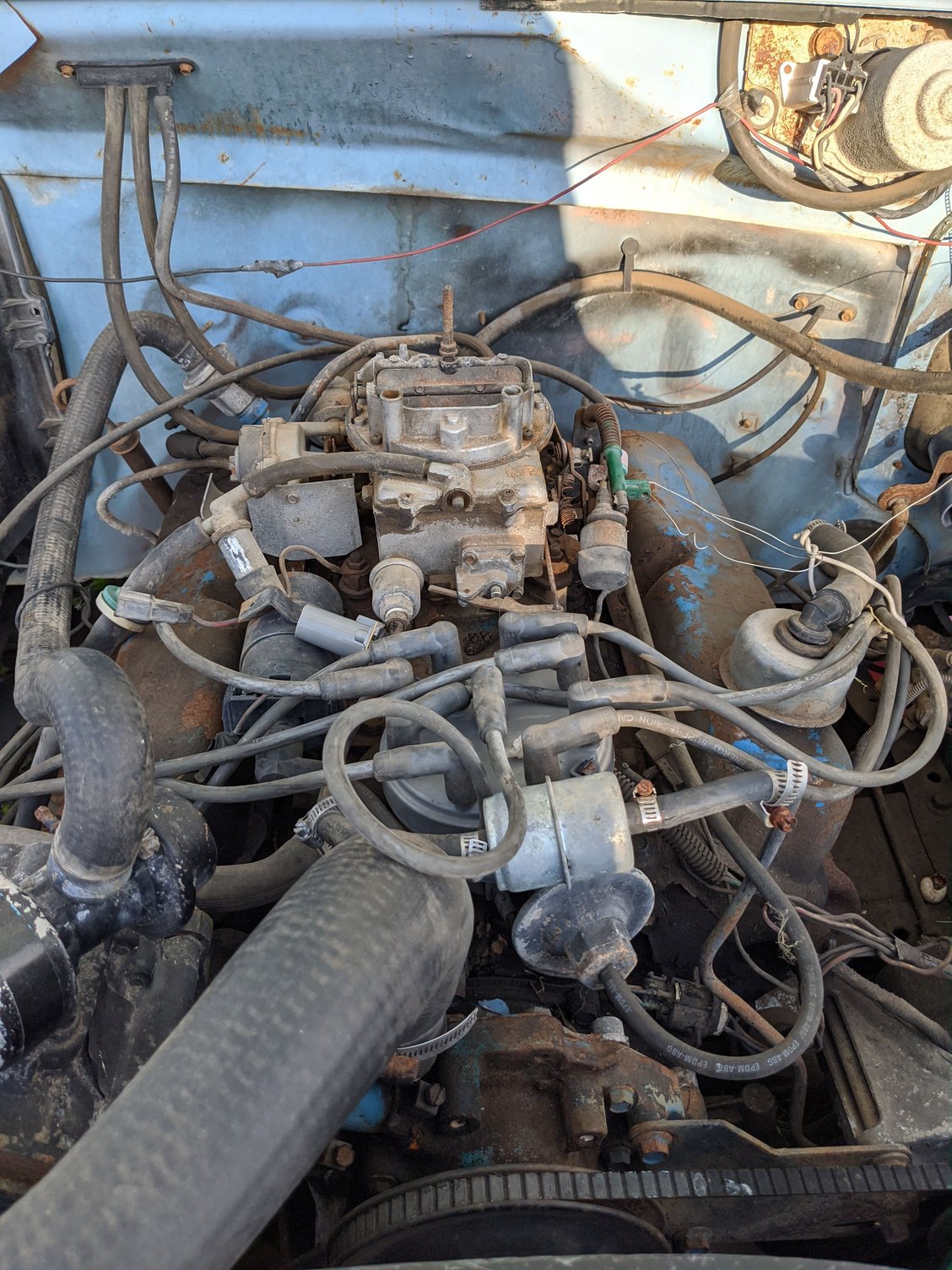

Alright guys I thank everyone who helped me with my alternator problem but now i have a new problem.......so the 1981 F150 with a 302 V8 carb and K transmission seems to be giving me more problems i hooked everything up and got it to crank once now i dont have a click, crank nor ANY POWER when i turn the ignition....i tried to youtube and see but no one has any videos on my truck and if they do its with the Bigger V8 or the straight 6...when i tried to crank it a second time the lights did work and the brake light flashed with no clicks from the solenoid or crank from the started the third time not no power at all i checked my battery it was fully charged i even changed out the starter solenoid with a new one i had for a spare ( i collect random items i find for dirt cheap to have spares), as well as the voltage regulator and ignition module...so now im at a loss of why i would have no power what so ever this is my second ford truck and im still kinda new at fixing things on my own but this would be a great help if anyone can lead me to a thread or youtube video of what to do. I have also attached high def pictures of what im working with at least i hope they are high def when uploaded. Thank everyone again for who reads and responds much appreciated.

Right off the hop the power feed from the Alt to the bat loose and needs a nut. And the battery to starter relay cable needs replaced. Do those and come back to us if it is not fixed.

What about the small red wire on the starter relay? Is that wire just floating there? It looks like a ring terminal just sitting loose near the wire bundle below. Am I seeing that correctly?

I can't see it either, but I do know there should be more on that terminal than the one large melted wire. There should be a smaller on there somewhere.

I can't see it either...
Maybe I'm just having another flashback to the sixties, I don't know. Here's what I noticed, circled in white:
Also, if you have these "emergency" battery terminals, do yourself a YUGE favor and get rid of them. Either replace the entire cable assembly or have some quality terminals crimped on:

That red wire a few have circled is connected to the factory wire harness so I can scratch that and I have put a new battery lead so idk what to do still no power and have put a nut on the wire from the alternator

What you are seeing is just joint for the fusible link. And he needs a whole new cable, not just the terminal end.
The other body feeds are on the starter relay it's just weird angle that makes it look like they are not. And the relay feed cable is not melted but it has been overheated and is end of life.
