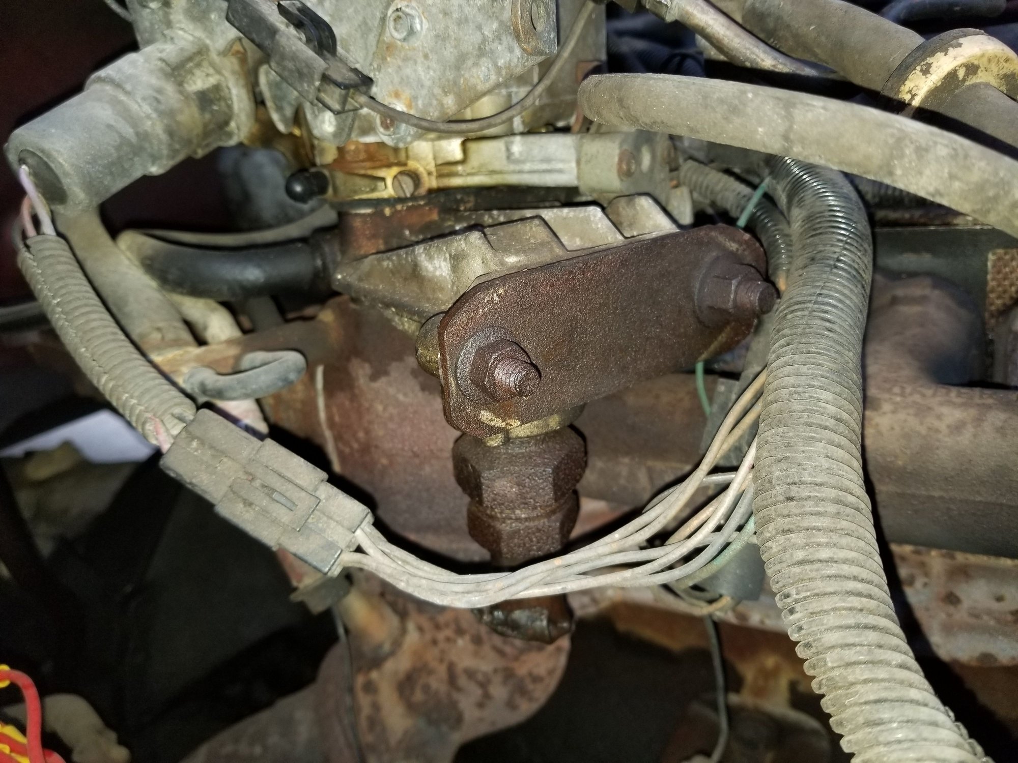

ok. I know nothing for the hvac system is in cause the blower motor and evaporator core are melted from an engine fire. And I may have to find another egr valve because I think its suppose to be under the carb but it's cut
Leave the EGR the way it is as it is not needed.
As for the HVAC vacuum hose just make sure the hose that went to the firewall vacuum tree is plugged off for now.
You say the truck has an automatic with over drive? If so then someone that knows that transmission better will have to step in on how it gets hooked up.
