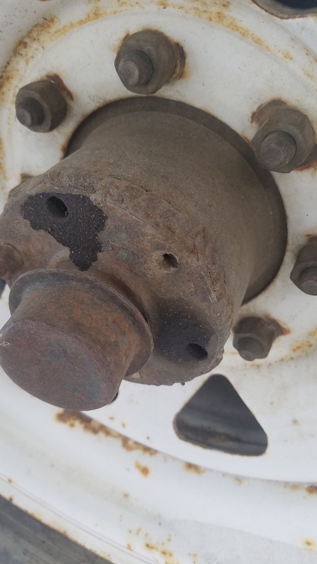

So ive got a 1976 ford f250, np203 transfer case. First picture is my passenger side of front hub, second picture is of my driver side front hub. The truck was like this when i bought it. Anyone have an inkling as to why someone would do this? What purpose? As well as what troubles might be getting into trying to carefully cut that off and put an actual hub on?

All the mounting bolts were stripped out. Couldn't find another hub at the time or ?????? Redneck fix.

Yes that's a clown repair. but if you have full time 4 wheel drive you wouldn't have had locking hubs anyway.
You're just going to have grind or cut the weld off and put a new hub assembly on. if you like the looks of the locking hubs you can put a set on or just put the original hardware back in and caps back on .

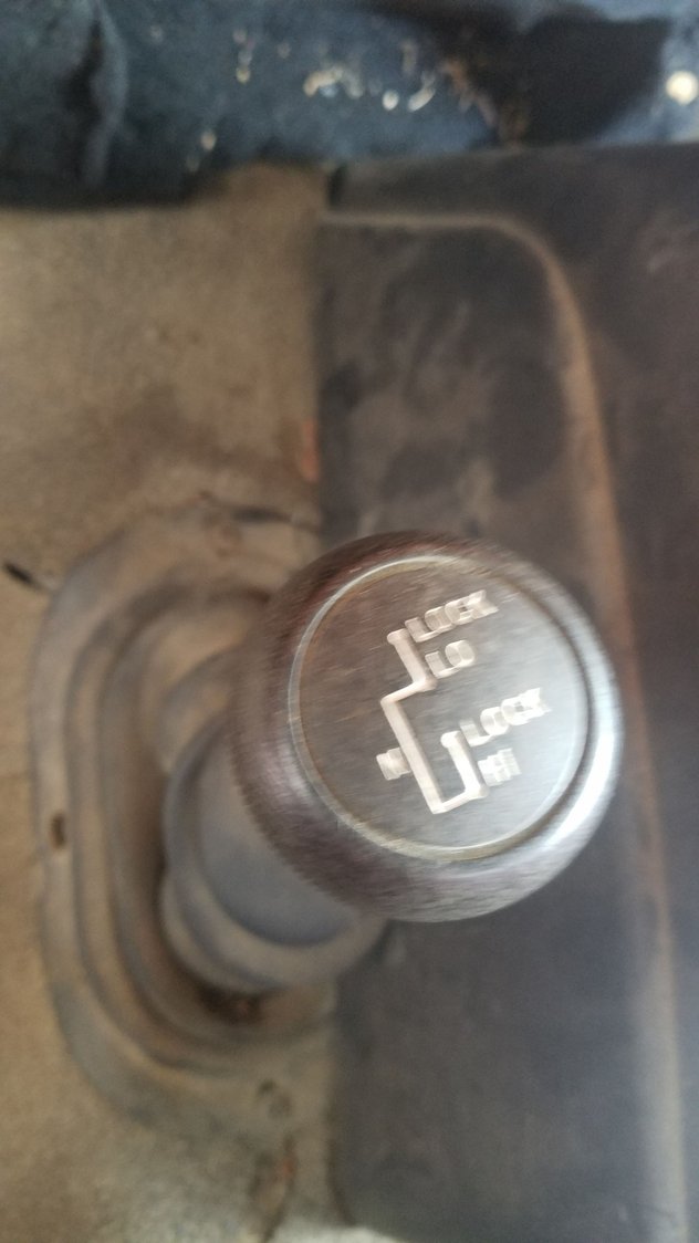

Yeah, ive been occassionally mildly confused by the hub on the passenger side with the NP203 transfer case. If i fixed the previous "repair" with a locking hub, the hub would have no purpose correct? I can double check the tag on tcase tomorrow. Have a picture of the trans shifter that i thought also indicates NP203 all time 4wd setup.
Did these trucks that came with the all time 4wd tcase come with locking hubs originally or were they capped?

there is no 2 high option so I'd assume it's full time. but I wouldn't rely on a **** to identify the transfer case.
Yes, full time equipped rigs just came with a cap in place of a lockout hub.

The drive flanges were on my 75 when I bought it. First thing I did when I bought it was pulled the 203 and the drive flanges and replaced them with a 205 and manual hubs like the one you pictured. You can run the manual hubs with your setup and unlock them so the front wheels freewheel then lock them in low traction situations. Having the front axle unlocked will save you a little gas as well as wear and tear on front axle when all wheel drive is not needed. The end of the wheel hub is a machined surface so, if you are going to cut the welded flange off, you may want to have a machine shop do it and make sure the outer sealing surface is flat. If the threads in the end of the wheel hubs are stripped Heli coils can be installed or, if you can find a used one in good shape, replace the hub. You can run it like it is but, man does that look like some redneck engineering.

You cant get that hub off with out grinding or cutting that weld as that cap assy. has to come off to get to the spindle nut and bearings.
Then my next question is the outer axle end different between locking & non-locking assy.?

No, they're all the same .
