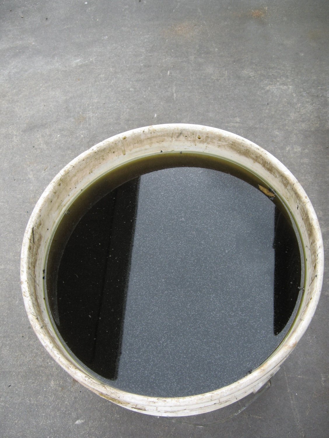

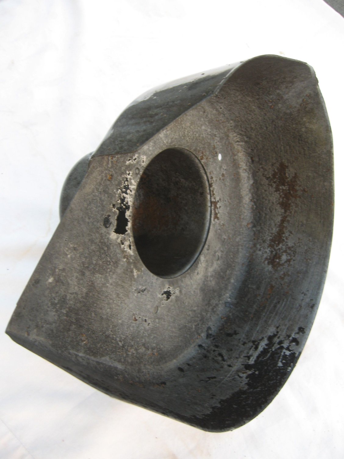

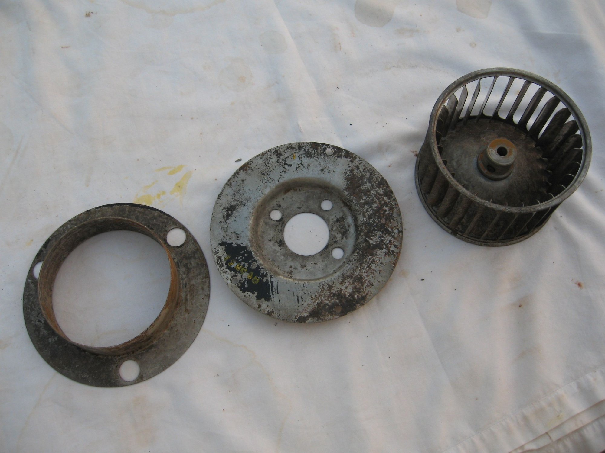

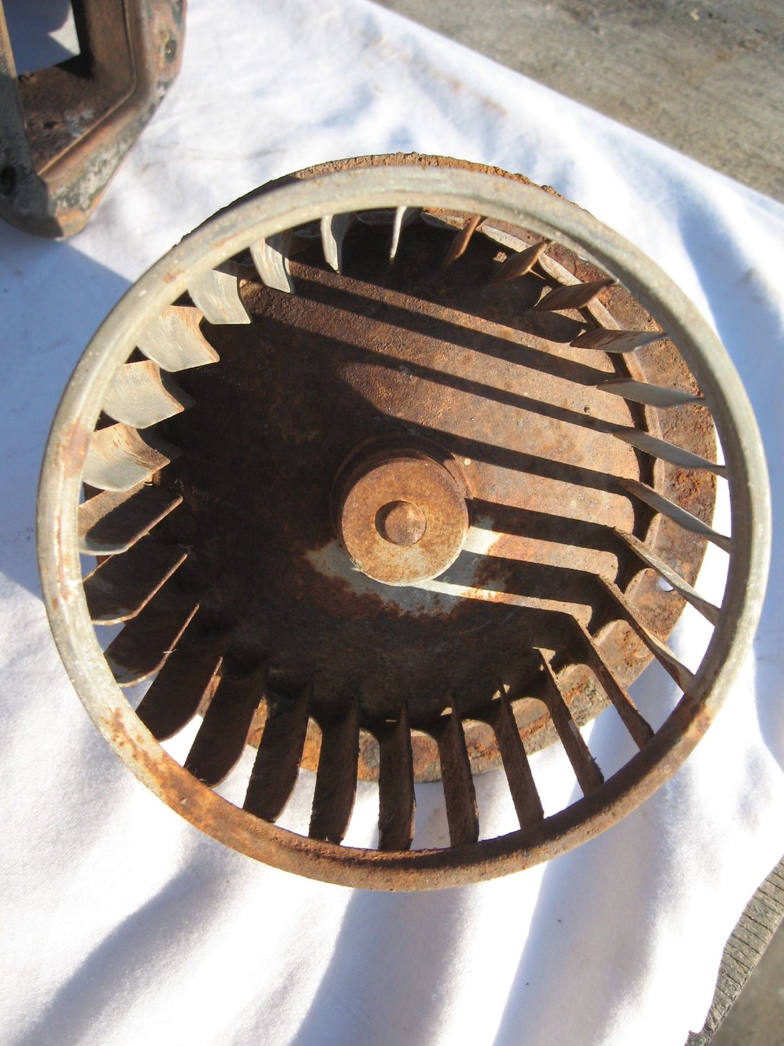

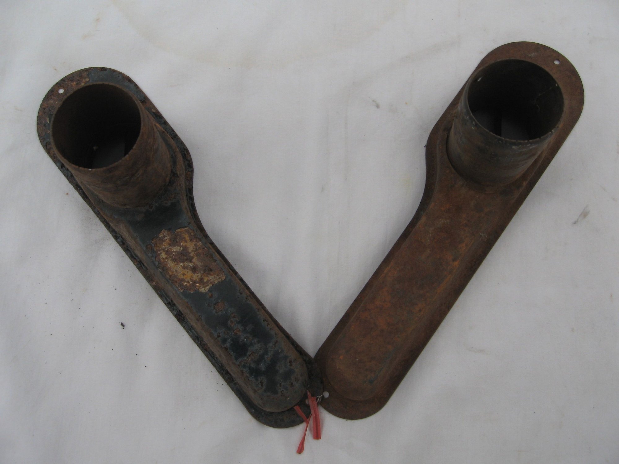

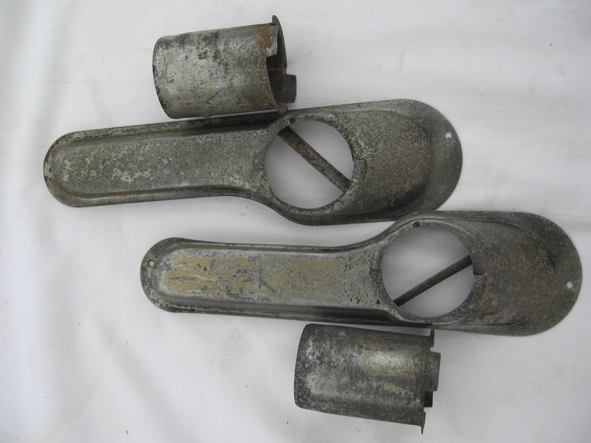

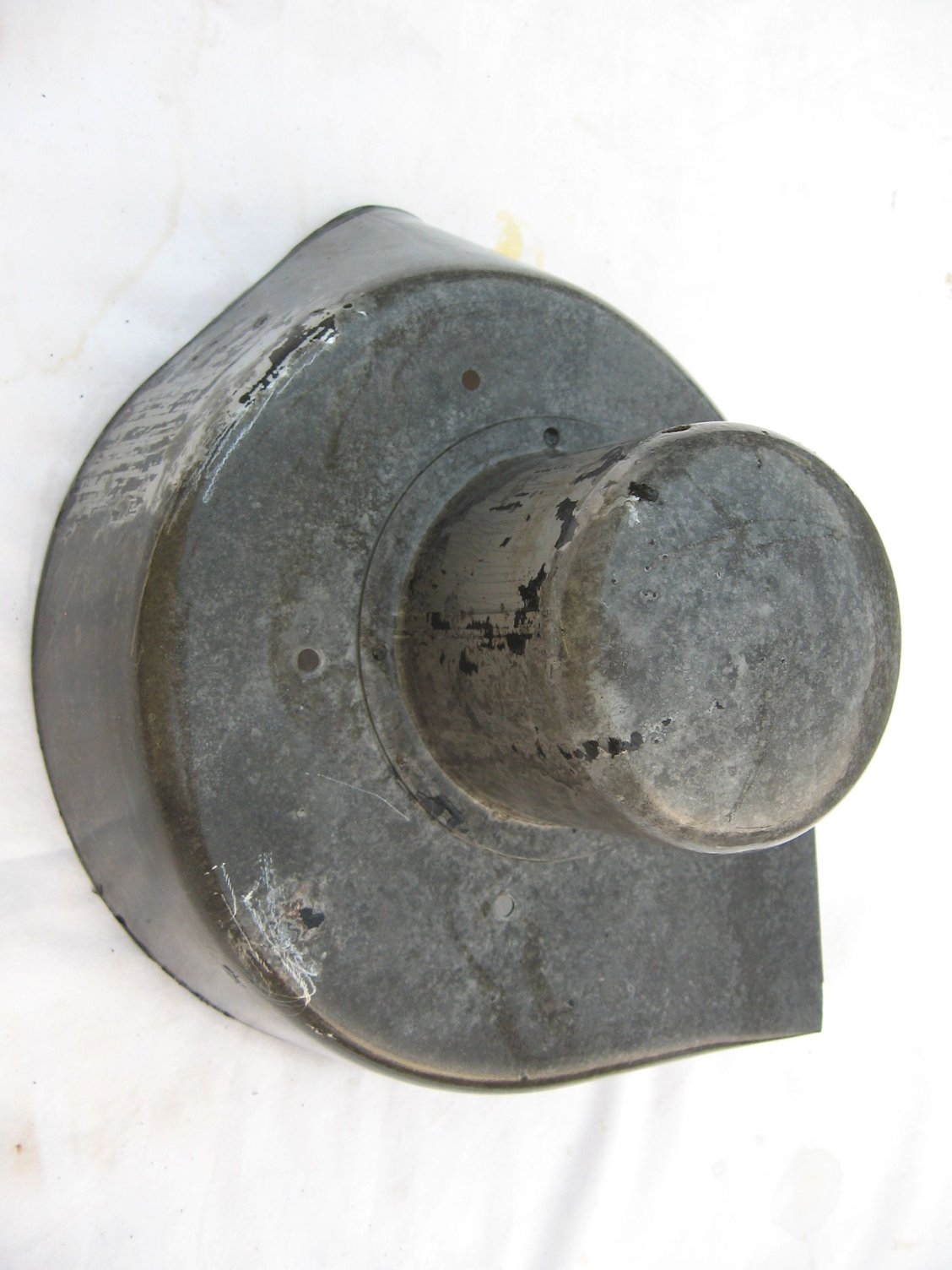

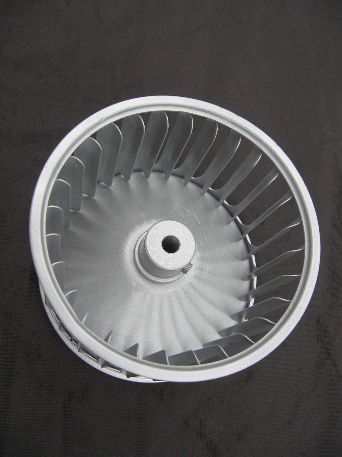

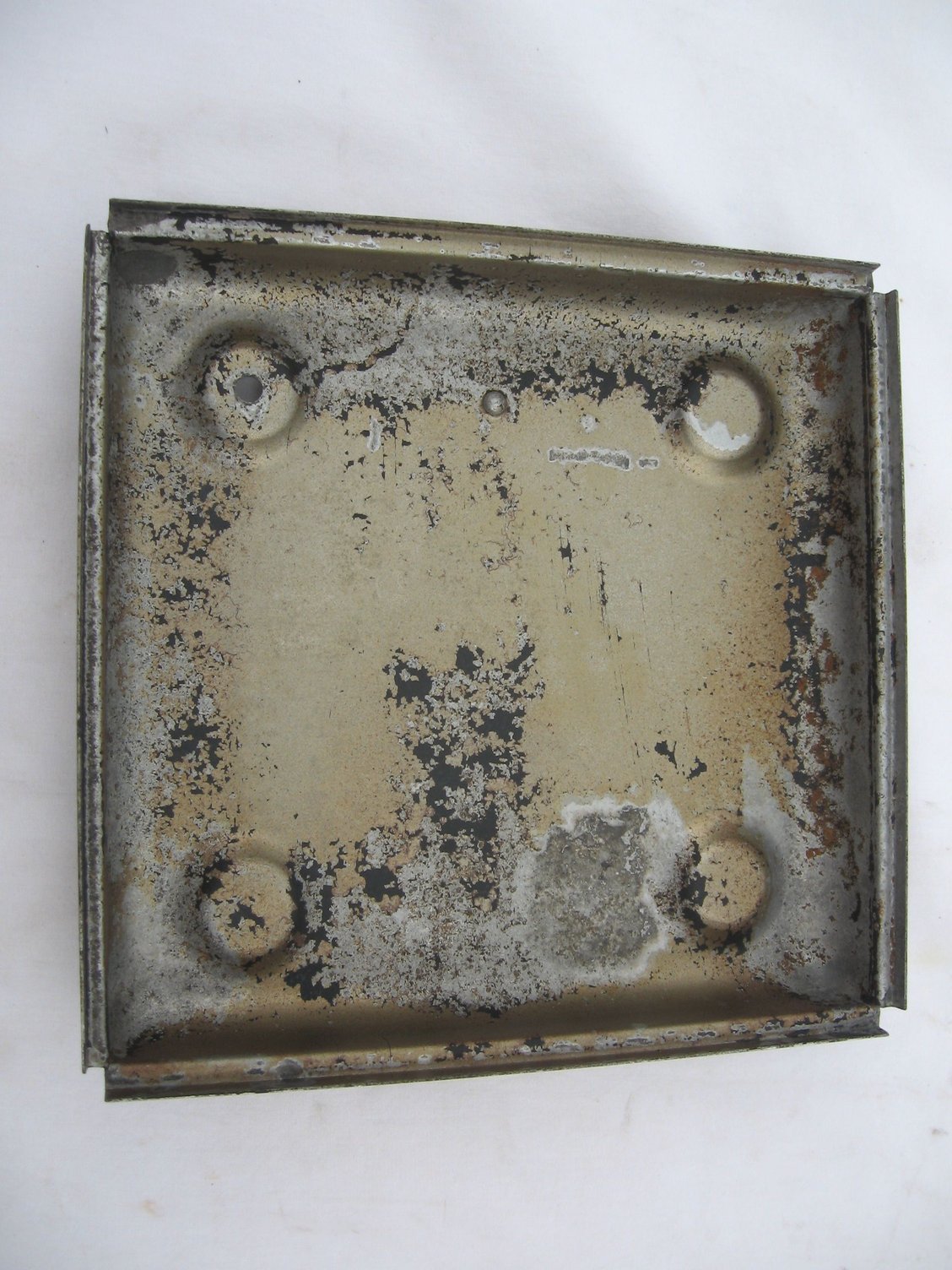

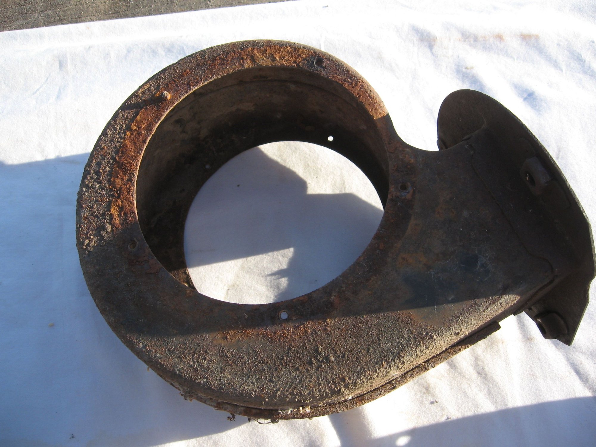

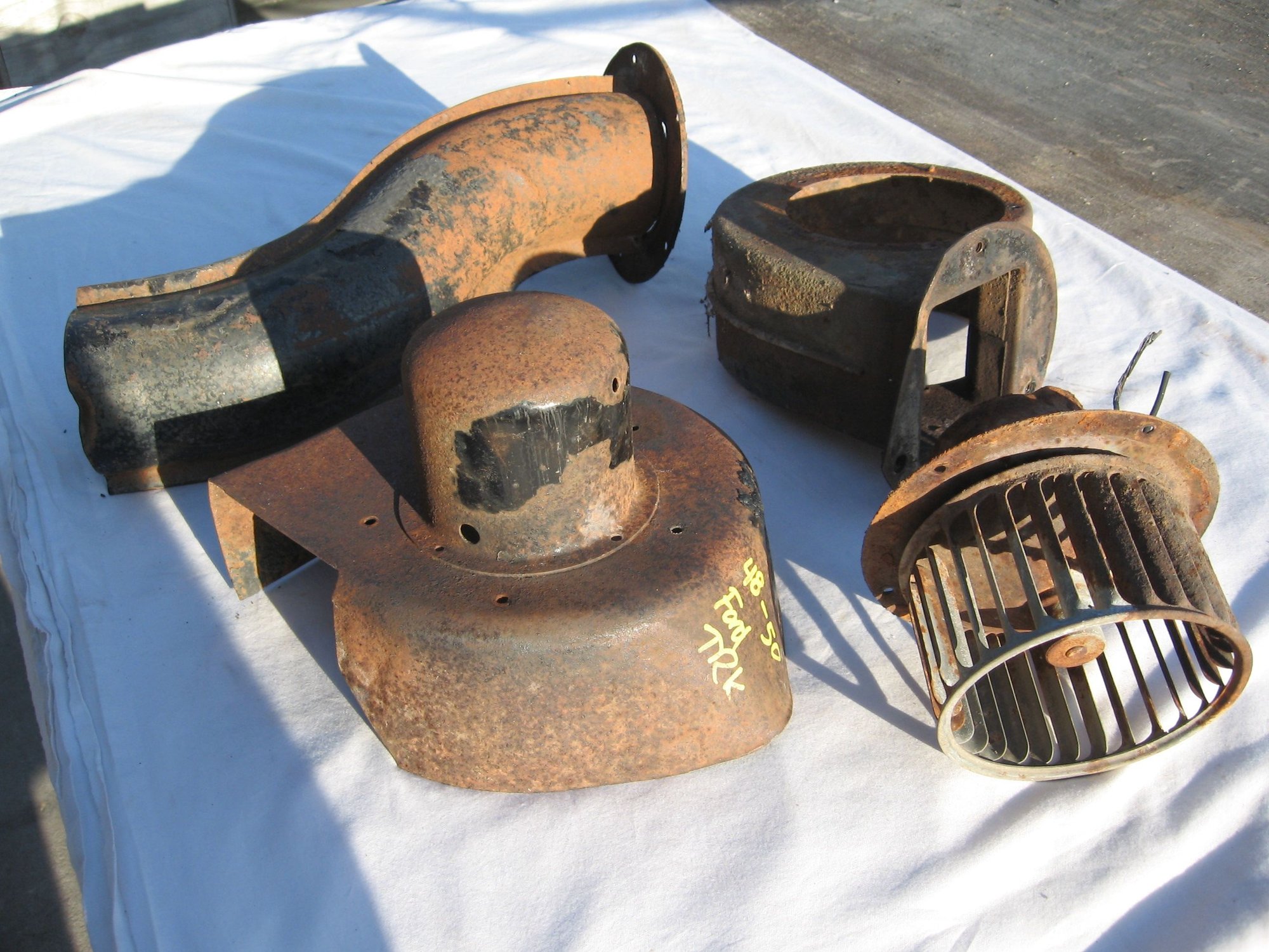

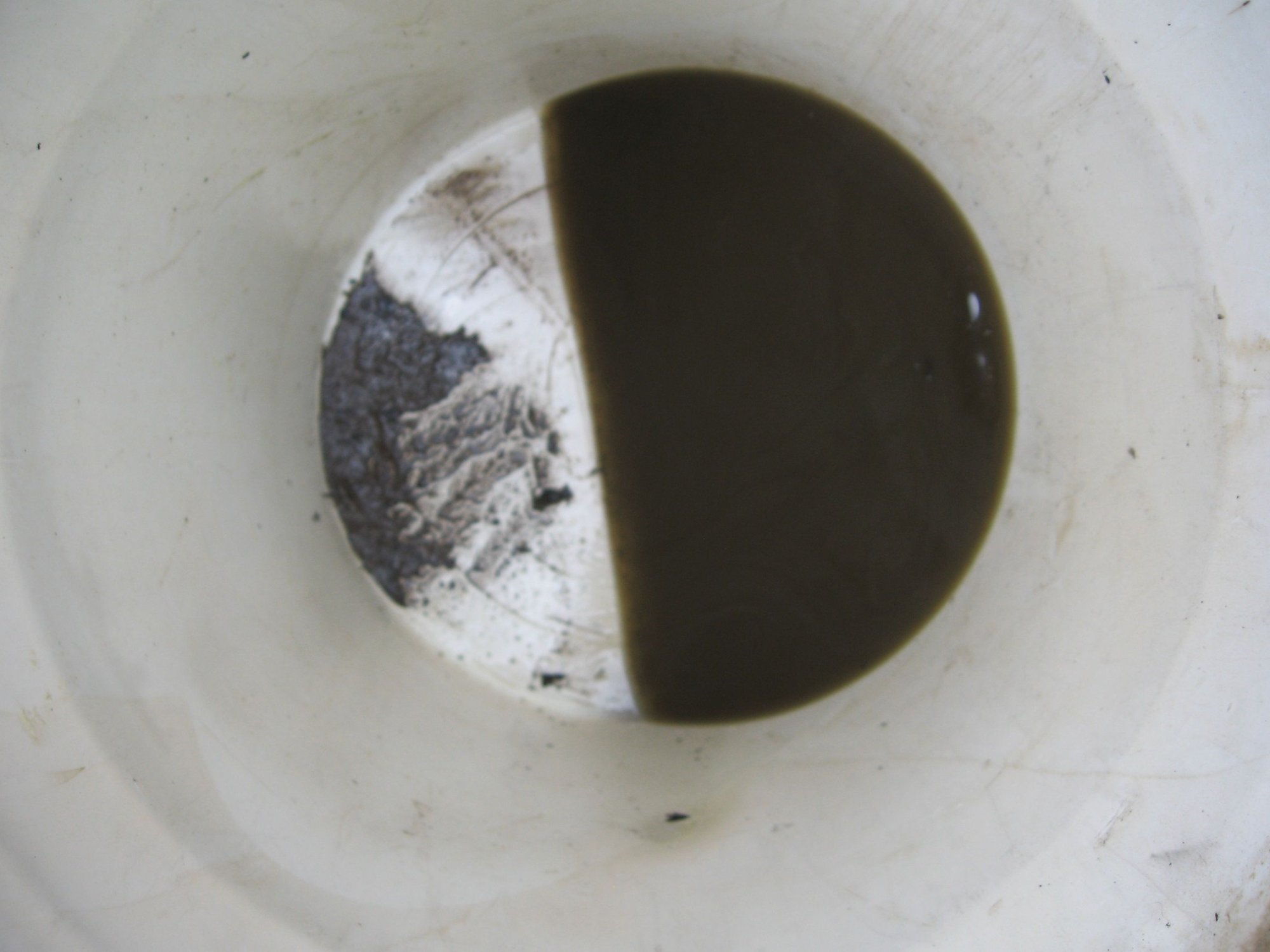

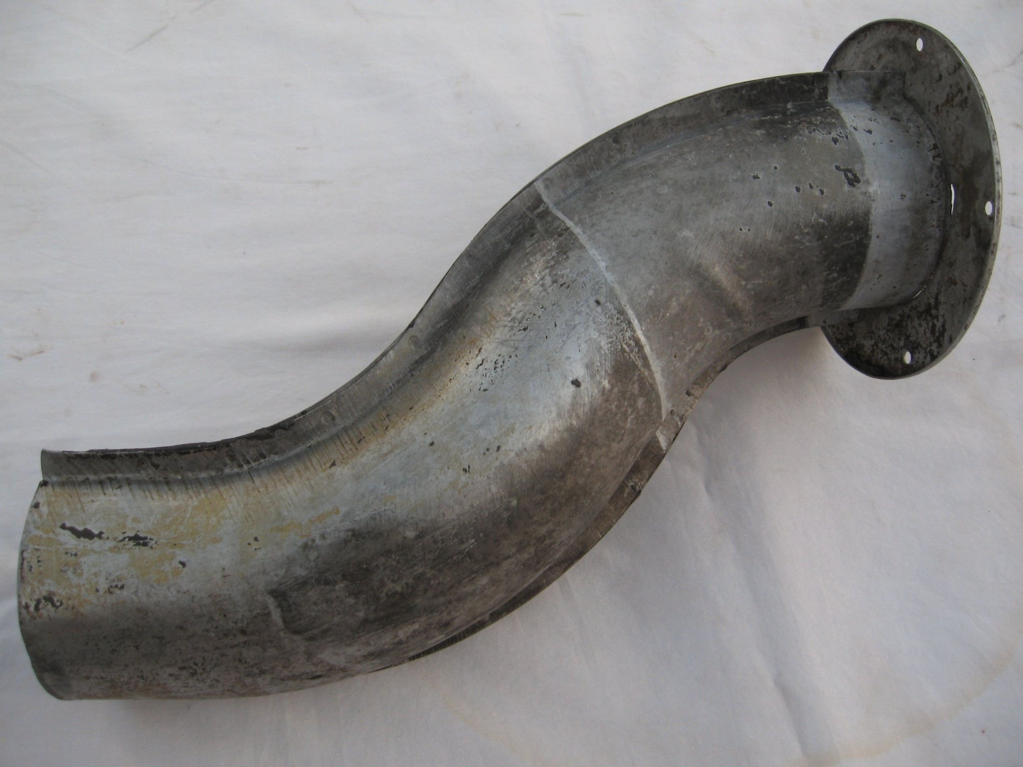

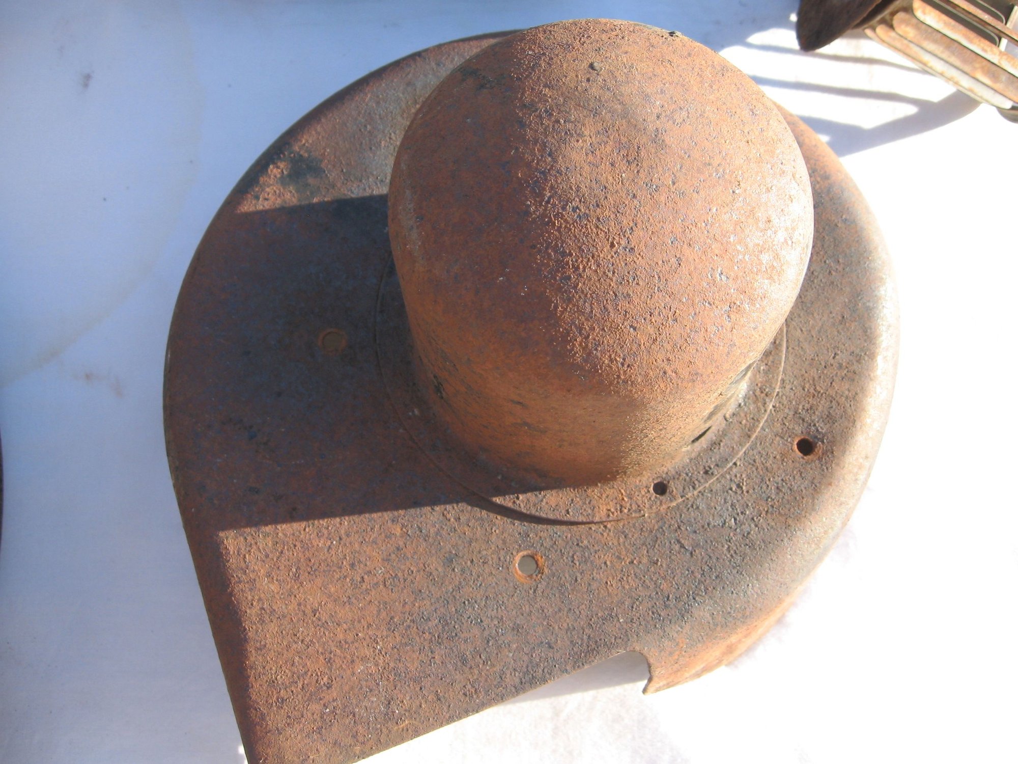

Tried this rust removing solution .
Came in a foil package .Why pay to ship water ? Mix it w/ water in a 5 gal . pail . Insert rusty item & leave over night . Works fine . Some before & after pics . 70 yr. old parts & the fan set screw removed w/ out any assistance of heat or pressure . Same w/ the fan of the shaft / Amazing !
. Came from dry S.D. Received a '52 fresh air tube elbow & mid tube from the same salvage yard today in excellent condition . .
Is this the Rust Release product ? When I check their web site I can not see a powder type product, just liquid and paste. Do you have the part number or model type ? Thanks.
Old Apr 9, 2020 | 12:43 PM
firstrider's Avatar
firstrider
Joined: Aug 2007
Posts: 3,773
Likes: 169
From: Pt.St.Lucie , Fla.
Industrial Rust Eliminator Concentrate 5 gal . Comes in resealable foil packet . 1 cup / gal of H2O . alaso-chem seller on upay . I left the items in over night , remove in morning rinse of & blow dry . Sure is going to cut down on the media blast time .

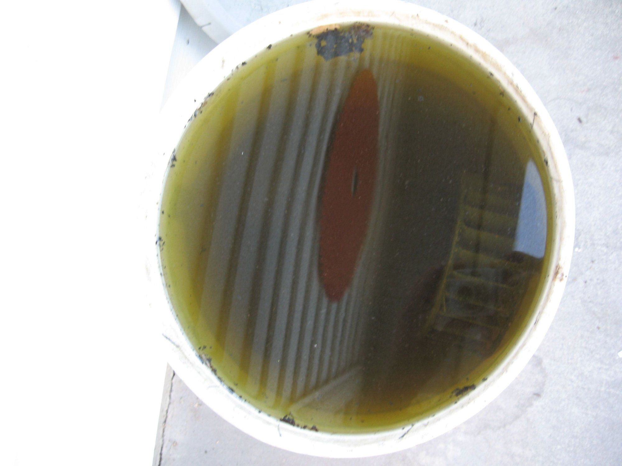

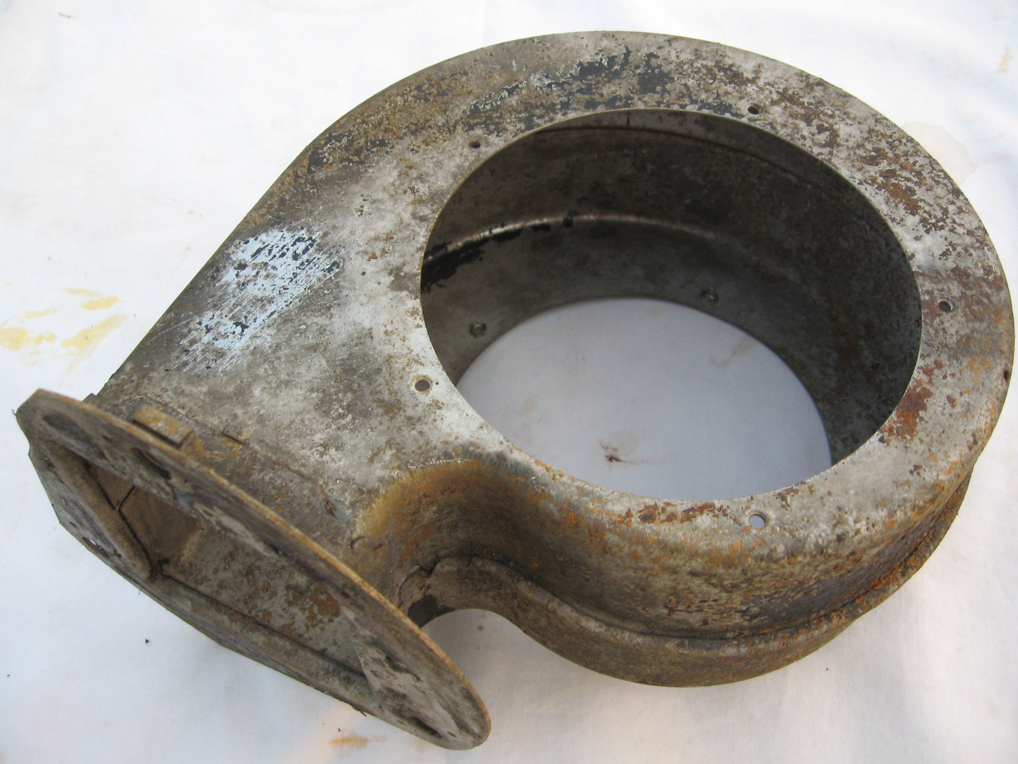

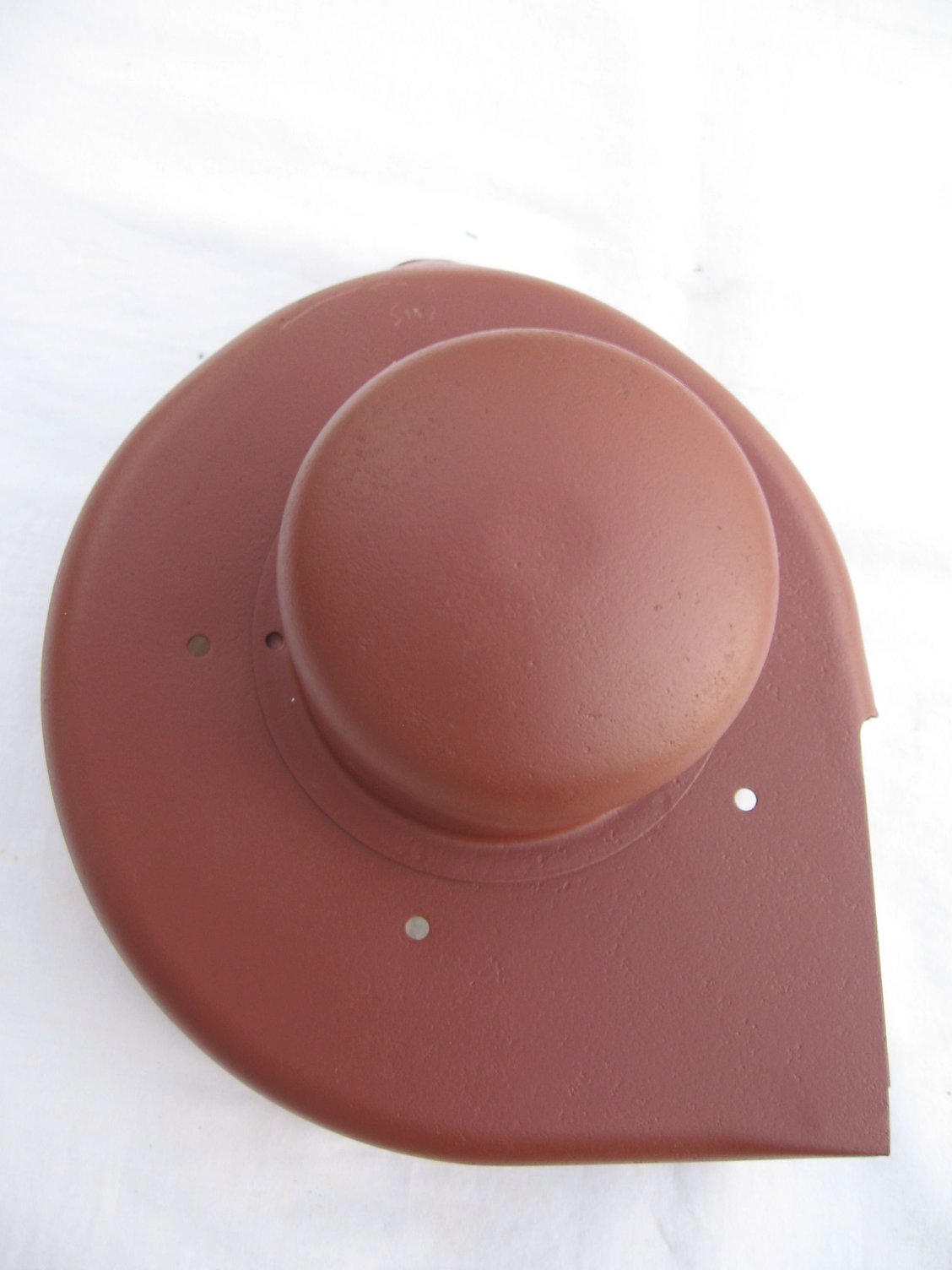

Pic of mid tube in post #7 after a 24 hr . soak . Blower motor housing in primer .

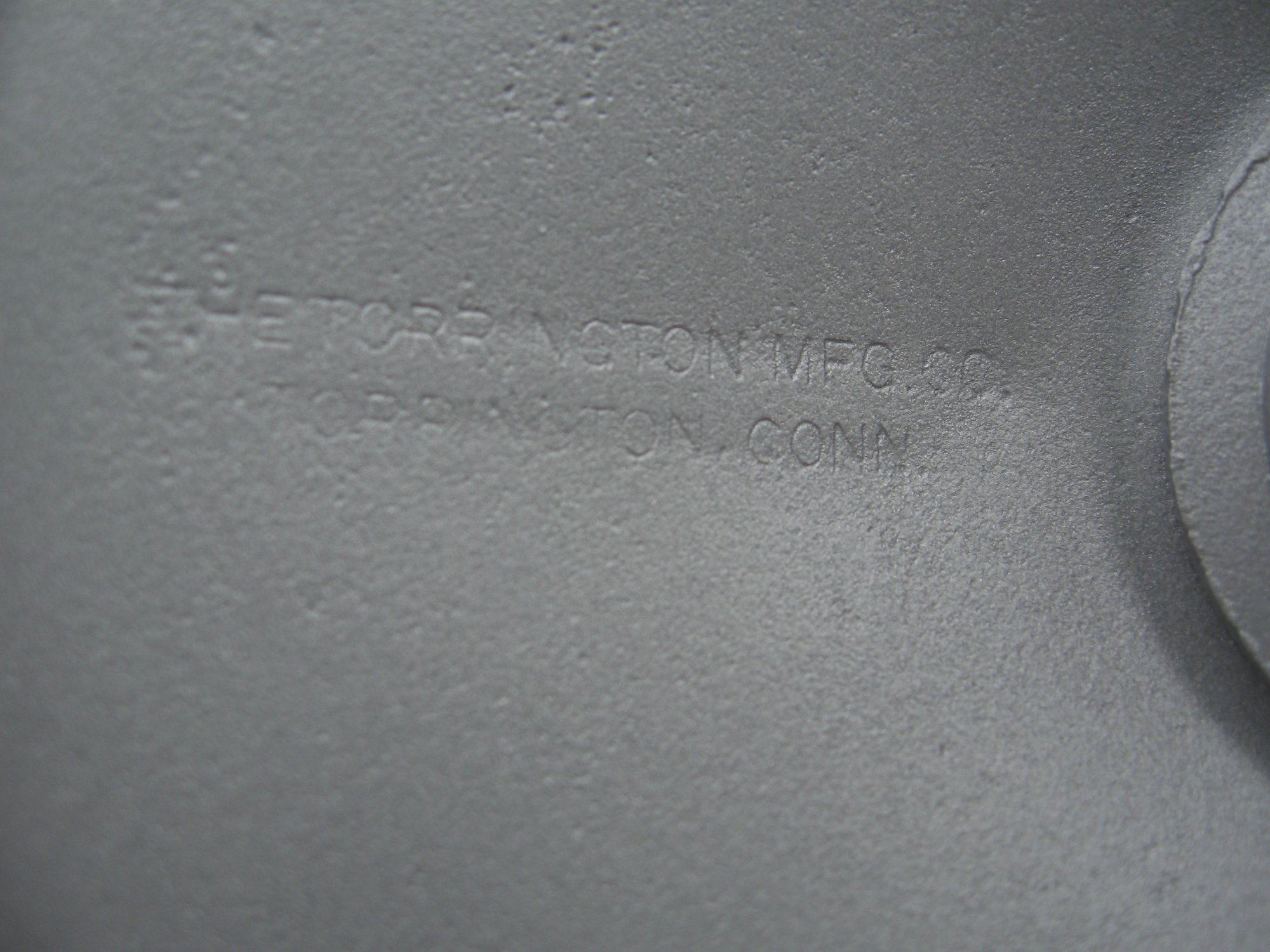

Am liking the rust remover more & more every day .Found that the fans for the Magic Air & FORD script fresh air heaters were made by The Torrington Mfg. Co. , Torrington , Conn.
