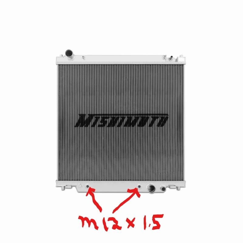

On the Mishimoto Radiator that I bought, those threads are M12x1.5

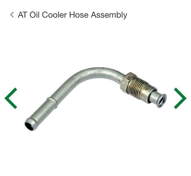

It’s a transmission cooler specific fitting. A modified compression fitting. You should be able to buy it at the autoparts with steel line attached.
Although If sucks to go out in this climate, it’s good the new one is still loose. They should let you carry the fittings outside to check fit.
Like this. (Not sure if THIS is the right one, but it’ll look similar)
https://www.oreillyauto.com/detail/b...624224/4252153
