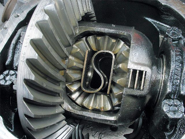

Chances are that truck has on open diff but if you want to know for sure pull the diff cover off and have a look. If it's never been off then the oil needs to be changed anyway, and if you find something that looks like this you have a factory Ford LS diff.
