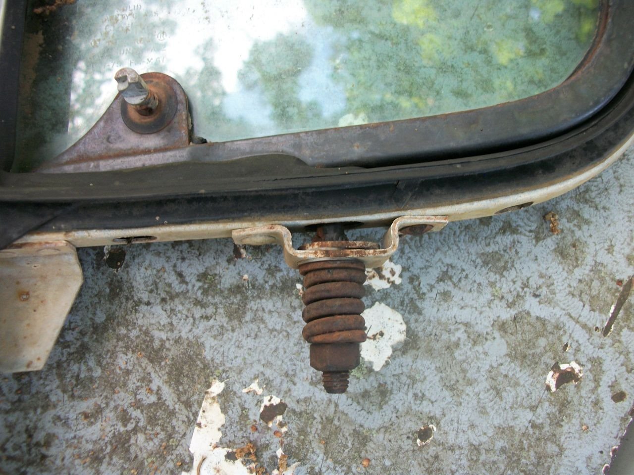

All is good just loose enough so that it won’t stay open when I get up to speed, annoying. I was wondering if I could take the panel off and reach up in there somehow and tighten the nut.

Yeah that’s it. Wondering if there’s a way to get to it and not having to take the whole assembly out. Speaker hole maybe ? Just wondering if anyone reading this has tried. Thanks for the response.

Take the door panel off and reach up in there, easy enough to get to. Careful though you DO NOT want to break that threaded stud for sure. I would apply a bit of WD first.
I happen to have a truck in the shop without door panels on it. Let me do double check that you can reach that nut.

Easy peasy to reach. Plenty of room for some WD (with the red tip) and than a 1/4 " ratchet.

Got it and good to go ! Thanks for the advice.
