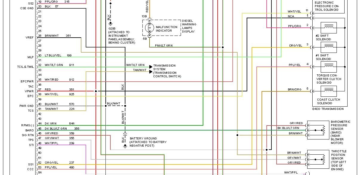

here is what I have for a 1994 E350 IDI
see if that helps to clear things up........ fuse links and fuses are named different... but the Troubleshoot guide remains same

Joined: Dec 2010
Posts: 62
Awesome thanks. Where did you get that? I might have to visit the site in order to read the words . When I zoom in they are pixelated
That is from me Personally... let me see IF I can generate a Higher res version....give me couple minutes

OK I tried 600X600 DPI and still pixelated....
you can stitch these Images together they are all same scale....

you can stitch em all in MS Paint... I just didn't bother

Perfect thanks!

you're quite welcome ... that may solve some of the Mysteries ... I know the Van wiring is a bit different

Just want to update. It’s fixed! Starts great with all the new glow plugs. The problem was with the ignition, it wasn’t giving power to relay. I also get to return that $130 relay I bought. Thanks for the help
